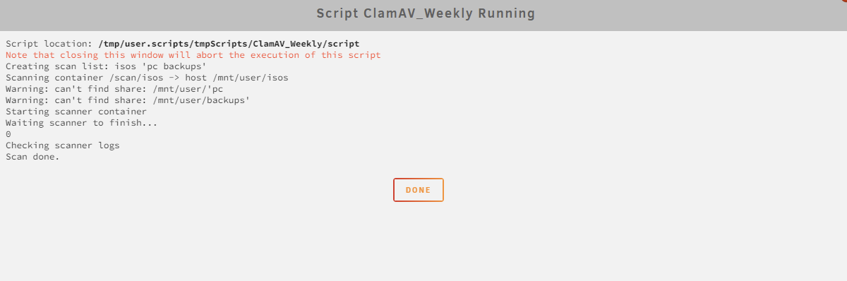

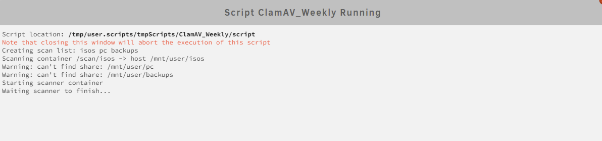

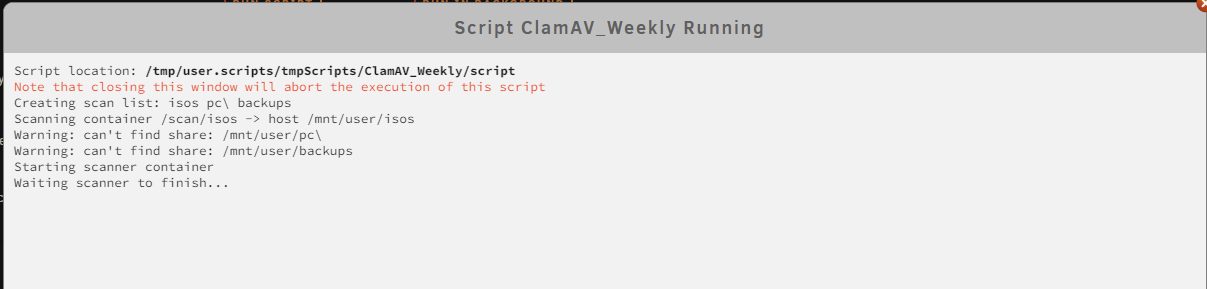

On 4/17/2022 at 1:54 AM, Masterwishx said:
updated Helediron scan script for use with the shares that have space between ...
i tried to put 'pc backups' ,pc\ backups or pc backups in FOLDERSWEEKLY, None of them work.
any ideas how to put folder name with space correctly to get script to work?
Yes, use my updated script to use spaces in Shares Folders.

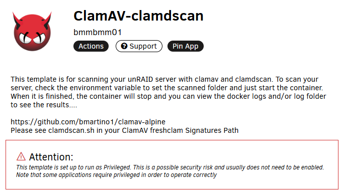

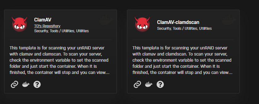

Is the "official" tagged version of ClamAV disfunctional compared to TQ's repo version? I installed the "Offical" one.. but it seems useless compared to what I've seen in this thread.
Unfortunately, I'm not sure.
I know this one works using the template in CA.
So neither of 'em have a webUI. What is to happen if it comes across an infected file?
That's really for you to decide.
ClamAV has never had a webUI afaik.
Take a look at all my documentation (from the first post) and you'll find the answers to your questions.

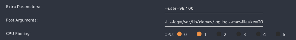

If I add "--max-filesize=200M --max-scansize=500M" to Post Arguments, my log is empty and I am unsure if it has done anything.
If I add a -i, it fails with this in the log:
clamd: illegal option -- i
ERROR: Unknown option passed
ERROR: Can't parse command line options
These options also fail:
-f /scan/appdata/clamav/clamavtargets.txt
clamd: illegal option -- f
--file-list=/scan/appdata/clamav/clamavtargets.txt
clamd: unrecognized option `--file-list=/scan/appdata/clamav/clamavtargets.txt'
I have to be missing something because there aren't other posts about this. What's going on?
