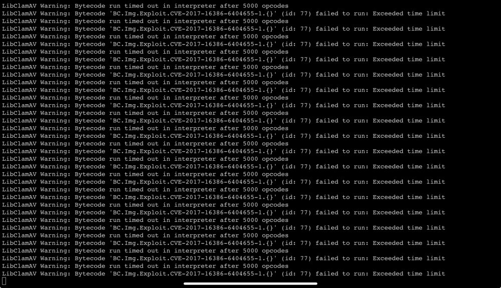

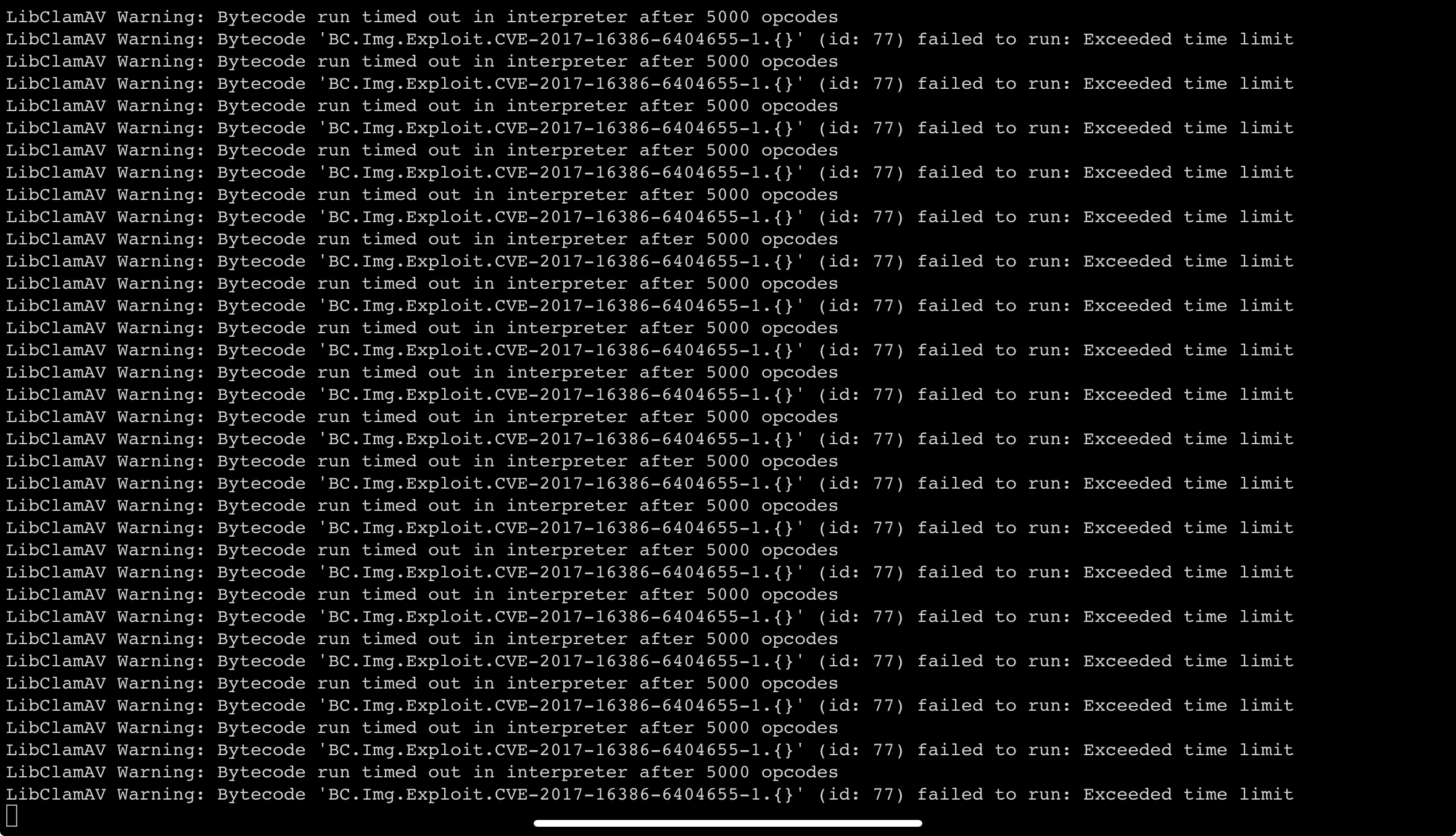

What does these warn and error messages mean?
  1. LibClamAV Warning: Bytecode run timed out in interpreter after 205000 opcodes
    LibClamAV Warning: Bytecode 'BC.Pdf.Exploit.CVE_2017_2818-6399052-0.{}' (id: 76) failed to run: Exceeded time limit
and
  1. LibClamAV Error: cli_html_normalise: style chunk size underflow
Googled these for ya.
This indicates that ClamAV was running a bytecode signature and that it exceeded a time limit. Normally safe to ignore...
cli_html_normalize: style chunk size underflow
You can ignore the error message. It is a part of a safety bounds check that was added in a new feature in ClamAV 1.1.0. We did not expect that error message to occur within a normal file. The file causing the error message would be visible in the logs right after this message.

Any help for a newbie who ran this morning and get this, just installed and started with defaults ?
