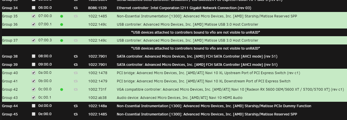

I ended up getting a new board. Aorus x570 Master and almost everything passed fine. Bluetooth wont connect to my keyboard still. and
2020-04-20T22:17:49.302385Z qemu-system-x86_64: vfio: Cannot reset device 0000:0d:00.4, depends on group 45 which is not owned.
IOMMU group 45:[1022:1485] 0d:00.0 Non-Essential Instrumentation [1300]: Advanced Micro Devices, Inc. [AMD] Starship/Matisse Reserved SPP
 append pcie_no_flr=1022:1487,1022:1485 video=efifb:off vfio -pci .ids=10de:1b06,10de:10ef,144d:a808,1022:1485,1022:149c,1022:149c,8086:2723,8086:1539
am i doing this right?

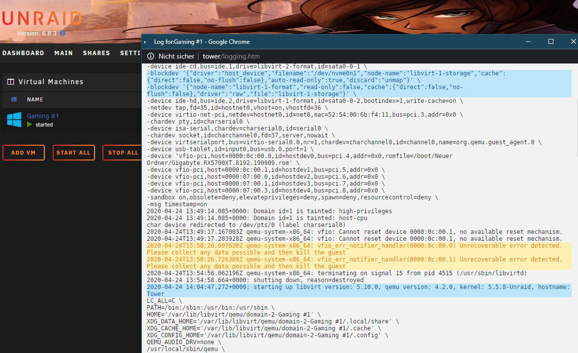

Hello, i have a Problem with my 5700xt and i need some help with it.
I have Unraid 6.8.3 with the kernel from this topic runnig on a x570 Aorus Elite with a 3600 processor.
For me ist seems that the reset from GPU works but not from Audio part. In vfio i can see that only the Audio Device is not resetable. The Log of the VM gives in my opinion the same answer.
The VM Crashs when a programm tries to use a audio device
If i change the GPU to my old 7870 everything works without Problems.
I hope someone have a idea what i can do to solve this Problem.
Edited by alejanson

2020-05-29T00:18:08.955204Z qemu-system-x86_64: vfio: Cannot reset device 0000:4b:00.1, no available reset mechanism.
2020-05-29T00:18:08.987175Z qemu-system-x86_64: vfio: Cannot reset device 0000:4b:00.1, no available reset mechanism.
Am I missing a step? Has anyone successfully tested the reset functionality on Navi?

Added `append pcie_no_flr=1022:149c,1022:1487,1022:1485` and used vfio-append to those same ones.
Thanks again!
