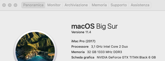

See the differences:
Emulated Penryn cpu
xml
This results in:
Note "Intel Core 2 Duo"
cpu host passthrough

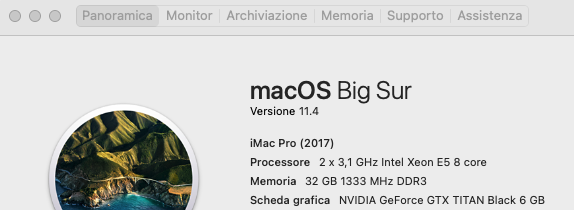

This results in:
Note "Intel Xeon E5 8 core"
N.B.: when I use the host-passthrough I define topology with -smp custom qemu args instead of libvirt, it's the same, it doesn't change anything.
So, if you don't read "Intel Core 2 Duo" your configuration is wrong.

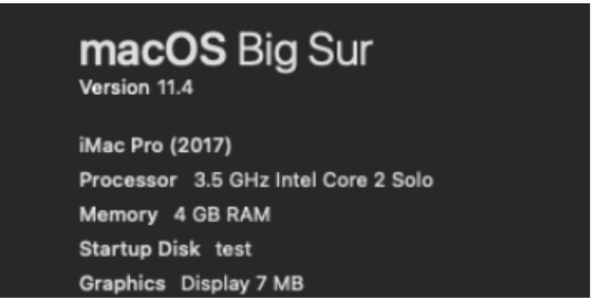

So it looks like the CPU emulation is working but MacOS sees it as a Core 2 solo and the patch is needed in my situation, is that correct? Is there any harm or reason not to include that patch in the config.plist for everyone?
Here I'm not sure, because if the cpu is seen as penryn, the patch shouldn't be needed.

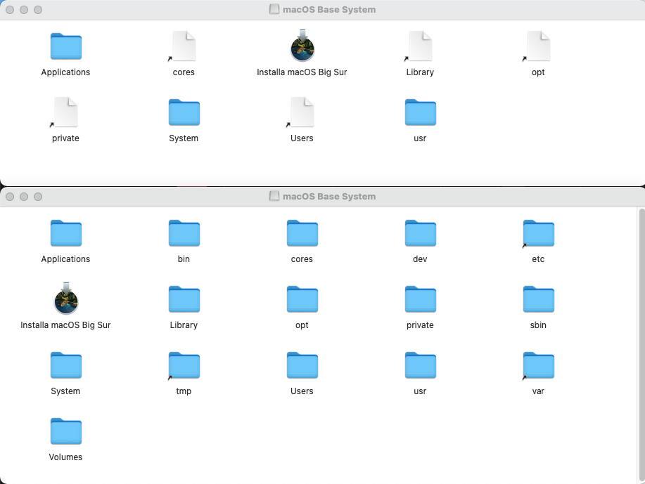

I downloaded both BaseSystem.dmg following the code and....look at this picture:
The top one is the mounted BaseSystem.dmg downloaded with fetch-macos2.py, the bottom one is BaseSystem.dmg downloaded with fetch-macos.py
They are not the same!
The one downloaded with fetch-macos.py seems "more complete" (??)
Maybe this is the root of the issues (?)
I would choose fetch-macos.py, or in other words method 2, to have the "complete" BaseSystem.dmg (or may be the other method? Check and report :D )
Would be interesting to have feedbacks from users who have issues, if they used method 1 or method 2.
