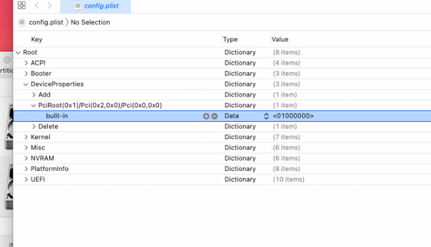

25 minutes ago, Kodiak51103 said:
What app do i open the config.plist in?
Textedit, any text editor.
Opencore configurator can mess your config.plist if the version doesn't match the version of opencore.
Better to do things manually.
cat2devnull is using xcode builtin plist editor
Remember: do not play too much with the smbios data (serial number, uuid, etc) while you are online, otherwise apple can lock your apple id (that happened to me :P ) and you will need to call apple to unlock it.
And also remember to change all the smbios data with fresh ones: take into account that all the people downloading macinabox have the same serial number and smbios data!

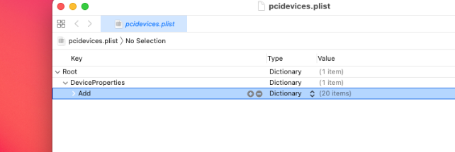

Actually I’m using ProperTree. :)

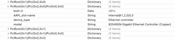

Clearly i'm a idiot Nothing is showing up in xcode?
Actually there are 20 items in that plist file as you can see in the "value" column. You just need to click on the "> Add" to get it to expand.
But I am not sure why you are editing the pcidevices.plist file. You need to add the built-in settings to your config.plist in your EFI disk/partition. If you look at my earlier post, you can see I am editing /Volumes/EFI/EFI/OC/config.plist
Also I noticed that you are still using the VMX ethernet driver. This should have been updated to be the intel e1000 driver when you ran the Macinabox helper script. I believe that you need to be using the intel virtual NIC to avoid issues with iServices.
You can check your virtual machines XML configuration in Unraid and make sure the NIC model is set to e1000-82545em as per my example below.
You may also just be able to run the the helper script again to fix it. Just make sure you updated the FIRSTINSTALL variable to "no".
Spacinvader One talks about this here; https://www.youtube.com/watch?v=7OunFLG84Qs&t=840s

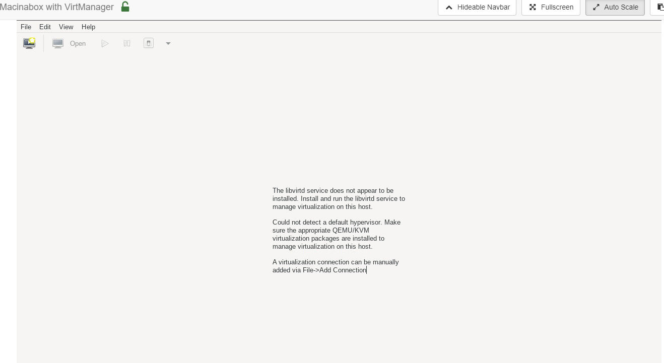

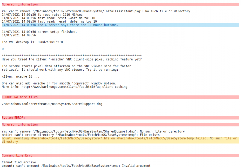

Now if I try to go to the web UI for the Macinabox image, I get the VirtManager page show up but a message telling me:-
So what am I doing wrong??

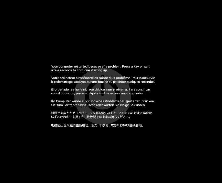

12 minutes ago, 1979 said:
The system starts shows the initial option to install OSX and then when I select it I get the following error displayed and then it just loops through and reboots back to the start.
Follow this, github repo was updated, maybe still not the image in ca.
Follow the first comment here to fix:
https://github.com/SpaceinvaderOne/Macinabox/pull/49#issuecomment-873745079

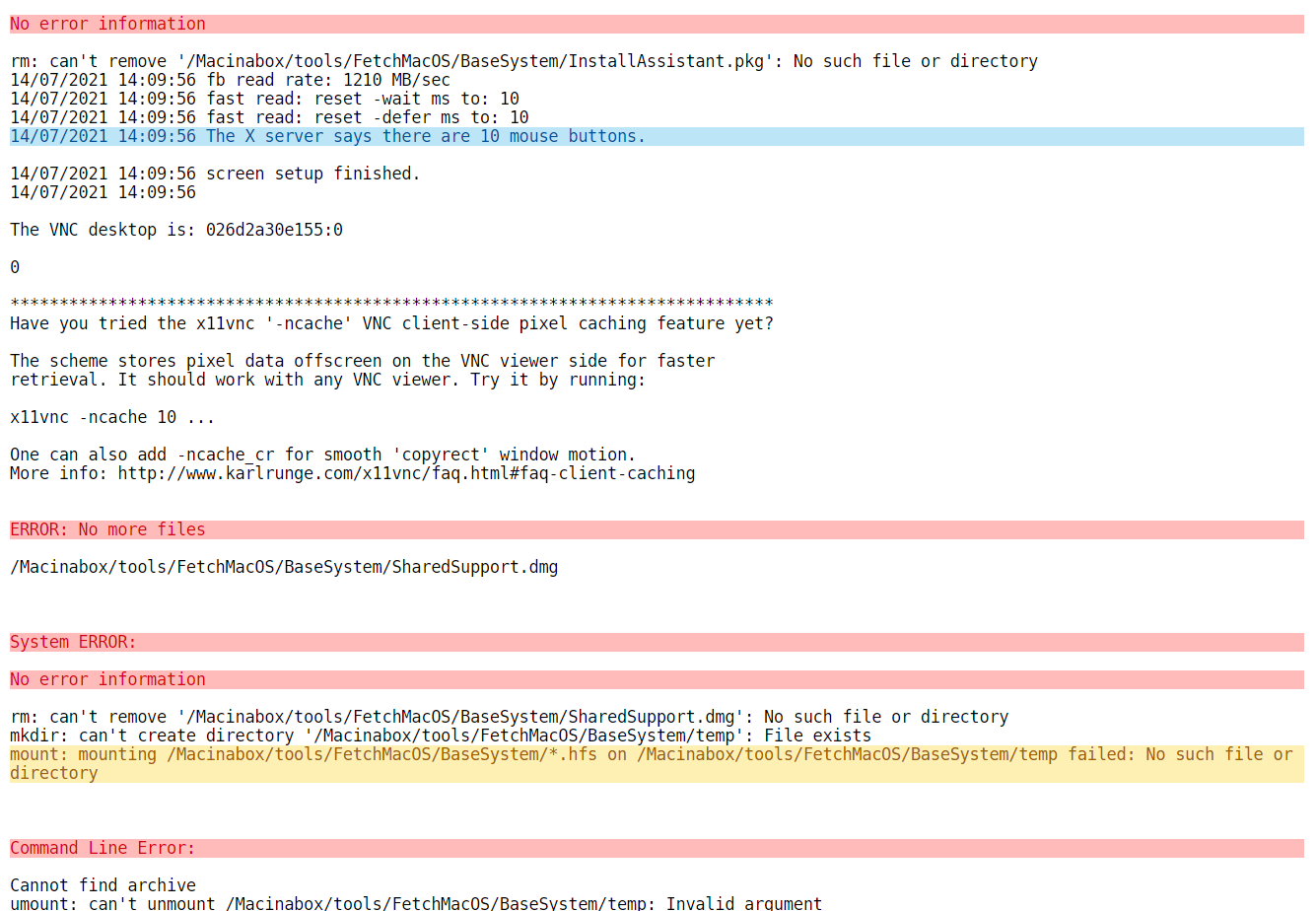

Hello all,
i am setting up Macinabox for the first time and selected Bir Sur as the OS to download. I’m curious how long the download took for those that are using Big Sur. Mine has been running for 6+ hours. In checking the user script log file “1_macinabox_vmready_notify”, it does not show any progress. What am I missing here?
12 hours ago, alex165 said:
Hello all,
Mine show up immediately do you have your unraid notifications turned off? Run the helper script check vm tab. if nothing shows up try again.

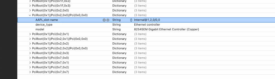

On 7/4/2021 at 6:30 PM, cat2devnull said:
Actually it does talk about how to fix the en0 not having a check mark, but I agree that it's not well written.
https://dortania.github.io/OpenCore-Post-Install/universal/iservices.html#fixing-en0
"Here under Network Interfaces (network card icon), look for en0 under BSD and check whether the device has a check mark under Builtin. If there is a check mark, skip to Fixing ROM section otherwise continue reading."
After running the two commands to delete the .plist files it actually gives instructions about what to do if you don't have an en0 interface so you can ignore the section about NullEthernet.kext and ssdt-rmne.aml since that isn't your issue.
Jump to "Now head under the PCI tab of Hackintool and export your PCI DeviceProperties, this will create a pcidevices.plist on your desktop..."
You just need to add the en0 interface PCI root to your config.plist to tell the OS that it is built-in.
In my case I had to define the built-in option for the WiFI, Bluetooth and the NVMe SSD.
Went in hackintosh tool got the PicRoot then when to opencore mounted the partition config.plist adn added it there but had many errors could not saved got it added still not working

I followed the instructions for that fix and it's still in the crash boot loop when trying that first boot.
Am I correct, that you install the MacInABox Docker (but don't let it start) then grab the two files and run the docker commands in question to update the files in the container... Then and only then you let the docker run?
Even after a full erase of everything, app data, the VM disks and even the ISO and reinstalling per the amended instructions it's still failing to boot even the first time.
Thanks for any suggestions...
Edited by kc4uai
So you need to look at the permissions to understand why you can't edit the file. Also check that the filesystem is mounted as read/write.

I figured it out myself.. But just in case somebody else has this issue...
The problem was the file permissions of the two replacement (discussed in this bug report: https://github.com/SpaceinvaderOne/Macinabox/pull/49 ) files after they were copied into the Macinabox Docker container.  When you pull them using wget, the permissions get set to your user's default and then when you copy them into the Docker container they have the wrong permissions (most notable the "unraid.sh").
The solution is easy.  Just run "chmod 755" on both files before you copy them up to the container. (For example: "chmod 755 unraid.sh")
I also had to switch to "method 2" for fetching the OS media (edit this in the Docker config when you install it).
After that, things worked as expected.
Thanks!

Hey all,
I was making some changes to my config and upon reboot, I'm stuck at the apple logo without any progress bar. I know in clover you could add an arg for verbose. Is there anyway to do this is Opencore? Is there anyway to access the EFI?
I'm having issues installing the VM. After I click the helper script I get this error.
Script location: /tmp/user.scripts/tmpScripts/1_macinabox_helper/script
Note that closing this window will abort the execution of this script
error: Failed to open file '/mnt/user/appdata/macinabox/autoinstall/Macinabox*.xml': No such file or directory
I click done, and there is no VM's loaded. Any ideas?
