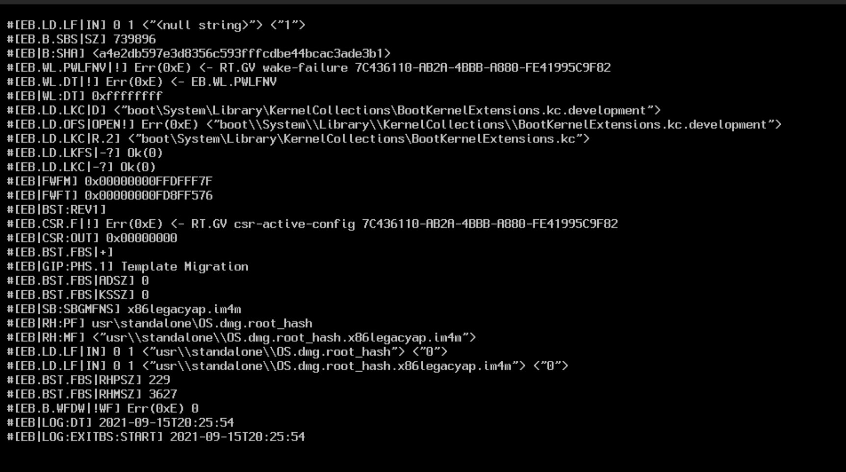

OK! So good news is I got the Mac VM to HALF boot lol. I can turn it on, it pops on my screen and asks to pick a boot drive, then you get the black screen with all the code flashing by, then….. black screen. OR. I get a pink striped screen, it reboots and gets stuck in a boot loop.
Anyone else experience this? Here’s the setup thus far

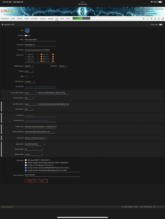

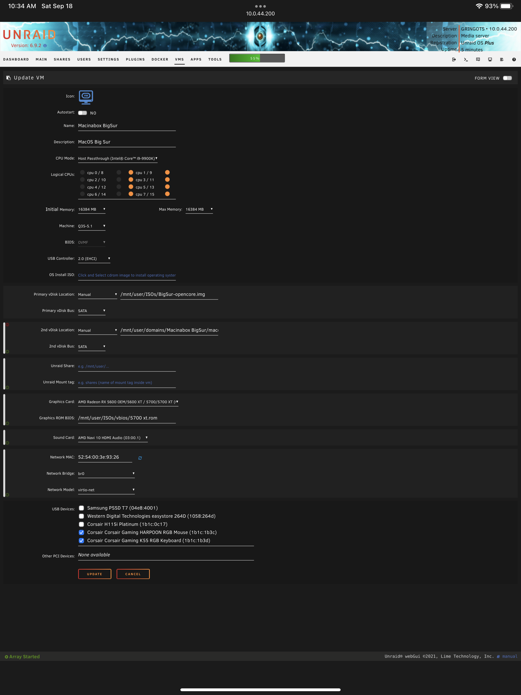

I can't help much here as I don't have any AMD graphics card to try with.
You could post your VM XML instead of the VM configuration screenshot as it is way more precise in what's actually used to configure your VM. User interfaces lacks a number of parameters that text configuration files show.
That’s alright! I appreciate you trying. haha. And DERP. Can’t believe I forgot to post the XML instead. Here we are

Just spent last hour and half setting this up but i guess i used the wrong version of opencore configurator causing the above style error :( I am now trying to fully reinstall from scratch again.
  • Which version of opencore do i need to use to set this up properly?
    • What are issues can cause the above screen? I had tried 4 cores / 8 threads, 3 cores / 6 threads and using yes and no on the topology (I thought it was that error at first but going back a few pages, people said it may actually be an opencore software issue)
  • How can i rename the VM to just “macOS” instead of “Macinabox Big Sur” once I’ve properly installed?
Edited by Linguafoeda
Your need a compatible Opencore Configurator version for your Opencore Bootloader Version. In the case of Space Invader's latest tutorial, you need the version 2.19.1.0:
https://mackie100projects.altervista.org/download/opencore-configurator-2-19-1-0/
The issue for this screen is that your Bootloader version isnt compatible with your Configurator version. When you create your config.plist file with the configurator and the verions doesnt match together, the configurator breaks up your config.plist and the bootloader cant boot the OS.
Try it first without a GPU and use VNC instead. Cause if you use a incompatible GPU this also can be a reason that you will stuck in this boot screen(e.g. AMD RX 6XXX Series or all of the newer NVidia Cards).
