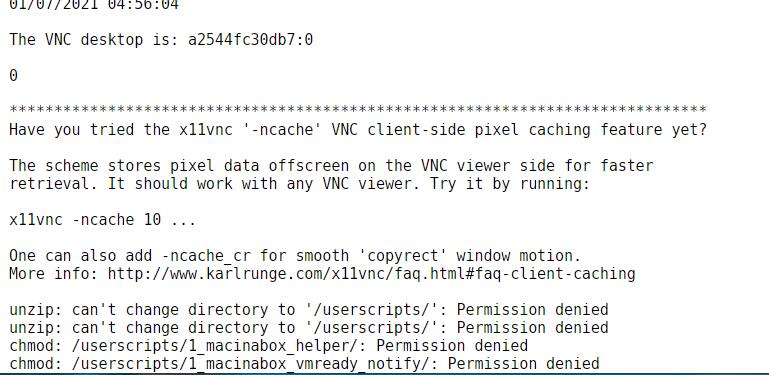

Who can help me............................😭
when i install macinabox ,something wrong with it ,looks like permit problem.
I have been installed it for many times and tried four PC , all like this.Please .....................................

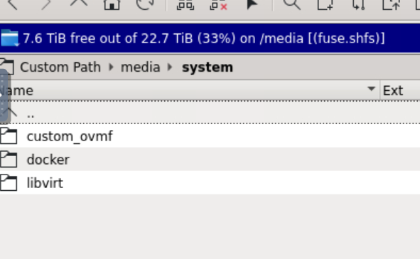

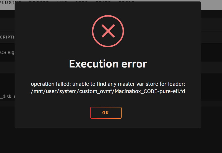

9 hours ago, Kodiak51103 said:
Downloaded macinabox start it to begin install getting this error? Thanks
Macinabox uses custom OVMF files.
Have you checked to see if the files exist?
The error message is pretty clear... It can't find /mnt/user/system/custom_ovmf/Macinabox_Code-pure-efi.fd
Usually when people get these types of errors it is because they have changed the default locations for files during the installation or deleted the files by mistake.
You can always download them again from GitHub.
https://github.com/SpaceinvaderOne/Macinabox/tree/master/ovmf
When into spaceinvaders app yes file is in the correctly place.image.png.3e76ed740816fa6270bd05175f69f9dd.png
Please don't take this as me being mean... Just trying to get the the bottom of the issue...
So you haven't demonstrated that the file is in the right place, the pic only shows the directory, not the file. Also I'm not familiar with the app you are using and what this "Custom Path" business is about.
If you open a terminal window for your server from the Unraid web GUI you should see the following;
root@Tower:~# ls -la /mnt/user/system/custom_ovmf/Macinabox_CODE-pure-efi.fd
-rwxrwxrwx 1 root root 3653632 Apr  5 06:54 /mnt/user/system/custom_ovmf/Macinabox_CODE-pure-efi.fd
Also check what you have defined in the <OS> section of the VM template as it will need to match.
<loader readonly='yes' type='pflash'>/mnt/user/system/custom_ovmf/Macinabox_CODE-pure-efi.fd</loader>
Unraid is just looking to read this file. There has to be something simple happening. Eg the file is missing, the permissions are set incorrectly, etc.

LOL your not mean your helpfull and correct i dont know much about linux the custom path garbage is the krusader app ran what you said:
root@DeathStar:~# ls -la /mnt/user/system/custom_ovmf/Macinabox_CODE-pure-efi.fd
-rwxrwxrwx 1 root root 3653632 Apr  4 15:54 /mnt/user/system/custom_ovmf/Macinabox_CODE-pure-efi.fd*
root@DeathStar:~#
 <type arch='x86_64' machine='pc-q35-4.2'>hvm</type>
    <nvram>/mnt/user/system/custom_ovmf/Macinabox_VARS-pure-efi.fd</nvram>
  </os>
Also before this i had another error could not delete the VM kept getting
Requested operation is not valid: cannot delete inactive domain with nvram
Ran this virsh undefine --nvram "macinabox bigSur"
then was able to delete the vm and now i got this
Thanks
Edited by Kodiak51103
Ok, so we have ruled out the obvious.
I did a quick bit of googling and nothing jumped out at me.
You could always try using the default OVMF file rather than the Macinabox version and you could try using a newer q35 machine model. v4.2 is pretty old and you may be hitting a weird bug.

18 hours ago, Kodiak51103 said:
Macinabox_CODE-pure-efi.fd is not the missing file: please read carefully the error message --> qemu is unable to find any master var store for the loader.
So it's the _VARS-pure-efi.fd file that is missing, either the path is wrong, or you deleted it or you undefined the vm, or permission issues, as it was written.
Edited by ghost82
Yep, of course... Feel like a bit of an idiot :)
My understanding is that there is nothing special about this file between Macinabox and a generic install. It just holds the NVRAM vars.
As such all @Kodiak51103 should need to do is check to see if he has a VARS file under;
and that they are correctly defined in the <OS> section of his VM config.
or use the copy made when the VM was created under;
/etc/libvirt/qemu/nvram/
In the interest of keeping everything stock standard, I would recommend pulling the file(s) down from GitHub and put them back into the custom_ovmf directory. Then return the VM config back to default.
<os>
</os>
