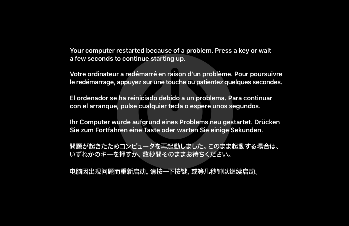

Hi Guys,
I have a Dell PowerEdge R710, I have followed the steps in the video below and everything for the most part works fine until I go to boot up the machine and start the installer, I get the "your computer restarted because of a problem", and then the apple loading screen then a reboot and back to select boot drive menu.
I have tried all the different OS options going back until High Sierra, same thing happens.
Any ideas whats going on here?
The processor is a Intel XEON X5675 with 192GB of DDR3 RAM.
Please help.
Regards
Reece
On 6/3/2021 at 9:55 AM, ricksimpson said:
Hi Guys,
Please help.
Regards
Reece

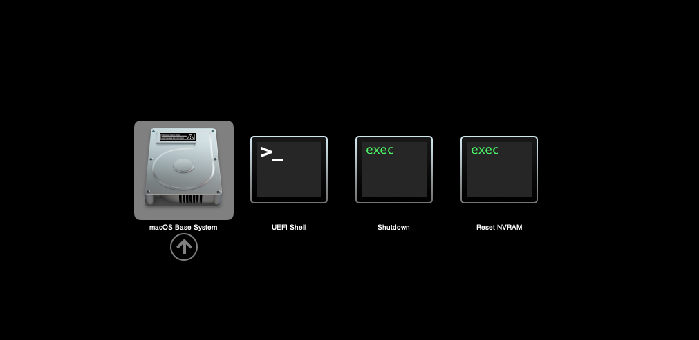

In the same boat here, I'm just awaiting someone to post a solution. Been fiddling with it for a couple weeks now with zero luck.
-edit managed to capture a photo quick enough to see an error:
Edited by kingfetty

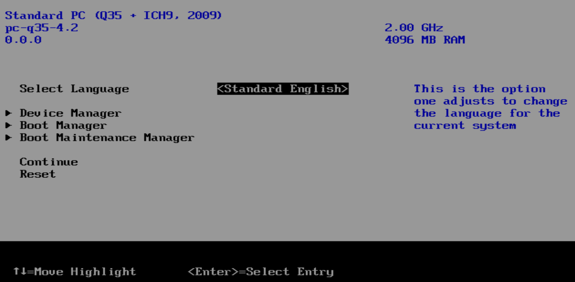

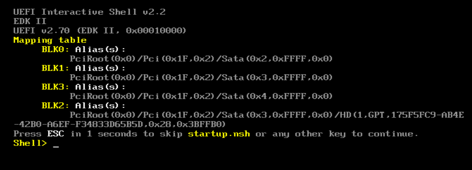

Hey guys Im new to unraid and trying to setup a mac vm, however I cant get past the initial boot
Here is my XML
That's not an error message, it's just logging about which drive it is going to boot from. See my post about about needing more information to help you debug further.

So ive been searching around. How do I enable OSX debugging?
EDIT: I managed to capture this
Edited by IamDan
Capture
I’ve used the term debugging and verbose interchangeably, which may have been confusing.
Add the boot-args "-v keepsyms=1" to your config.plist as I mentioned above, and is documented here :).
https://dortania.github.io/OpenCore-Install-Guide/troubleshooting/kernel-debugging.html#config-plist-setup
This will turn on verbose mode when OS X boots and then you should be able to see what is causing the kernel panic.

So I added verbose mode and now it boots directly to
12989601_Screenshotfrom2021-06-1019-18-49.thumb.png.8b290e3f999c7b522d88fa7b393ead20.png
If I exit I get into the bios ?????🤨
2037753519_Screenshotfrom2021-06-1019-21-59.thumb.png.90e8daef30824ac1572baeefc9bf2afe.png
Im starting to think this might go in the to hard basket untill I upgrade my hardware😂

Ok, so I am not very experienced with this situation but what has happened is that the VM is booting into the UEFI, but then the UEFI cannot find a valid OS (BOOTx64.efi) to boot, so stops.
This means that you have either damaged your EFI partition. Deleted or remapped your virtual disk to somewhere it isn't expecting, or similar.
This wouldn't happen from just adding the boot-args to your config.plist file since the boot process hasn't even got that far yet.
OpenCore Booting:
(from https://dortania.github.io/OpenCore-Install-Guide/troubleshooting/boot.html#xnu-kernel-handoff)
  1. System powers on and searches for boot devices <- you're stuck here
  2. System locates BOOTx64.efi on your OpenCore USB under EFI/BOOT/
  3. BOOTx64.efi is loaded which then chain-loads OpenCore.efi from EFI/OC/
  4. NVRAM Properties are applied <- this is where you made the change
  5. EFI drivers are loaded from EFI/OC/Drivers
  6. Graphics Output Protocol(GOP) is installed
  7. ACPI Tables are loaded from EFI/OC/ACPI
  8. SMBIOS Data is applied
  9. OpenCore loads and shows you all possible boot options
  10. You now boot your macOS installer
I would start by checking your EFI partition/vdisk and check that you somehow didn't break your disk mappings in your VM XML config.
