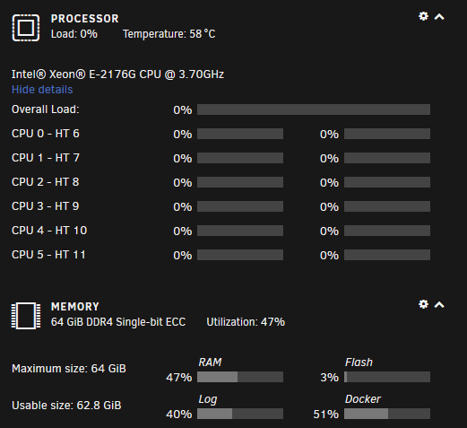

I've noticed that the cpu activity graph on the dashboard will become inactive, with no data shown for any core.
I have VM turned off. I'm running a number of dockers.

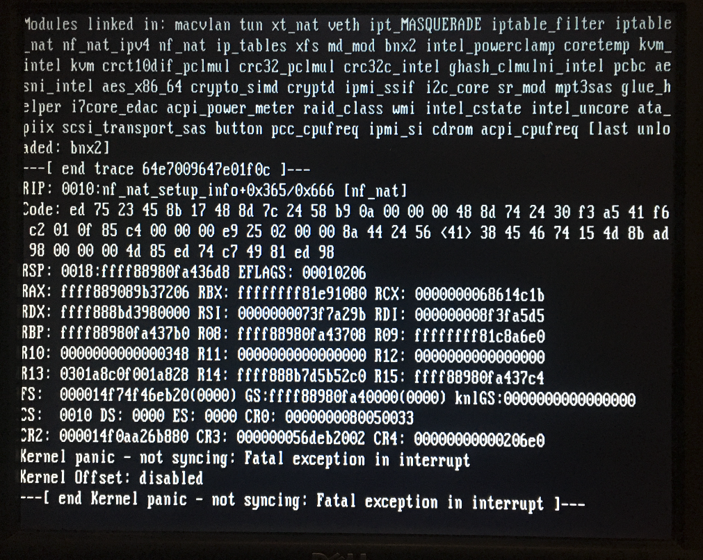

I spoke too soon. A few hours after the post above, the server hard crashed. Web ui totally unresponsive, no ssh etc. This was on screen of the attached monitor.
