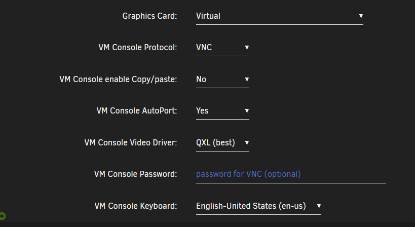

I restored the VM from the previous day using the script.  Looked to go well but failed to start with "internal error: Failed to reserve port 5700".  Checking the restore xml it looks to be the display port.  Im not sure how to troubleshoot or work around that error.
Edited by Green Dragon
That's easy, it has to do with the VNC port. (or Spice protocol if you use that) Go to the port section and change VM Console AutoPort from auto to 'no' and pick a new port NOT in conflict with an already assigned port. (VM)
Edited by dja
All back to normal now.  Thanks!
