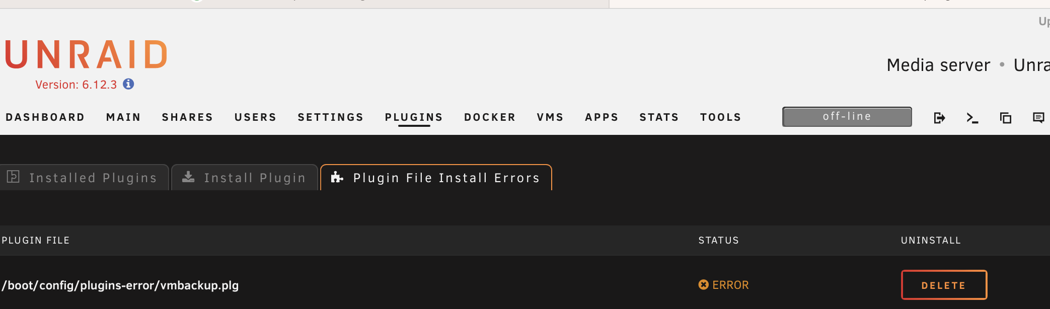

Tried to update the app today but failed. Tried uninstall and reinstall, same error: "plugin: run failed:".  Maybe I should not have updated when it was running ok? Can someone help me plz. Thx
plugin: installing: vmbackup.plg Executing hook script: pre_plugin_checks plugin: downloading: vmbackup.plg ... done Executing hook script: pre_plugin_checks Removing package: xmlstarlet-1.6.1-x86_64-1_slonly Removing files: --> Deleting symlink /usr/bin/xmlstarlet WARNING: /usr/bin/xml changed after package installation. --> Deleting /usr/bin/xml WARNING: /usr/doc/xmlstarlet-1.6.1/AUTHORS changed after package installation. done +
============================================================================== | Installing new package /boot/config/plugins/vmbackup/packages/xmlstarlet-1.6.1-x86_64-1_slonly.txz +============================================================================== Verifying package xmlstarlet-1.6.1-x86_64-1_slonly.txz. Installing package xmlstarlet-1.6.1-x86_64-1_slonly.txz: PACKAGE DESCRIPTION: # xmlstarlet (command line xml tool) # # XMLStarlet is a command line XML toolkit that can be used to # transform, query, validate, and edit XML documents and files using # a simple set of shell commands, which work similarly to 'grep', # 'sed', 'awk', 'tr', 'diff', or 'patch' on plain text files. # # Homepage https://sourceforge.net/projects/xmlstar/ # Executing install script for xmlstarlet-1.6.1-x86_64-1_slonly.txz. plugin: downloading: vmbackup-v0.2.5-2022.12.25.txz ... done +==============================================================================
| Skipping package vmbackup-v0.2.5-2022.12.25 (already installed) +==============================================================================
plugin: run failed:
/bin/bash Executing hook script: post_plugin_checks

I rebooted the server now it installed fine. Maybe some files were not cleaned up during the update process....

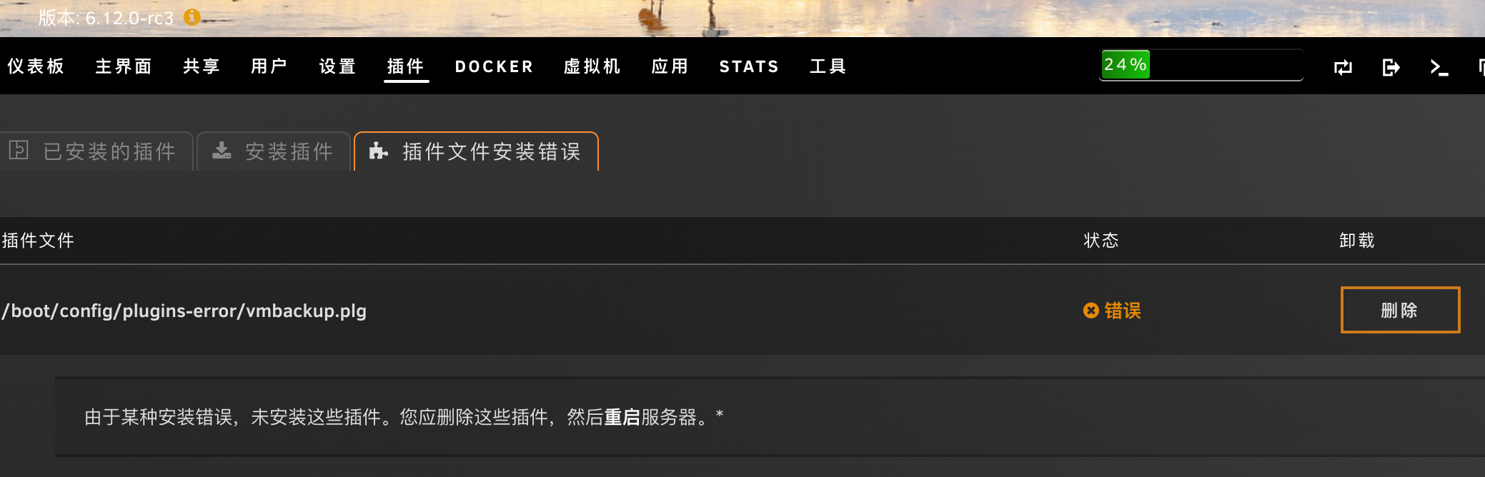

This plugin has problems with 6.12rc3

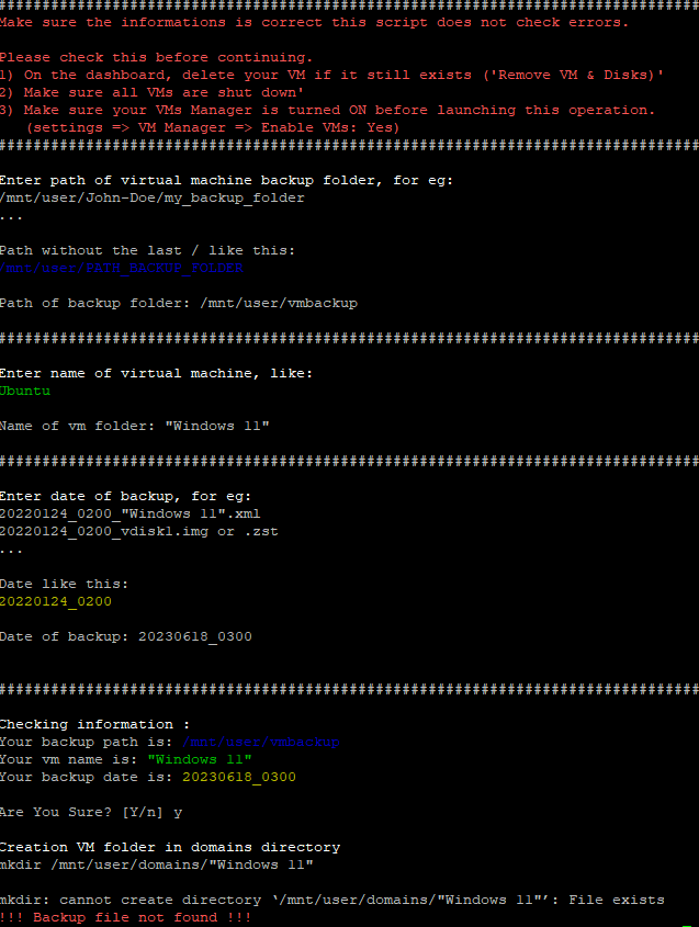

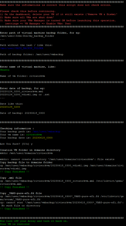

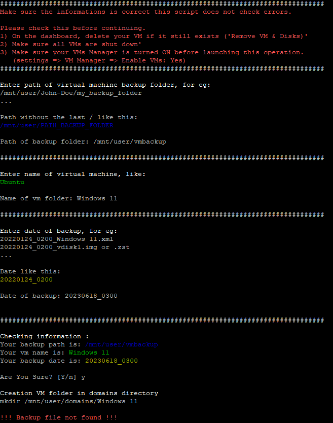

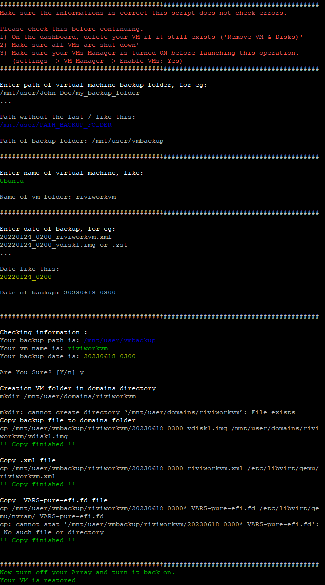

Although I was not able to successfully use the script, I was able to follow the manual method successfully. In hindsight it was fairly simple. After restoring a VM for the first time, I noticed a few things:
  • In the future, choose VM names carefully. No spaces or weird shit.
  • Remember previous rule.
I suspect the issues I had w/ the script were a result of my naming scheme for vms not being consistent or based in reality. I noticed my mistakes while reviewing the .xml file. VM name was "Windows_10" but I must have renamed it at some point in the past because within the XML i noticed "Windows 10". I also removed the date from the .fd file. The XML referenced an .fd file w/o a date in the name.
From: 20230513_0305_8839995b-3d3b-115b-49bd-90e6e647bc45_VARS-pure-efi.fd
To: 8839995b-3d3b-115b-49bd-90e6e647bc45_VARS-pure-efi.fd

Can anyone help edit @petchav's script to work with VM names that include spaces? I don't know bash scripting, but have been trying to figure it out for the last hour. The most positive change I made is to line 87,
mkdir /mnt/user/domains/$VM_NAME
which I edited to
mkdir "/mnt/user/domains/$VM_NAME"
That got me past creating incorrect directories. Now if my VM name is "Windows 11", then it will create the correct directory in the domains folder. However, it is still failing after that with `!!! Backup file not found !!!`
I've tried adding quotes at various places in lines 102, 112 & 120 but still the script fails at the same point. I've also tried adding quotes in various places to lines 89, 95, 110, 116 & 117 which are the lines that define `BACKUP_FILE`, but again, not making any progress.
Figured someone that knows scripting and the correct syntax might be able to fix the script easily

Yes, sorry for not being more clear! I am talking about the restoration script. It works great for VMs with no spaces in the name and I'm sure it can be fixed to work with VMs that do have spaces in their names, but it's not something I've been able to figure out with my limited knowledge.
Maybe PM the author directly?  He mentioned that he was willing to try to edit the script to include support for VM names with spaces way back when he released it.  Perhaps he just forgot?

Thanks for the response @petchav! Unfortunately, typing the VM name within the CLI wrapped in quotes does not work.
Here's an example of the script not working with a VM name that has spaces.
Here it is working perfectly for a VM name that does not have any spaces.
And here it is failing when wrapping the VM name in quotes.
The error message is simply `!!! Backup file not found !!!`. I think there is another line or two in the script where the path needs to be wrapped in quotes, but I can't figure out where.

My issue is that when I reboot, the box comes up and the plug-in sits in the Plugin file install errors (as image)
1871603520_Screenshot2023-08-03at21_09_30.thumb.png.38a04684e6ed1332b514379b1ca7ef8a.png
If I delete and then manually install again, it works.
I have just rebooted to get the screenshot, if there are any logs I can provide from anywhere please let me know
