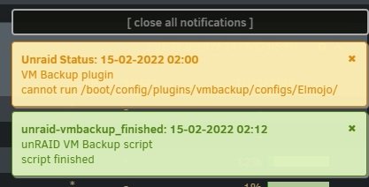

7 hours ago, Elmojo said:
Odd news: it reported the error "cannot run default"
Umm...okay? Default is disabled, it's not supposed to run. Why am I getting this message now? I don't recall ever seeing it previously.
I believe you may be seeing that because you have "Enable Backups" marked as "NO". It looks like you manually ran it however, which is why you see the notification telling you it completed. Think of the warning more as a "Heads up, auto backups won't run".

I did not manually run it. That was the notification from overnight, when the scheduled task ran.

So I'm still getting these odd "cannot run" error messages, even though everything seems to be working correctly. Any update on how to make it stop throwing false errors? It's really disconcerting when I open the dashboard, and see an orange warning message. Makes me thing something has gone wrong. lol
Here's my complete log file for the job that ran last night...

And here's what the message is saying on screen....
For reference, the "default" job is disabled completely, both by selecting Enable Backups? to 'No' and by setting Backup Frequency to 'Disabled'.
Edited by Elmojo
added info
Can you post your custom job file from /boot/config/plugins/vmbackup/Elmojo
Edited by dja
I'd be happy to, but I have no idea how to access that file. :)
Do you need have a custom job for your backup? Can you try the default job?
It was suggested way back (by you I believe) that we not use the default job, but create our own jobs. I can't recall why. Maybe it's in the documentation? It's been a while now, and my memory isn't so good these days... lol

Even if you delete the config and only use Default, you get the message.
With Default there is no message. However, the old config seems to be still somewhere in the planner because it still triggers the message.
Event: Unraid Status
Subject: VM Backup plugin
Description: cannot run /boot/config/plugins/vmbackup/configs/Test/
Importance: warning
2022-05-12 00:30 User script file does not exist. Exiting.
Which makes sense this time, because you deleted the config. But how do I get it out of the scheduler?
