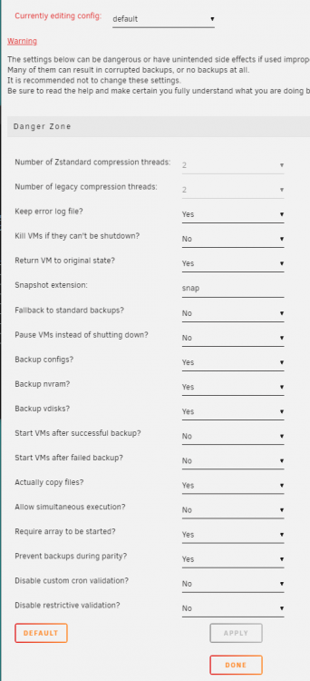

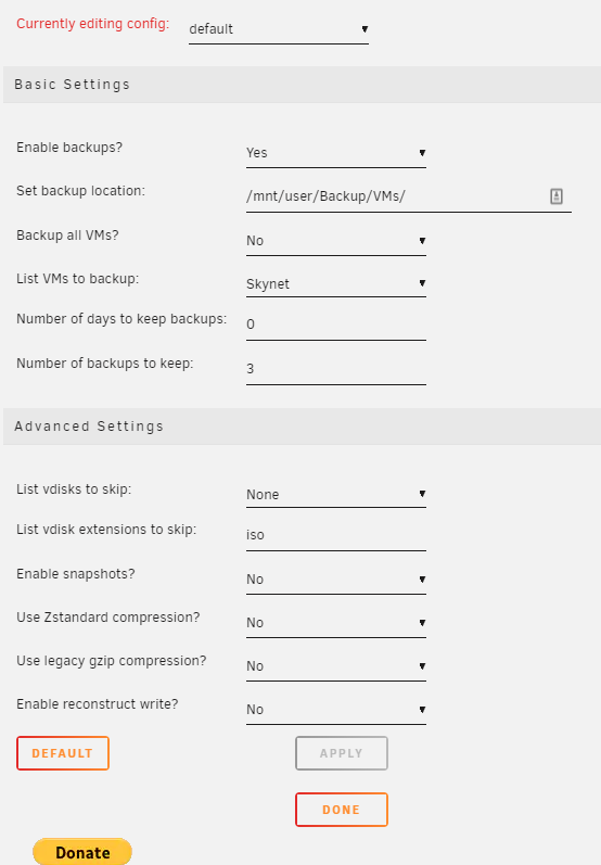

I'm trying to set up this plugin to backup a VM that is running. I.e. it needs to be shut off before the backup.
The plugin logs that it tries to shut it off, but it's not working. I've tested and the VM can ble cleanly shut down with "Stop" through the WebUI, so theres nothing preventing the VM from being shut off.
Theres also nothing in the syslog indicating that the VM has gotten a shutdown-command, so I'm pretty sure this is not working from the plugin.
Any pointers? I obviously don't want to enable force shutdown/kill.
Thanks!
 image.thumb.png.5579a1cdff9c69aa310c2fc6ac223171.pngimage.thumb.png.686361859800fc4f5fb3af3f326074b3.png

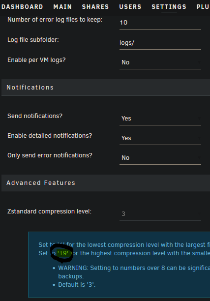

Hi all,
First of all BIG Thanks for the plugin , real good thing , using it on 5 systems for months , no issues whatsoever
- except VM states , i did think its plugin issues , but then after some playing and trial and error ALL the issues are related to VMs(mostly Windows being windows and settings after updates etc)
Now i do have a question , how is it so fast? if i use anything using same disks (from NVME to NVME) be that duplicati or anything really i tried a lot , it takes around 20 minutes to backup up to 200GB (be that 1,2 or 4 VMs)
But the plugin does it in 2 minutes,
where can i read , or can some1 explain why the plugin is so fast and everything else is not?
mainly asking because id like a restore option, in the meanwhile its not an issue, especially since i didn't even need it yet, but ill do it manually if needed.
Also i assume that (attached screenshot) this is a mistyped value.image.png.6c45251014ed2d9be47c096a1ca860ef.png
Edited by Xcage
