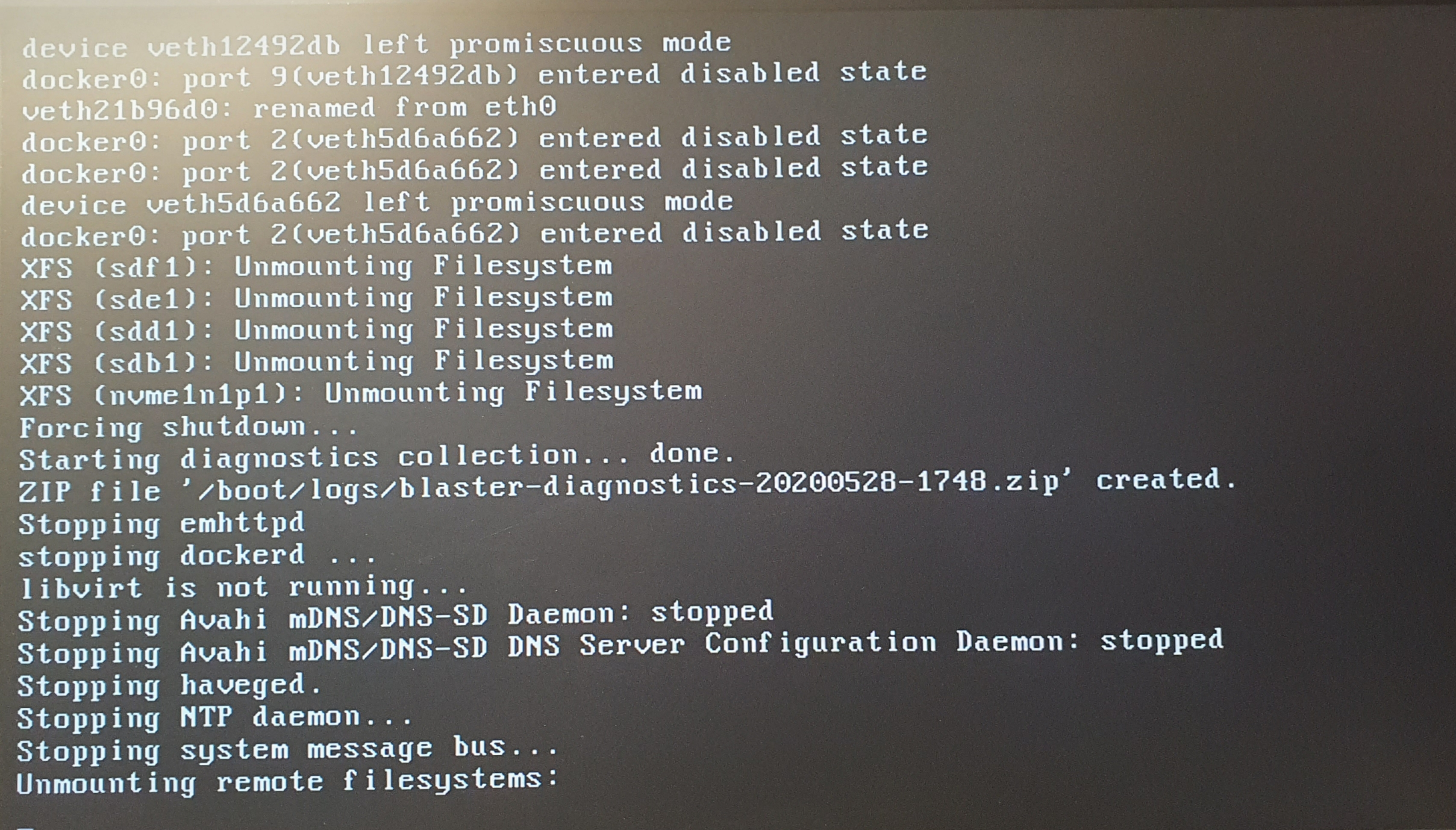

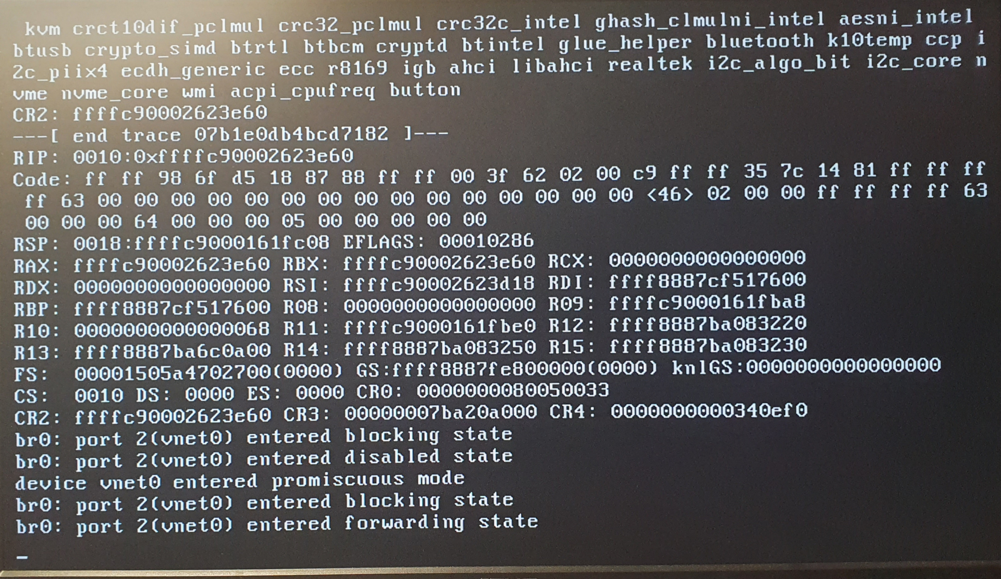

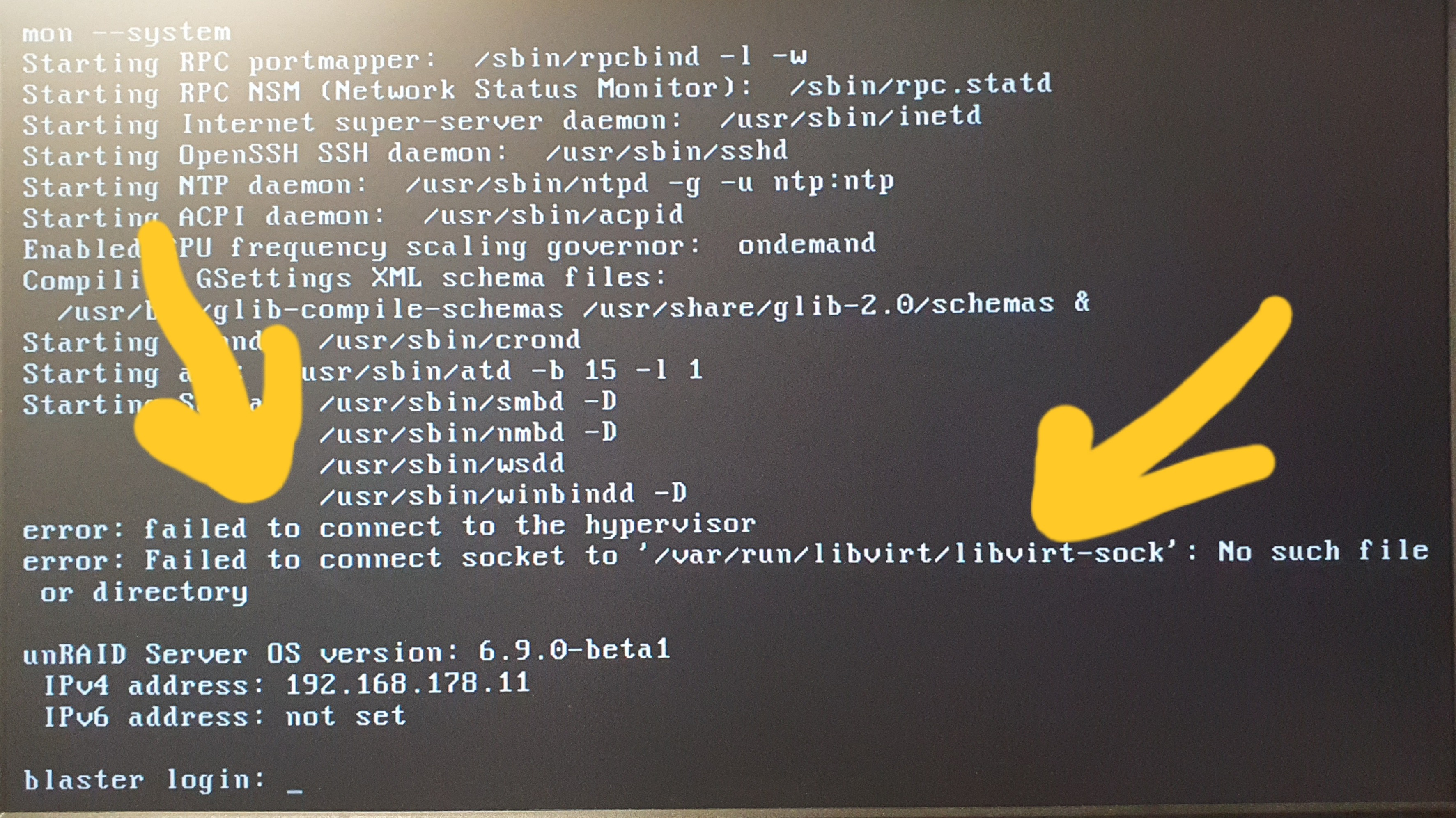

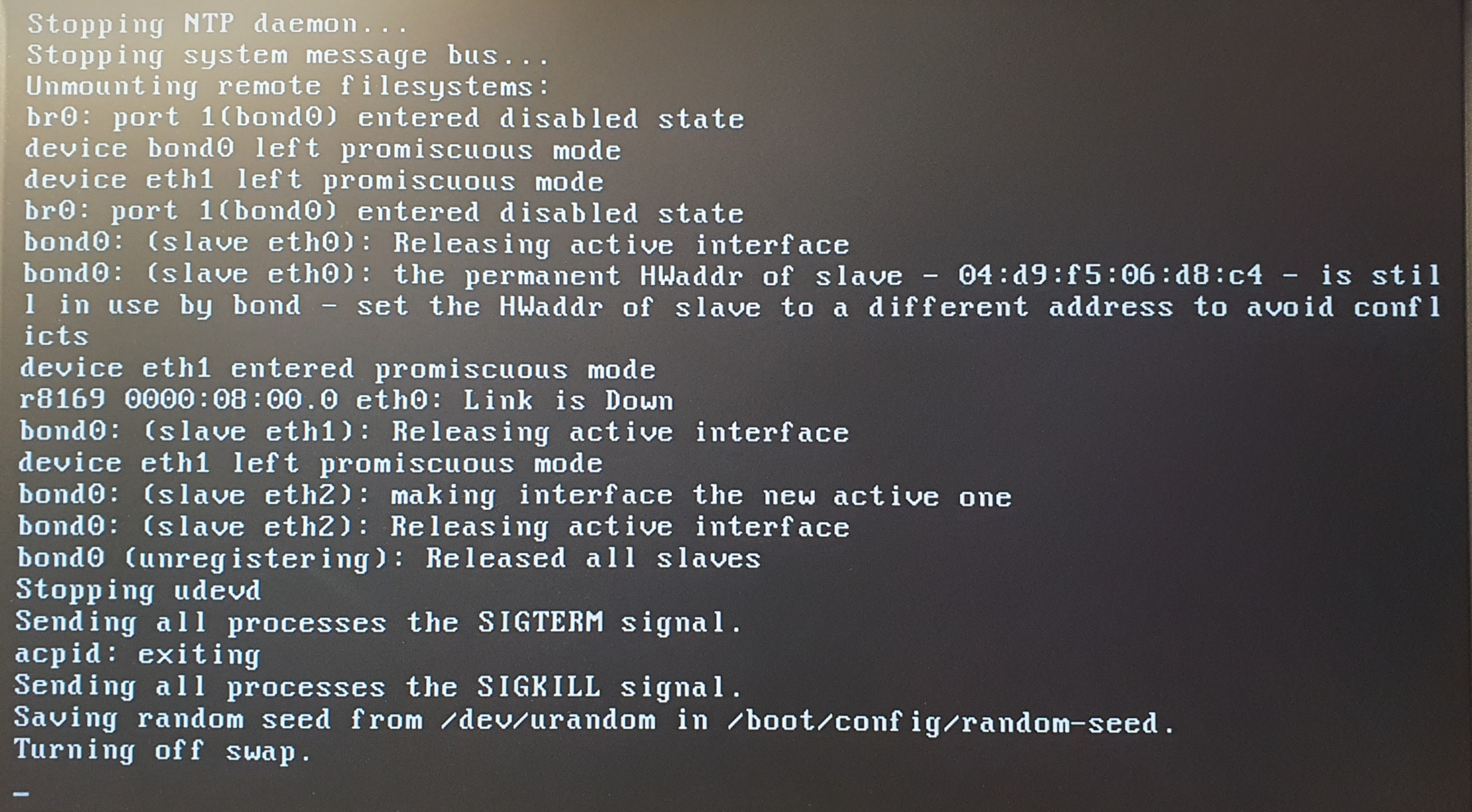

I've been using this plugin to backup my VMs for a couple weeks now, but unfortunately I've found that this this is the cause of my server being unable to shutdown.
My unRAID was unable to shutdown and would freeze forcing me to hard kill the system, causing a parity check every time. I do not want to do this for an otherwise stable system.
Rolled back from 6.9.0-b1 to 6.8.3 didn't solve it.
Running in safe mode showed that everything worked, but I couldn't start my VMs due to the Unassigned devices plugin.
Uninstalling the VM Backup plugin solved the issue, and removed the error at startup.
Something in the VM Backup plugin is breaking the Hypervisor and messing with my bonded network connection.
From what I can tell, first there's the
"error: failed to connect to the hypervisor"
error: Failed to connect socket to '/varrun/libvirt/libvirt-sock' : No such file or directory"
After this, I seemed to be getting some kind of trace error when shutting down:
More shutdown:
And finally stalls here forever (I've waited a day for this, and it didn't shutdown😞
Uninstalling the VM Backup Plugin fixed the issue, and I can now shutdown/reboot without stalling, crashing and parity check. The errors have gone also.
It is a real shame because I use this plugin daily (Nightly).
Does anyone know why this is happening? I'd like to use this plugin.
More shutdown:
I have the exact same issue, if you get to the bottom of it please let us know!
