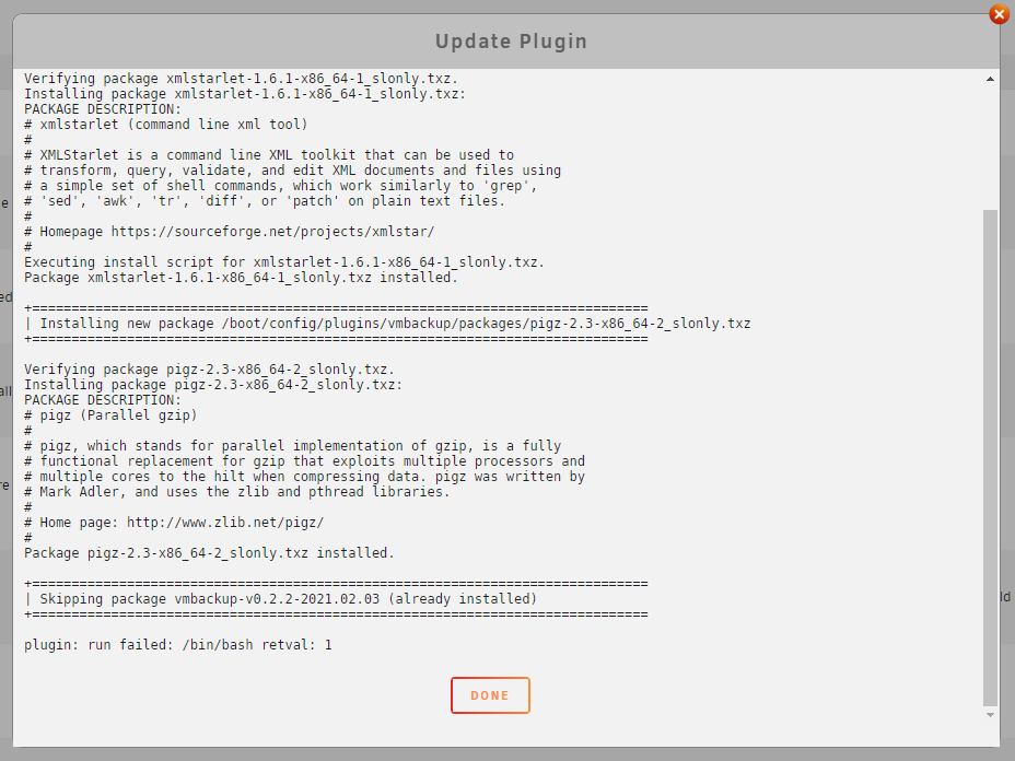

now i get the following error and vmbackup is gone
| Installing new package /boot/config/plugins/vmbackup/vmbackup-v0.2.2-2021.02.03.txz
Verifying package vmbackup-v0.2.2-2021.02.03.txz.
Installing package vmbackup-v0.2.2-2021.02.03.txz:
PACKAGE DESCRIPTION:
Package vmbackup-v0.2.2-2021.02.03.txz installed.
plugin: run failed: /bin/bash retval: 126
Updating Support Links
I get the same error when installing VM BACKUP - on Unraid 6.9 and now on 6.9.1

On 3/7/2021 at 9:43 AM, Squid said:
The bigger problem is that 2021.02.03 doesn't actually work and causes display corruption, etc.
I finally found the issue. For some reason, several of the files had their EOL character changed when I pushed the last update (I'm blaming GitHub).
As long as you have removed the broken version this should work.
If you get an error saying that the plugin is already installed when you try to install this version, you will need to remove the the old version.
If you have already removed the old version and are still getting an error saying that the plugin is already installed, run the following terminal command and try again.
removepkg vmbackup*

I removed it and then decided to reinstall but can't.
I get this error:
plugin: installing: https://raw.githubusercontent.com/jtok/unraid.vmbackup/master/vmbackup.plg
plugin: downloading https://raw.githubusercontent.com/jtok/unraid.vmbackup/master/vmbackup.plg
plugin: downloading: https://raw.githubusercontent.com/jtok/unraid.vmbackup/master/vmbackup.plg ... done
Removing package: xmlstarlet-1.6.1-x86_64-1_slonly
Removing files:
Removing package: pigz-2.3-x86_64-2_slonly
Removing files:
| Installing new package /boot/config/plugins/vmbackup/packages/xmlstarlet-1.6.1-x86_64-1_slonly.txz
Verifying package xmlstarlet-1.6.1-x86_64-1_slonly.txz.
Installing package xmlstarlet-1.6.1-x86_64-1_slonly.txz:
# xmlstarlet (command line xml tool)
# XMLStarlet is a command line XML toolkit that can be used to
# transform, query, validate, and edit XML documents and files using
# a simple set of shell commands, which work similarly to 'grep',
# 'sed', 'awk', 'tr', 'diff', or 'patch' on plain text files.
# Homepage https://sourceforge.net/projects/xmlstar/
Executing install script for xmlstarlet-1.6.1-x86_64-1_slonly.txz.
Package xmlstarlet-1.6.1-x86_64-1_slonly.txz installed.
| Installing new package /boot/config/plugins/vmbackup/packages/pigz-2.3-x86_64-2_slonly.txz
Verifying package pigz-2.3-x86_64-2_slonly.txz.
Installing package pigz-2.3-x86_64-2_slonly.txz:
# pigz (Parallel gzip)
# pigz, which stands for parallel implementation of gzip, is a fully
# functional replacement for gzip that exploits multiple processors and
# multiple cores to the hilt when compressing data. pigz was written by
# Mark Adler, and uses the zlib and pthread libraries.
# Home page: http://www.zlib.net/pigz/
Package pigz-2.3-x86_64-2_slonly.txz installed.
| Skipping package vmbackup-v0.2.3-2021.03.11 (already installed)
Got the above error fixed by simply rebooting unRAID but I'm getting this now.

2021-03-25 17:47:08 information: cleaning out error logs over 10.
Any thoughts?  The backup worked once but won't work again.
ETA: I figured it out.  It happened because I removed the OS Install ISO path from the VM setup.  Once I put it back in the backup worked again.
