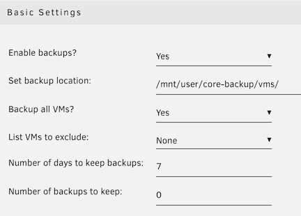

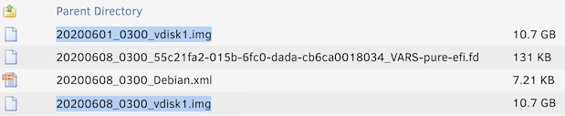

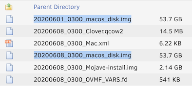

Great plugin. I'm having one problem, maybe a misconfiguration on my part.
I have two VMs I backup weekly:
Both have the same problem: the primary vdisk from the last backup isn't deleted so there are always two, previous and current.
Debian
MacOS

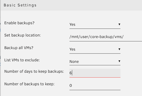

I've tried changing number of days to 6 (thinking it might be a timing issue) but the plugin prevents it:

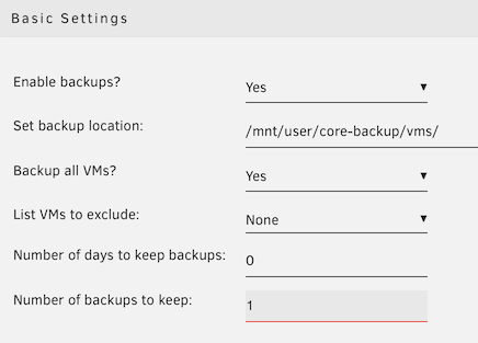

I've tried using number of backups instead of date but the plugin prevents that as well:
Anyone know where I'm going wrong?

Just to follow up on my earlier post re: configuring the plugin to only keep 1 weekly backup, I hacked the code to accept "6" in the Number of days to keep backups field (7 was the lowest non-zero limit) and it's working as expected.
