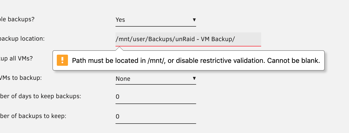

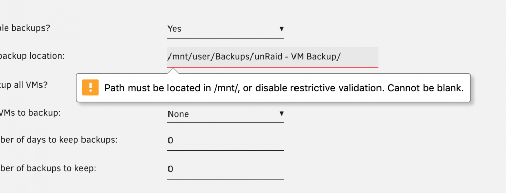

Can't seem to get the path to work, I'm using a path in /mnt, but it still errors:
456795399_Screenshot2019-12-22at22_05_29.thumb.png.95798fc0b38affc08b5edb70a1f15fd6.png
I also tried to disable restrictive validation, but the same occurs.
Best.
It looks like the validation isn't allowing paths with spaces. I will add fixing that to my to-do list.
Thanks.

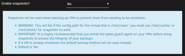

Snapshots don't work for me.
in logs after a successful backup;
2019-12-23 12:51 information: commited changes from snapshot for /mnt/user/domains/Linux/vdisk1.img on Linux.
2019-12-23 12:52 information: forcibly removed snapshot /mnt/user/domains/Linux/vdisk1.snap for Linux.
Backups successful, check attached device is still called snap;
# virsh domblklist 6
 Target   Source
 hdc      /mnt/user/domains/Linux/vdisk1.snap
Looks like this.
You have to adjust the path for each VM to make the snapshots work.

Maybe I don't understand how snapshots work.
I understand you need QEMU Guest Agent in order to be able to create snapshots. So I tried with a Windows 10 VM and it creates a snap file but also create a full vdisk copy in backup directory. Every backup it creates another full disk image. Is that how it works or I'm doing it wrong. I tought that a snapshot saves just the data that's different from the latest vdisk.
@andreidelait
Unfortunately, the snapshot mechanism is just for allowing backups to be performed relatively safely while the virtual machine is running.
I'm over-simplifying this a little bit, but essentially, when a VM is running, it is making changes to the disk image. In order to safely make a backup of a disk image and reduce the chance of data loss, we must stop the VM from making changes to the disk image. We can do that two ways currently. The first is by turning off the VM and making a copy of the disk image while the VM is not in use. The second is to use snapshots.
Snapshots work by creating a second disk image for the VM to start writing to instead of the original disk image. Which is why it is just the changes and not a full copy, just like you were thinking. However, since the snapshots are live disk images, we can't safely back them up for the same reason we couldn't back up the original disk image before. But, after making a snapshot, we can safely make copy of the (now static) original disk image.
So, you are right that the snapshot itself is the changes to the original disk image, but sadly, we can't safely make backups from them. What you are describing is a delta backup.
It is possible I might look into how to perform more complicated backup schemes that use delta backups like incremental or differential backups, but that will be a little ways down the road.
-JTok
P.S. A note about the QEMU Guest Agent. This is entirely unnecessary information, but since we are on the topic of snapshots, and in case anyone is wondering why it is a good idea to use the guest agent, here is an explanation. Again, I am simplifying a bit.
We can actually create snapshots without the guest agent installed. One of the things the guest agent does is allow the guest OS to be informed of things that we are doing at the host level, such as making a snapshot.
When a snapshot is performed *without* the guest agent installed the guest just keeps writing to the "hard drive" without being aware that the disk file it is writing to has been changed to a snapshot image file. This can leave the data on the original disk image in an inconsistent state, meaning that if you try to restore to it there may be issues with some of the information resulting in data loss or corruption. Certain applications are particularly sensitive to this, such as those with databases like an SQL server or Active Directory.
When a snapshot is performed *with* the guest agent installed, the guest OS is asked to quiesce. Meaning that it will flush any write caches to disk, and let all current writes to the "hard drive" finish while preventing new writes from starting. This prepares the original disk image for a backup by ensuring that its data is in a consistent state. Once the original disk image is in a consistent state, the guest is informed it can start writing again, only this time the writes are going to the snapshot.

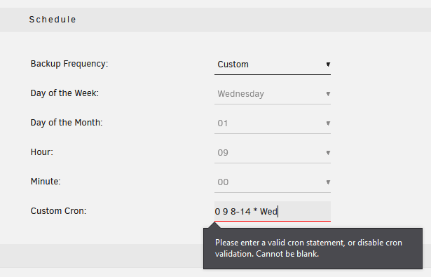

25 minutes ago, queueiz said:
I'm trying to set a custom cron entry but the plugin wont accept my syntax. Why?
What I'm using: 0 9 8-14 * Wed
https://crontab.guru/#0_9_8-14_*_Wed
The ‘Wed’ field is not a valid value.    It needs to be a numeric value (I think it is ‘3’ for Wednesday).
I never knew what cron version Unraid uses......because Wed is a valid value in latest cron version.
Anyone know? It would help when using those cron maker websites
It's the plugin not accepting the value, not cron itself
@queueiz @Stupifier
With cron I have found it extremely difficult to validate for every possible input it will accept because there are so many.
By default I use a more restrictive validation for user input to reduce errors. Since I realize that can prevent valid input that might be desired, there is an option in the Danger Zone tab to remove the validation.
I will update the help to try to clarify what kind of input is accepted by default.
