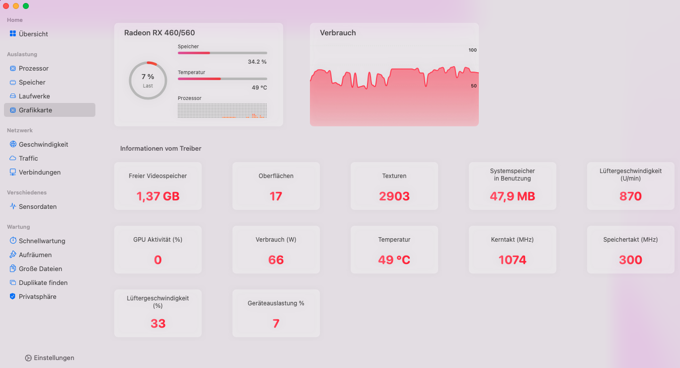

Can report that Apples AirPod Max work like a charm with a MacOS VM. Probably no surprise, but wanted to share this. Also came across this system tool (GER and ENG), which allows access to GPU power consumption & temperatures, system load etc. without adding any additional kexts.
