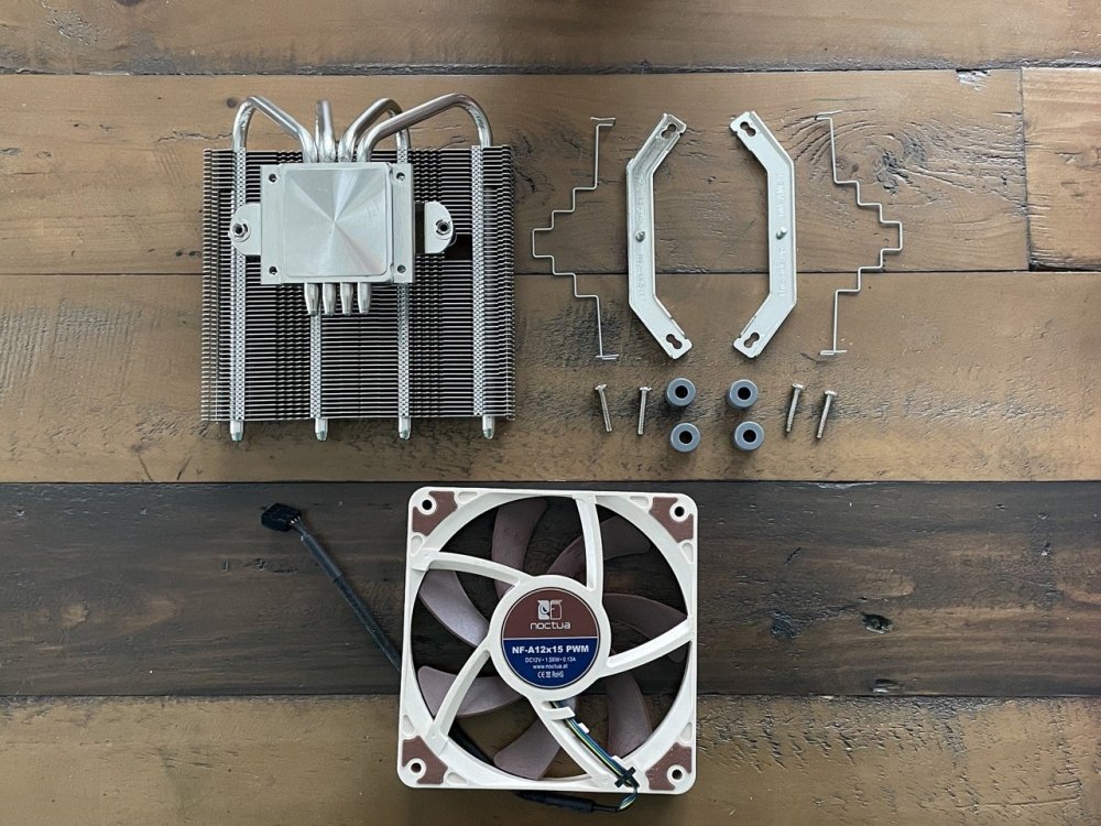

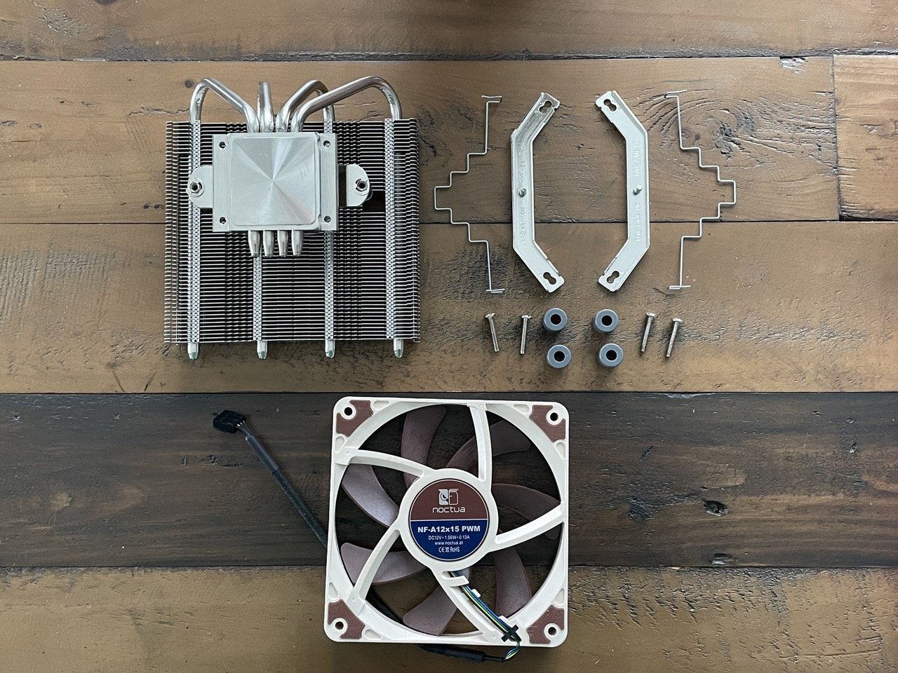

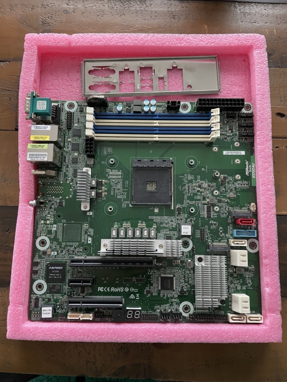

I am selling Board, CPU, Memory and Cooler from my current system since I upgraded Board and CPU. Since I am living in Germany I'd prefer to sell within the Country or the EU, assuming that International shipping might be to costly. However, I am free to explore options, especially for the CPU since it is rare. CPU: ~ sold Ryzen 9 3900 12 Cores / 24 Threads 65w OEM Systembuilder Model (100-000000070). I bough the CPU brand new a year ago. It was never overclocked, but mostly set to 35w or 45w through BIOS settings. I personally think this is one of the best AMD CPUS, comparing watt vs. cores. Memory: ~ sold 2x 32 GB Kingston KSM32ED8/32ME DDR4 3200 ECC Memory. Also 1 year old and 100% compatible with the Board and CPU, since the config has been running rock stable since day one. Board: ~330 Euro ASROCK Rack X570D4U incl. ATX shield. Bios and BMC are up to date so the Board can also take Ryzen 5000 CPUs. Cooler: ~30 Euro, optionally included with CPU Noctua NH-L12S, stock config and fits perfectly on the Board. Details about the config can be found in this thread, where I documented the build process. Questions? Let me know Pictures:
