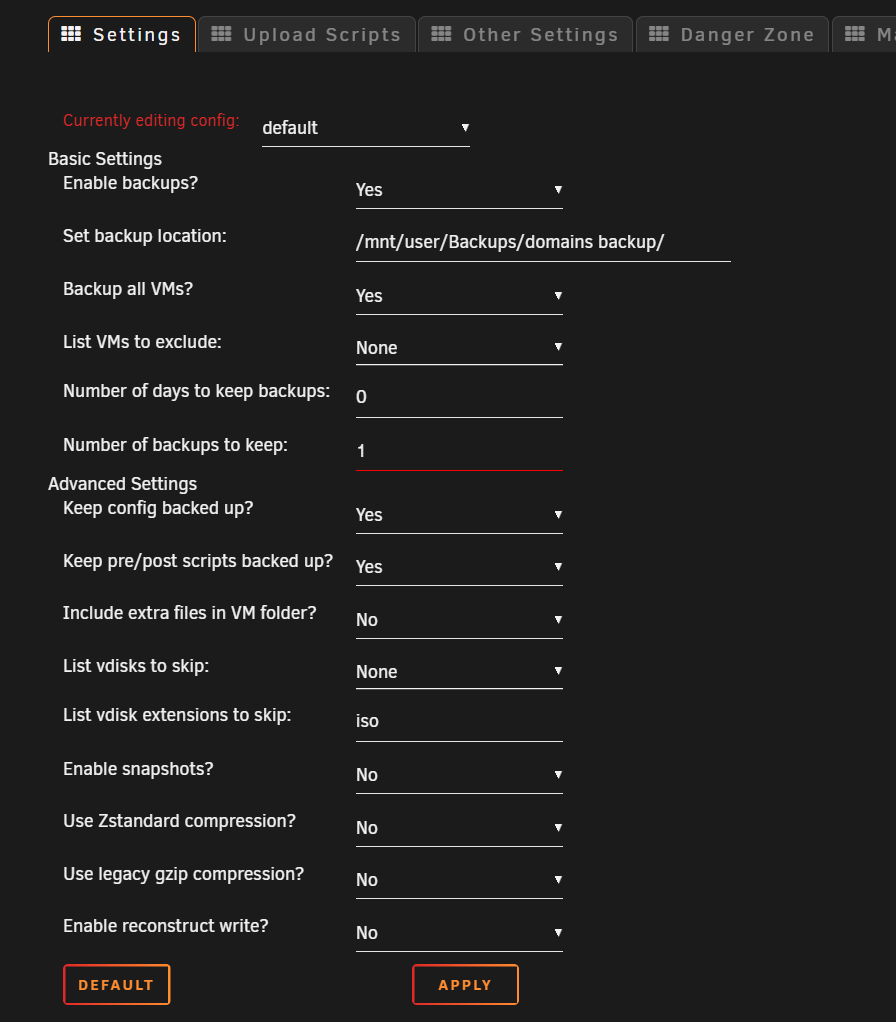

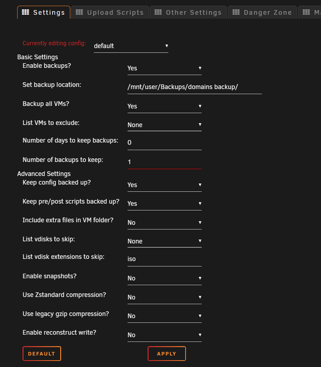

On 1/11/2025 at 4:04 PM, Leaf Fan said:
How do I only keep one backup? If I try an choose one it won't allow it. I have to select two or more.
I have mine set to 1. I believe if you go to Danger Zone and set Disable restrictive validation to Yes it allows it.

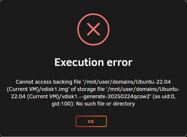

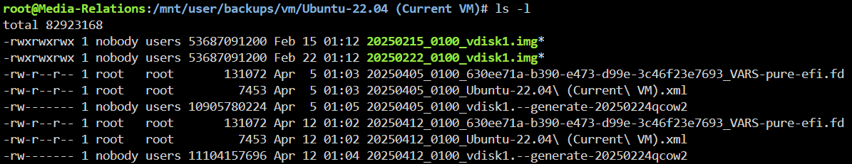

I screwed up over the weekend when making modifications to my cache drive and lost my VM. Thankfully I was running this plugin and have a backup from the previous day. The problem is the script from github throws up an error, and the manual doesn't seem to apply anymore since I'm running Unraid 7.0.1.
My backup files look like this:
I've created a new VM using Custom and copy and pasted the XML info into it per the suggestion by @peewee67 at
Now I'm getting this error when trying to start up the VM:
I'm not sure if this is an issue, but my cache set up was two 4TB btrfs set up as mirror. I changed it to zfs striped so I now have 8TB.
Can someone please help me get my VM back up and running? I would very much appreciate it.

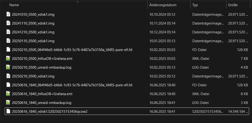

I backuped 2 of my VMs every month, the files are: ...vdisk1.img, ....pure-efi.fd, ....name.xml and the log.
since 2 months (don't know if after an pluginupdate, probably yes) there is no vdisk1.img anymore, just a 20250616_1840_vdisk1.S20250215153456qcow2 but much smaller as the old vdisk1.img which I don't changed.
Could someone tell me what happened?
You've been using snapshots. Once you take a snapshot the base image won't be touched anymore, only the overlaid file will.
This plugin was made way before snapshots were supported in unraid and hasn't been updated since, but at least here it seems to operate "safely" and retaining the desired number of base images, even though at some point anything but the latest is identical and redundant.

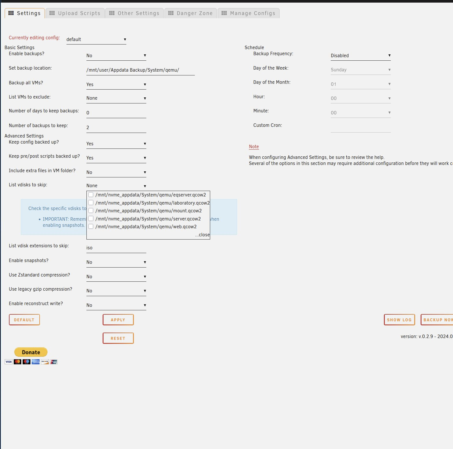

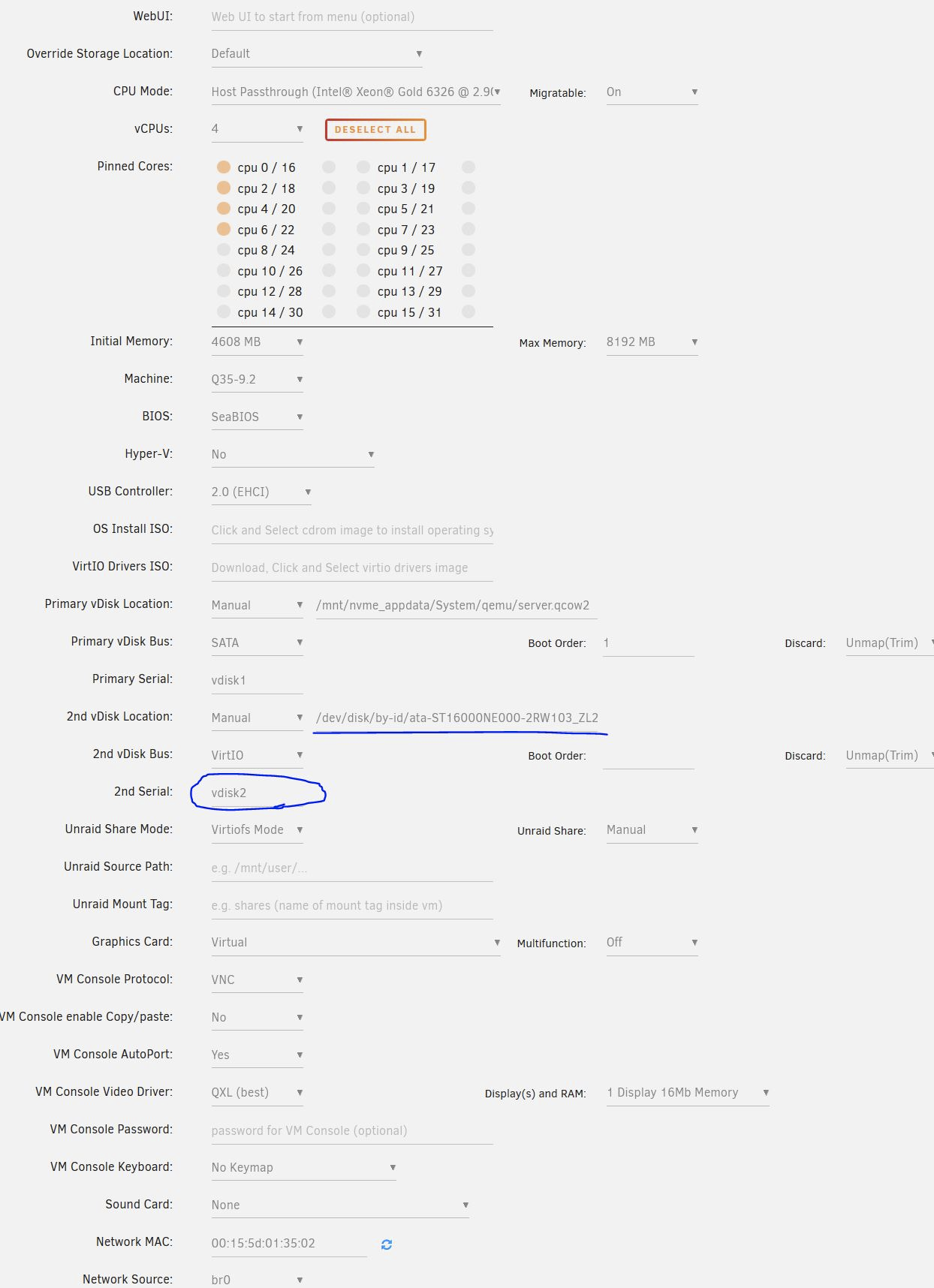

I have questions regarding my usecase,
I want to backup my vms, but one vm has a secondary vdisk mounted that is bypassed in unraid, i DO NOT want this disk to be part of the backup.
Looking at the configuration it seems i can only pick these vdisks that are pointed to a file on disk (qcow2)
But the disk i want to make sure is bypassed is like i said bypassed by unraid and mounted directly to the vm as such:
I have not yet tested the backup solution, but i am wondering if this vdisk2 will automatically be excluded? if no, how can i exclude it?
EDIT: I guess it exlucdes this vdisk with a warning, would be nice to be able to really exclude it though:
2025-10-23 21:35:31 warning: There's an empty vdisk_path on Server. This is mainly caused by an empty cdrom file path. skipping vdisk.
Edited by je82
