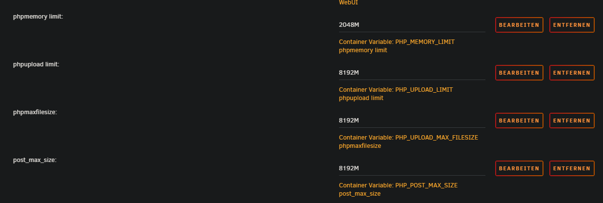

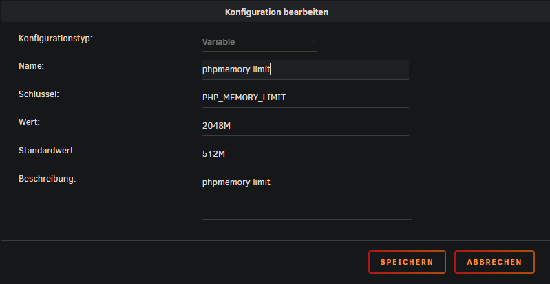

12 hours ago, pumperio.eu said:
Hello What is the process for modifying these specific values in the most recent versions of unRAID and Nextcloud thanks
Version: 8.2.21
Memory limit: 512 MB
Maximum execution time: 3600 seconds
Maximum upload file size: 512 MB
should look something like this:
image.png.8b82ae0ecd7e550fe891ea2aa6a66619.pngimage.thumb.png.42515d021cefad06cebbe09be05ba04e.png

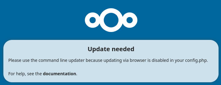

Hi! I need some help... Tried accessing my Nextcloud instance today and found this message:
I checked and there's no update for the docker available. In fact it was updated 4 days ago. I understand I can open the console and update it using the script, but that that's not the best practice. What should I do? Thanks in advance!
Link to comment

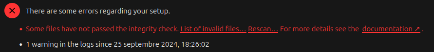

Update: I opened the logs and I see the following:
I never messed with these files manually...
Link to comment
Same issue for me. I have re-downloaded the docker image and started working again
