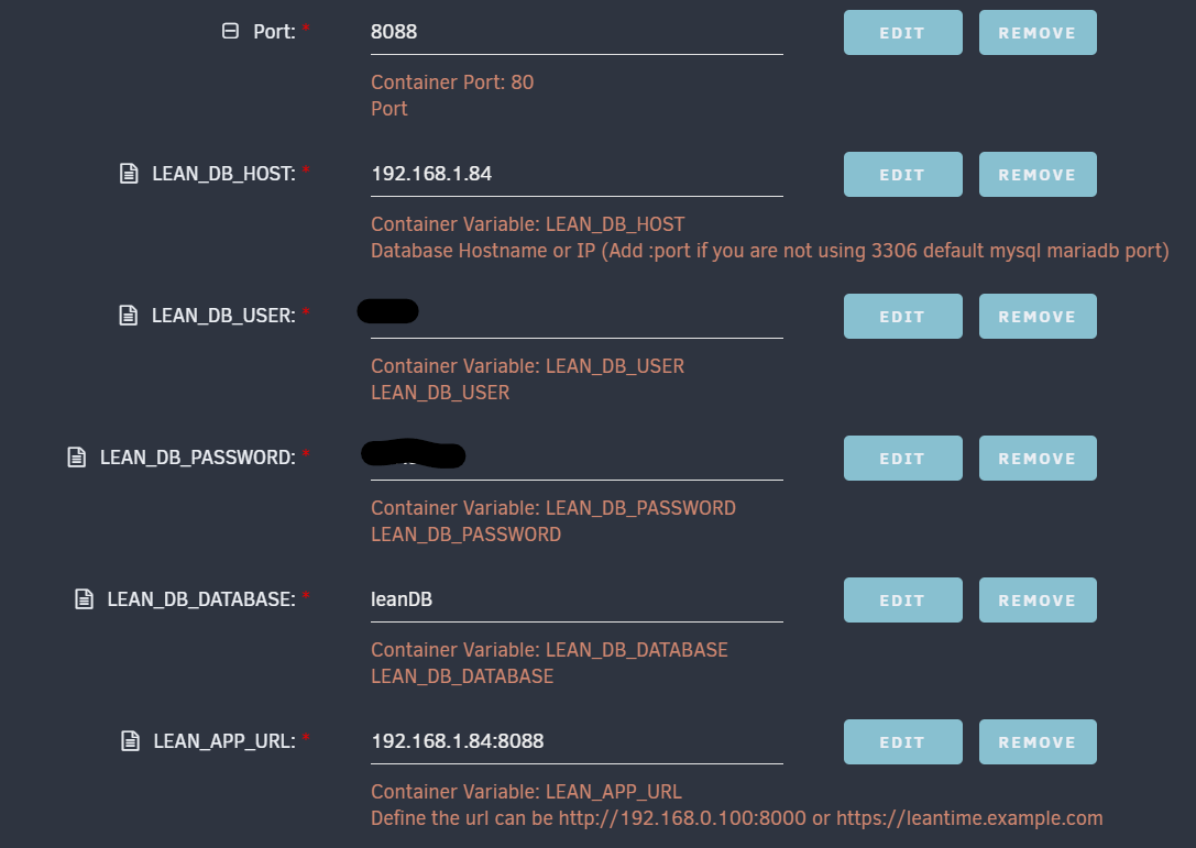

Hi.
I have installed leantime with the CA template. Everything seems to be ok but can't get to installation page and here is how the log for the container looks:
I don't think I'm doing anything wrong in the template:
any suggestions on what could be wrong?

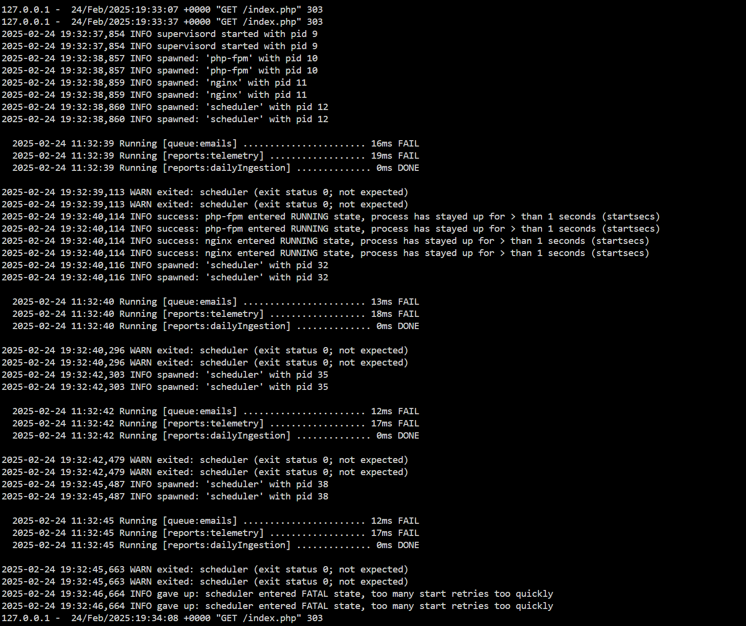

On 2/24/2025 at 8:41 PM, rodmendoza said:
Hi.
I am having the same issue.  The configuration is not being written as the sample.env does not contain the database configuration.  Checking the logs, on my install I see failed to connect to DB and the host IP is the IP of the container not the maria db IP that I put in.  So this container is broken.  Hopefully @A75G can fix it, otherwise it should be pulled out of the app store in my opinion.
Updated https://github.com/A75G/docker-templates/commit/d10779ac63b21bf18f1b295249d9d04566c08915

3 hours ago, A75G said:
I updated but still having the same issue.  The error log shows the container trying to connect to the container IP for the DB.
Container error log:
PDOException: SQLSTATE[HY000] [1045] Access denied for user 'leantime'@'10.
  10.11.71' (using password: YES) in /var/www/html/vendor/laravel/framework/s
  rc/Illuminate/Database/Connectors/Connector.php:66
Docker run command:
docker run
  -d
  --name='gda-leantime-container-nas0'
  --net='br0'
  --ip='10.10.11.71'
  --pids-limit 2048
  -e TZ="America/Los_Angeles"
Docker run command:
docker run
  -d
  --net='br0'
  --ip='10.10.11.71'
  --pids-limit 2048
  -e HOST_OS="Unraid"
  -e HOST_HOSTNAME="ISOT0"
  -e HOST_CONTAINERNAME="gda-leantime-container-nas0"
  -e 'TCP_PORT_80'='8000'
  -e 'LEAN_DB_HOST'='10.10.11.76'
  -e 'LEAN_DB_USER'='leantime'
  -e 'LEAN_DB_PASSWORD'='leantimepass'
  -e 'LEAN_DB_DATABASE'='leantimedb'
  -e 'LEAN_APP_URL'='http://10.10.11.71:8000'
  -l net.unraid.docker.webui='http://[IP]:[PORT:80]/'
  -l net.unraid.docker.icon='https://raw.githubusercontent.com/A75G/docker-templates/master/templates/icons/leantime.png' 'leantime/leantime:latest'
8d02a7103a388ec2e48e81a1b40d272e29906fec1eeb8a01e6389190c5759ba5
The command finished successfully!
I just double checked everything from the start it directly got working.
This appear to be database issue please create new user with full access to a new database.
Can someone help with weechat? I installe it, ran the mnt commands, attached the docker to the terminal and... then? Trying to connect to a server gets me the error "you cannot write text in this buffer" so I'm not sure where to go from here...
Ok I did get it working.  I had to remove the database completely and re-pull it.  Seems like the initial setup for the db name, password, etc, is a one time deal.  Even if you change the template later it wont update including setting the root password.  All good now.  Thanks!
@A75G Actually, to get setup to finish without a 500 error, I had to add variable LEAN_SESSION_SECURE to FALSE.  Recommend adding this to the template.  (For anyone having the 500 error at the end of the install, you need to drop the tables and start the install over again after adding the variable).
Edited by nerbonne
adding info
