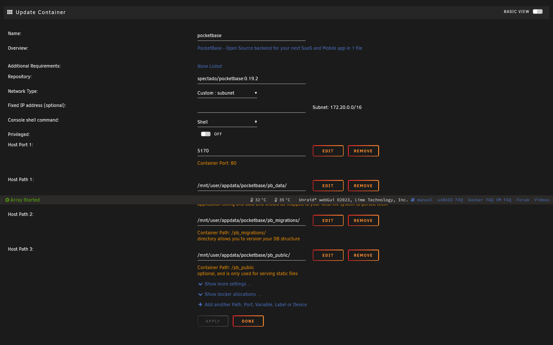

Hello! Thank you for putting together the PocketBase and grimoire containers. I checked this thread and changed the grimoire version to 0.3.1 as you suggested. Login works now.
But Regarding pocketbase’s webui, I can’t seem to be able to access it. I get the following when navigating to it
{"code":404,"message":"Not Found.","data":{}}
even though the container itself is running and the port mapping seems to be correct?
You dont access pocketbase you only access grimoire
pocketbase is only the backend

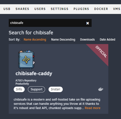

Thanks, but atm in CA the only chibisafe avaiable is the caddy:
Edited by dhstsw
As said, no chibisafe-server container in CA (and, in the while, even the "old" chibisafe template went dark, no traces of it).
There's the one in hub.docker.com, and that's the one i tried to use.
Only that there's no documentation of it (at least, i didn't find one).

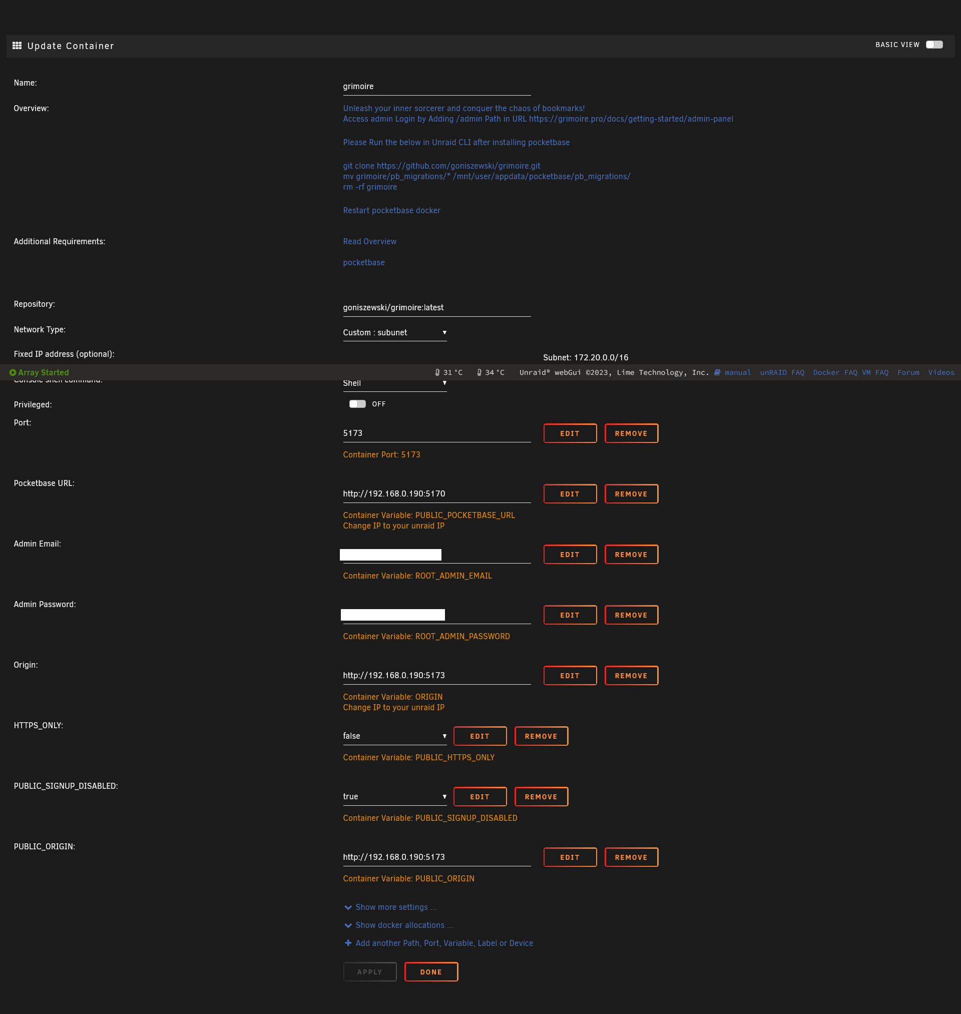

Hey, after some trial and error I have managed to get Girmoire installed and for most parts it works, but none of the icons or images are loading for bookmarks. does anyone know why this might be happening?
I have attached some screenshots to show me issue
Thanks
