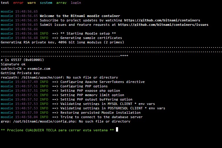

On 2/10/2023 at 5:23 AM, kteach said:
I am trying to install Moodle for my School. Everything seems right, but when I try to run the installed docker this is what I get.
"moodle 21:13:56.29 Welcome to the Bitnami moodle container
moodle 21:13:56.29 Subscribe to project updates by watching https://github.com/bitnami/containers
moodle 21:13:56.29 Submit issues and feature requests at https://github.com/bitnami/containers/issues
moodle 21:13:56.29
moodle 21:13:56.29 INFO  ==> ** Starting Moodle setup **
realpath: /bitnami/apache/conf: No such file or directory
moodle 21:13:56.89 INFO  ==> Configuring Apache ServerTokens directive
moodle 21:13:57.04 INFO  ==> Configuring PHP options
moodle 21:13:57.04 INFO  ==> Setting PHP expose_php option
moodle 21:13:57.17 INFO  ==> Setting PHP memory_limit option
moodle 21:13:57.19 INFO  ==> Validating settings in MYSQL_CLIENT_* env vars
moodle 21:13:57.22 INFO  ==> Validating settings in POSTGRESQL_CLIENT_* env vars
moodle 21:13:57.30 INFO  ==> Restoring persisted Moodle installation
moodle 21:13:57.75 INFO  ==> Trying to connect to the database server
grep: /opt/bitnami/moodle/config.php: No such file or directory"
Any ideas? I have 14 other containers running just fine. Including similar packages, like WordPress. This ... just doesn't run.
I have similar problems. My version system is Unraided v.6.11.5 And I tried with MariaDB and Mysql as database and both produce the same errors. Can somebody help me?

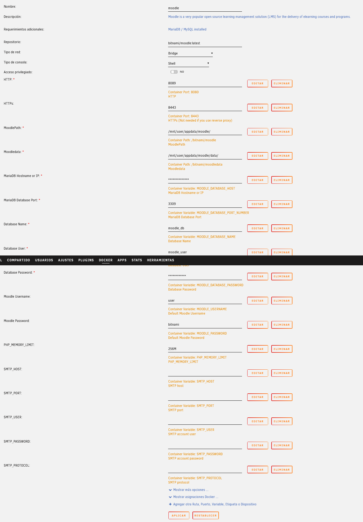

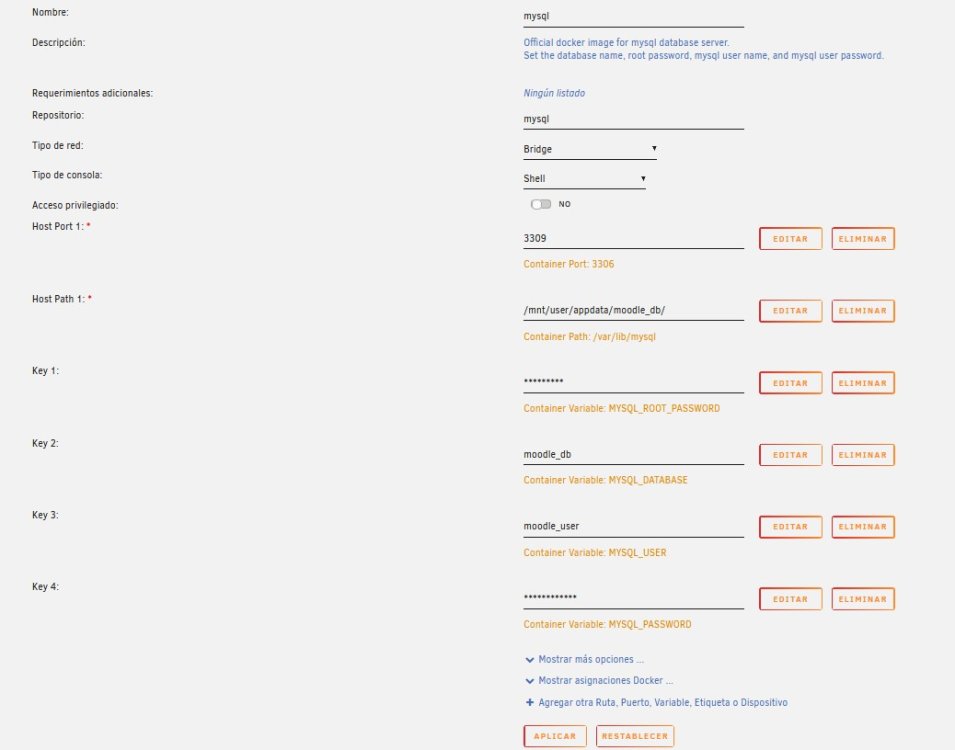

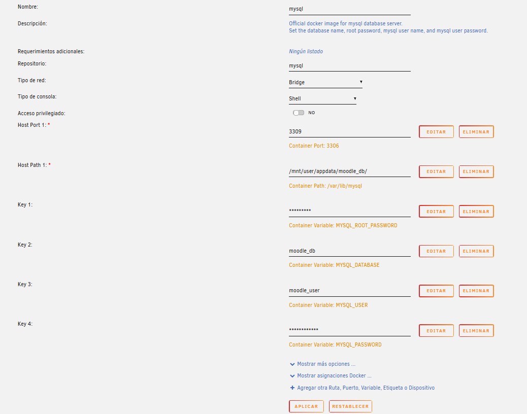

Trying to get Moodle working. Ran into similar issues from previous replies. Followed M1L4's summarized post and got to Moodle instantly shutting down every time. Not seeing solutions on Github either, just couple of folks that supposedly got it running. Not seeing any files in the folder or table in the database created. Could not seem to get rid of this error either.
Unraid Version: 6.11.0
MariaDB
Looks like an easy way to get an LMS running, so any help would be much appreciated! Here is the latest screen grab in logs:

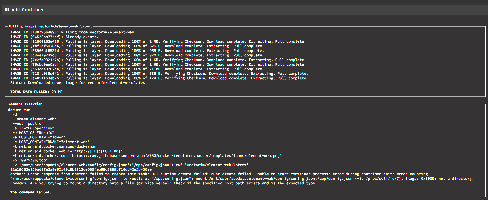

Is the element container broken?
I get this error whenever I try and install it. It worked many months ago but not now.
EDIT: Nvm, I was missing the initial steps to pull the config.json in the description. No idea why they cannot just be added as a step in the docker container...

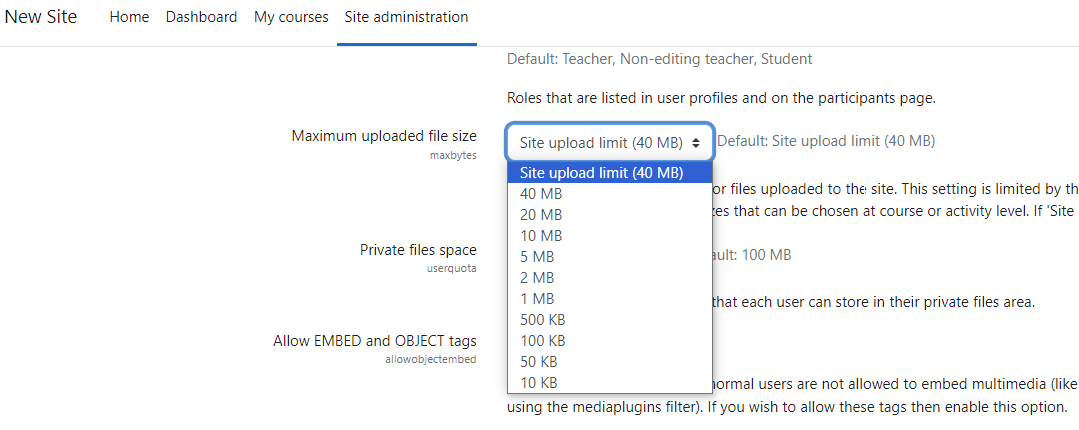

On 10/23/2023 at 12:18 PM, Tolete said:
I have added the variable according to the PHP Configuration to @A75G Template, but the Maximum uploaded file size remains the same.
PHP_UPLOAD_MAX_FILESIZE
Has anyone been able to change/increase the 'Maximum uploaded file size' on Moodle?
Yes I was able to increase upload max file size this morning after scouring everywhere. ChatGPT had the answer and I copy pasted the response lol.
1. You'll need to open terminal in Unraid
2. type in
docker exec -it your_moodle_container_name /bin/bash
(replace your_moodle_container_name with the actual name of your moodle container)
3. Find the Path to php.ini:
Use the php -i command to display the PHP configuration. Look for the "Loaded Configuration File" line to find the path to the php.ini file by typing
php -i | grep "Loaded Configuration File"
Note down the path displayed. It might look like /opt/bitnami/php/etc/php.ini or similar.
Edit php.ini Using sed:
4. Now, use the sed command with the correct path to edit the php.ini file:
bash by typing
sed -i 's/upload_max_filesize = .*/upload_max_filesize = 1G/' /opt/bitnami/php/etc/php.ini
sed -i 's/post_max_size = .*/post_max_size = 1G/' /opt/bitnami/php/etc/php.ini
whereas 40MB was nowhere near enough for the tutorial videos I am uploading I went with 1G instead of the 40MB, please adjust accordingly.
5.Restart the Docker
Test
MariaDB
I have run into this so many times, I have uninstalled, reinstalled and still had issues. then i figured it out.
1. go into your (shared) appdata folders and create a separate folder (expose the appdata to SMB if it's easier, I named my folder moodle-DB).
2. Install Mariadb through the community apps, for testing i made it simple, port 3327, all passwords for the database were 'moodle', then for the appdata folder it points to point it to your newly created 'moodle-DB folder' let it run its course.
3.install moodle from the apps, within the configuration point it to the database using the IP address and it's port, now here's where i kept dropping the ball, within the setup of the path data it is not 'finished' per say the container path shows
/mnt/user/appdata/moodle/path   however the field to fill it out just shows /mnt/user/appdata/moodle/     so i threw in path at the end and it started into installing
4. Check your logs for moodle when it's installing
Also if you have residual folders and files left over from prior installs its a good idea to remove them with the cleanup appdata plugin and remove them entirely and start fresh.
