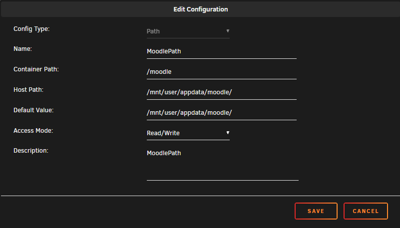

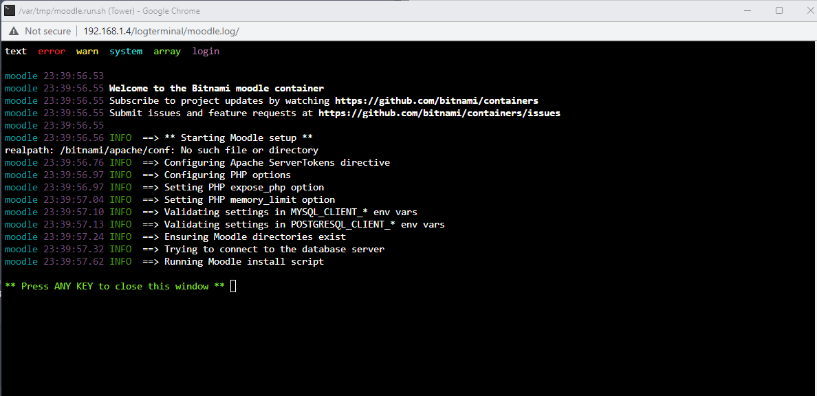

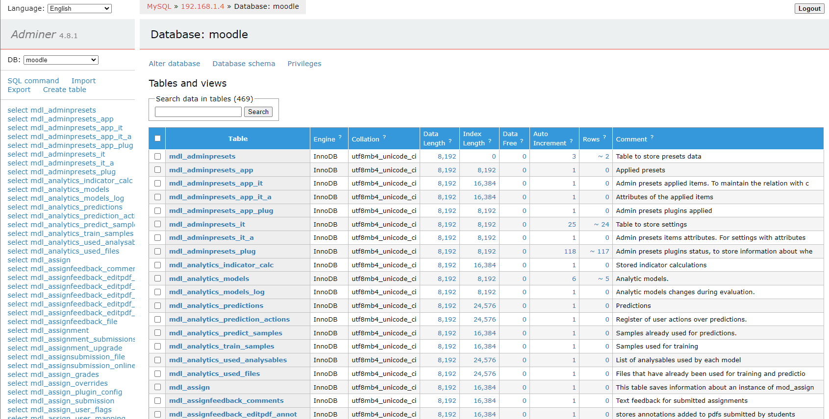

On 11/26/2022 at 11:44 PM, bobalot said:
Actually, it's gone back to not working.
I was able to enter the moodle docker and muck around a bit but after a while it just stops working.
I checked the database via adminer and moodle has created a whole bunch of tables, etc.
If anybody has any idea how to fix this, it would be much appreciated.

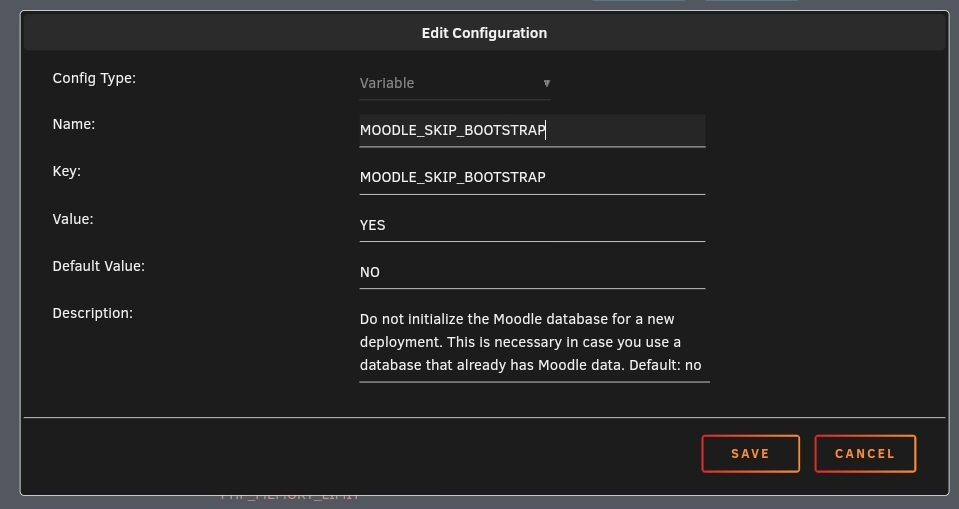

11 hours ago, bobalot said:
Hi all,
I noticed my issues only seems to occur if I disconnect from the database and attempt to reconnect (docker update, server restart, etc).
There also doesn't appear to be any appdata for moodle.
Does anybody have any advice?
I think I worked out a solution.
I had to add the following parameter:
MOODLE_SKIP_BOOTSTRAP with a value of YES
I think docker was trying to initialise a new database every time it loaded up rather than using the existing database it had created.
Edited by bobalot

On 11/26/2022 at 1:22 PM, bobalot said:
I managed to get the docker working. Not really sure why (because I'm a newb).
I changed the containers from:
/bitnami/moodle to /moodle
/bitnami/moodledata to /moodledata
Is it because there was no Data Dir setting (or similar) that set the base container for /bitnami? So the sub containers /bitnami/moodle and /bitnami/moodledata didn't have a valid path?
--2-- And likewise after reboot moodle wouldn't start again:
  • realpath: /bitname/apache/conf: No such file or directory
    Running moodle install Script
--3-- My next step was the addition of the Moodle_skip_bootstrap.
Sidenote: I copied the name from somewhere with a space initally. Make sure you have a clean name^^
And volia - a running system for me as well.
