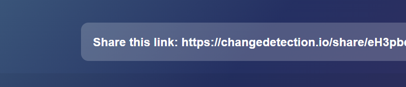

I just ran into an issue with the share watch feature not working in the ChangeDetection.io Docker. I contacted the developer and this is what he said. Does this mean that something with the Unraid version of the container needs to be changed or fixed?
aaah you must have the old docker-compose.yml that had hostname: changedetection.io... it's probably trying to connect to itself.. try removing that line?
https://github.com/dgtlmoon/changedetection.io/discussions/1364#discussioncomment-4815864
Fixed by changed container name to 'changedetection' from 'changedetection.io'
but not sure if https://changedetection.io/share.... or our base URL should be in the link host ...
Edited by Masterwishx
