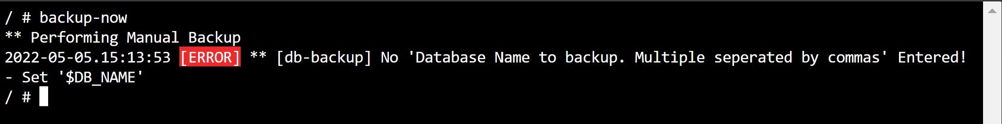

Running "backup-now" manually on Version 3.3.2 db-backup no longer works. It returns a error. Any idea how to manually run backup now?
Try adding DB_NAME variable with each databases you have for example: nextcloud,authelia,freshrss,mysql
Is their not a way to define "all"? (I don't even know names of all the DBs on the MariaDB server it's backing up LOL). I know before version 3.3.2 I was on V2.12.0. On 2.12.0 "backup-now" just grabbed them all. Not sure why that functionality would be depreciated?
(thank you, for the reply!)
okay change it to "ALL" without quotation. i have updated the template
So I will run “backup-now ALL”?
How do I update template on my end?
Edited by blaine07

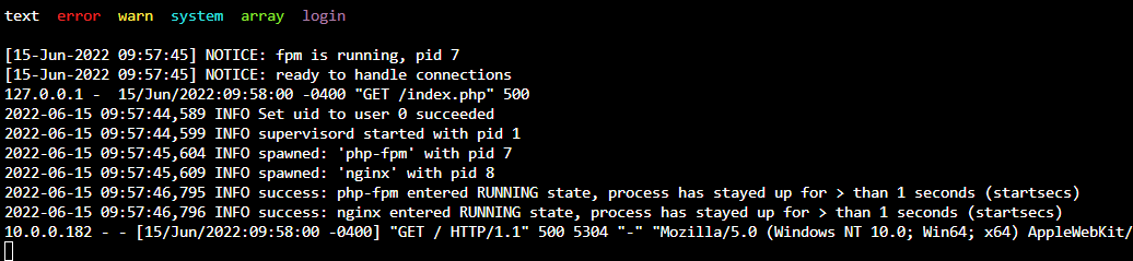

I'm not sure what the heck I am doing wrong but I cannot get LinkAce up and running.
Logs also really don't show much.
Just basic/default config, using MariaDB container, but the database never gets populated w/ any data.
FYI for anyone in the future, I figured this out. i needed to change the /appdata/linkace/logs folder to be RW/RW/RW permissions.
I had to turn on APP_DEBUG=true in the .env to figure this out, but the debug console helped point me to the issue ;)

I ran into this problem and you can fix it by setting the extra parameter option like so:
1813939246_ScreenShot2022-06-27at8_09_49AM.thumb.png.b7fd13dced1d6b6ebc2aed890f51d2ce.png
(If you do not see this option you will have to toggle Advanced View on the top right.)

Hello, I've got two instances of the phpbb docker containers running and both seem to have the same issue.  I get a 500 error when trying to load the websites.  Any ideas on what's going on would be helpful.
This is the information from, the error log:
text  error  warn  system  array  login
phpbb 10:51:44.68
phpbb 10:51:44.68 Welcome to the Bitnami phpbb container
phpbb 10:51:44.68 Subscribe to project updates by watching https://github.com/bitnami/bitnami-docker-phpbb
phpbb 10:51:44.68 Submit issues and feature requests at https://github.com/bitnami/bitnami-docker-phpbb/issues
phpbb 10:51:44.68
phpbb 10:51:44.69 INFO  ==> ** Starting phpBB setup **
realpath: /bitnami/apache/conf: No such file or directory
phpbb 10:51:44.71 INFO  ==> Configuring Apache ServerTokens directive
phpbb 10:51:44.72 INFO  ==> Configuring PHP options
phpbb 10:51:44.72 INFO  ==> Setting PHP expose_php option
phpbb 10:51:44.73 INFO  ==> Setting PHP memory_limit option
phpbb 10:51:44.74 INFO  ==> Validating settings in MYSQL_CLIENT_* env vars
phpbb 10:51:44.80 INFO  ==> Restoring persisted phpBB installation
phpbb 10:51:44.90 INFO  ==> Upgrading database schema
phpbb 10:51:45.28 INFO  ==> Removing installation files
phpbb 10:51:45.28 INFO  ==> ** phpBB setup finished! **
phpbb 10:51:45.29 INFO  ==> ** Starting Apache **
[Sun Jul 03 10:51:45.359919 2022] [ssl:warn] [pid 1] AH01909: www.example.com:8443:0 server certificate does NOT include an ID which matches the server name
[Sun Jul 03 10:51:45.360151 2022] [ssl:warn] [pid 1] AH01909: www.example.com:443:0 server certificate does NOT include an ID which matches the server name
[Sun Jul 03 10:51:45.382371 2022] [ssl:warn] [pid 1] AH01909: www.example.com:8443:0 server certificate does NOT include an ID which matches the server name
[Sun Jul 03 10:51:45.382614 2022] [ssl:warn] [pid 1] AH01909: www.example.com:443:0 server certificate does NOT include an ID which matches the server name
[Sun Jul 03 10:51:45.392341 2022] [mpm_prefork:notice] [pid 1] AH00163: Apache/2.4.54 (Unix) OpenSSL/1.1.1n configured -- resuming normal operations
[Sun Jul 03 10:51:45.392359 2022] [core:notice] [pid 1] AH00094: Command line: '/opt/bitnami/apache/bin/httpd -f /opt/bitnami/apache/conf/httpd.conf -D FOREGROUND'
[Sun Jul 03 10:51:49.228038 2022] [php:error] [pid 169] [client removed] PHP Fatal error:  Uncaught Twig\\Error\\LoaderError: Unable to find template "cron.html" (looked into: /bitnami/phpbb/styles/prosilver/template, /bitnami/phpbb/styles/prosilver/theme, /bitnami/phpbb/styles/all/template). in /opt/bitnami/phpbb/vendor/twig/twig/src/Loader/FilesystemLoader.php:250\nStack trace:\n#0 /opt/bitnami/phpbb/phpbb/template/twig/loader.php(135): Twig\\Loader\\FilesystemLoader->findTemplate()\n#1 /opt/bitnami/phpbb/vendor/twig/twig/src/Loader/FilesystemLoader.php(150): phpbb\\template\\twig\\loader->findTemplate()\n#2 /opt/bitnami/phpbb/vendor/twig/twig/src/Environment.php(299): Twig\\Loader\\FilesystemLoader->getCacheKey()\n#3 /opt/bitnami/phpbb/vendor/twig/twig/src/Environment.php(381): Twig\\Environment->getTemplateClass()\n#4 /opt/bitnami/phpbb/phpbb/template/twig/environment.php(277): Twig\\Environment->loadTemplate()\n#5 /opt/bitnami/phpbb/vendor/twig/twig/src/Environment.php(359): phpbb\\template\\twig\\environment->loadTemplate()\n#6 /opt/bitnami/phpbb/vendor/twig/twig/src/Environment.php(318): Twig\\Environment->load()\n#7 /opt/bitnami/phpbb/phpbb/template/twig/environment.php(224): Twig\\Environment->render()\n#8 /opt/bitnami/phpbb/phpbb/template/twig/environment.php(186): phpbb\\template\\twig\\environment->display_with_assets()\n#9 /opt/bitnami/phpbb/phpbb/template/twig/twig.php(335): phpbb\\template\\twig\\environment->render()\n#10 /opt/bitnami/phpbb/phpbb/cron/task/wrapper.php(129): phpbb\\template\\twig\\twig->assign_display()\n#11 /opt/bitnami/phpbb/phpbb/controller/helper.php(366): phpbb\\cron\\task\\wrapper->get_html_tag()\n#12 /opt/bitnami/phpbb/phpbb/controller/helper.php(315): phpbb\\controller\\helper->set_cron_task()\n#13 /opt/bitnami/phpbb/includes/functions.php(4276): phpbb\\controller\\helper->display_footer()\n#14 /opt/bitnami/phpbb/index.php(253): page_footer()\n#15 {main}\n  thrown in /opt/bitnami/phpbb/vendor/twig/twig/src/Loader/FilesystemLoader.php on line 250, referer: removed
 [OK] The database update was successful.
removed - - [03/Jul/2022:10:51:48 -0700] "GET / HTTP/1.1" 500 -
