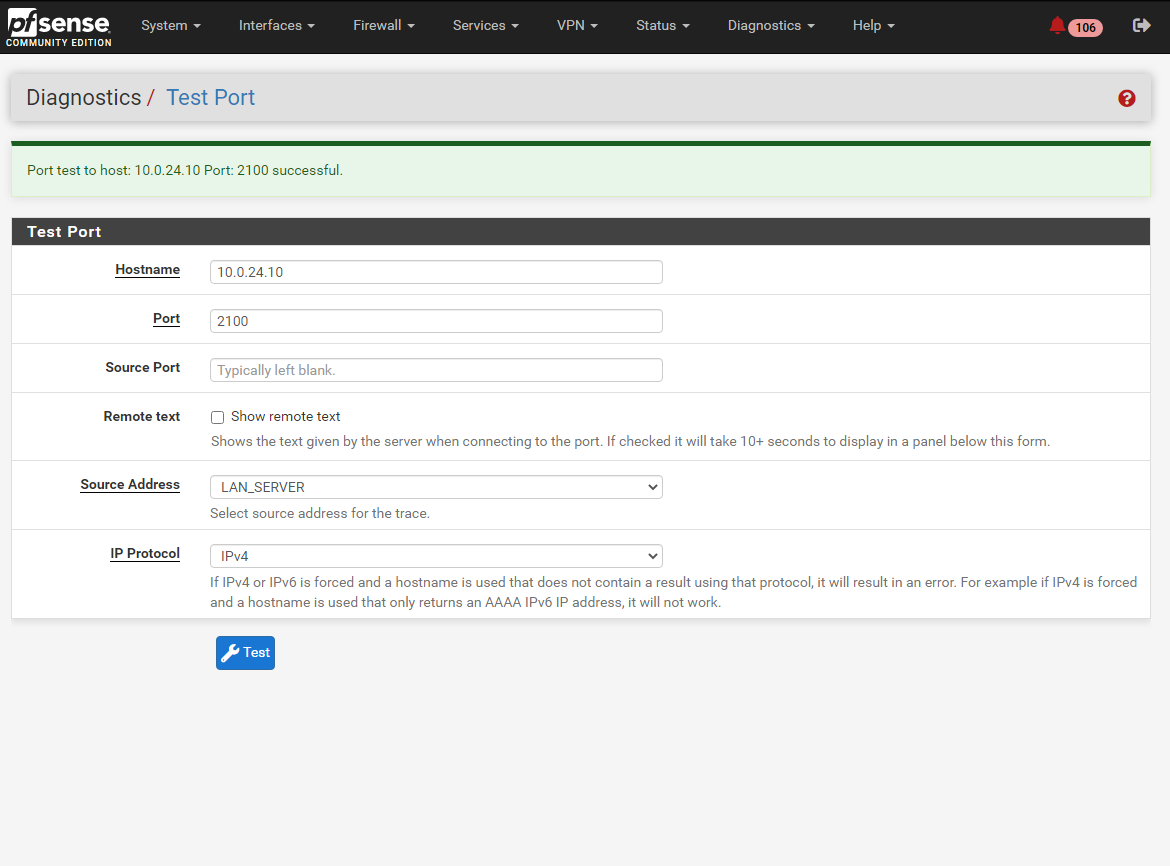

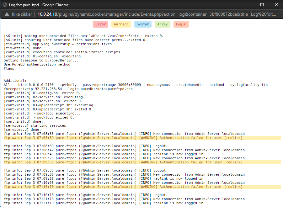

Can  anyone help me with pure-ftpd?
I ge this when I login from WinSCP:
My logs:
Testet ports from pfSense, 2100 works, but I get "Connection failed." for all passive ports 30000-30009.
There is nothing blocking in pfsense, so it must be in the docker or in UnRAID?
