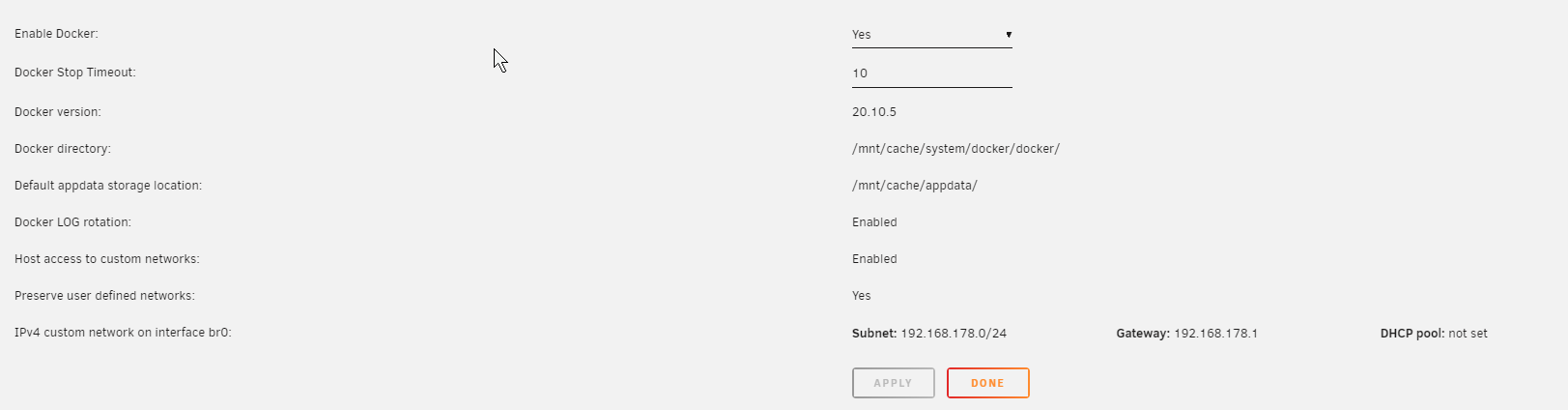

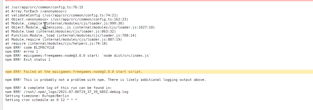

Hey, any problems with epicgaems-freegames?
I run it with docker directory settings.
Folders are empty and log cant install NPM:

Can you help me in this matter?
Best regards, Phil
