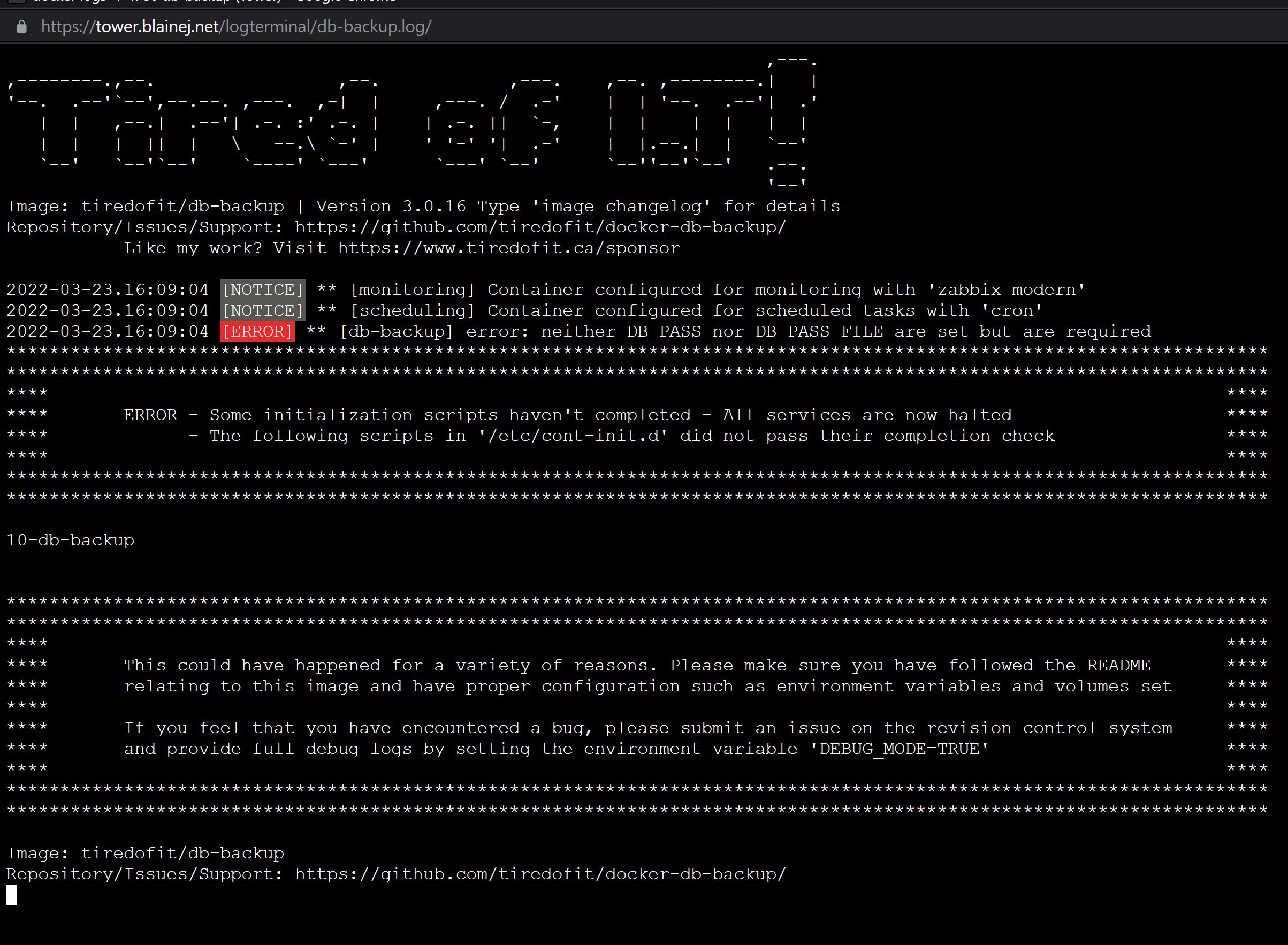

db-backup been dicy lately. I am guessing they're making changes on github side?
I downgraded to 2.12.0 and normalcy has resumed.
Particular DB I am backing up doesn't have a password but this is what was in logs, if anyone has any ideas?:

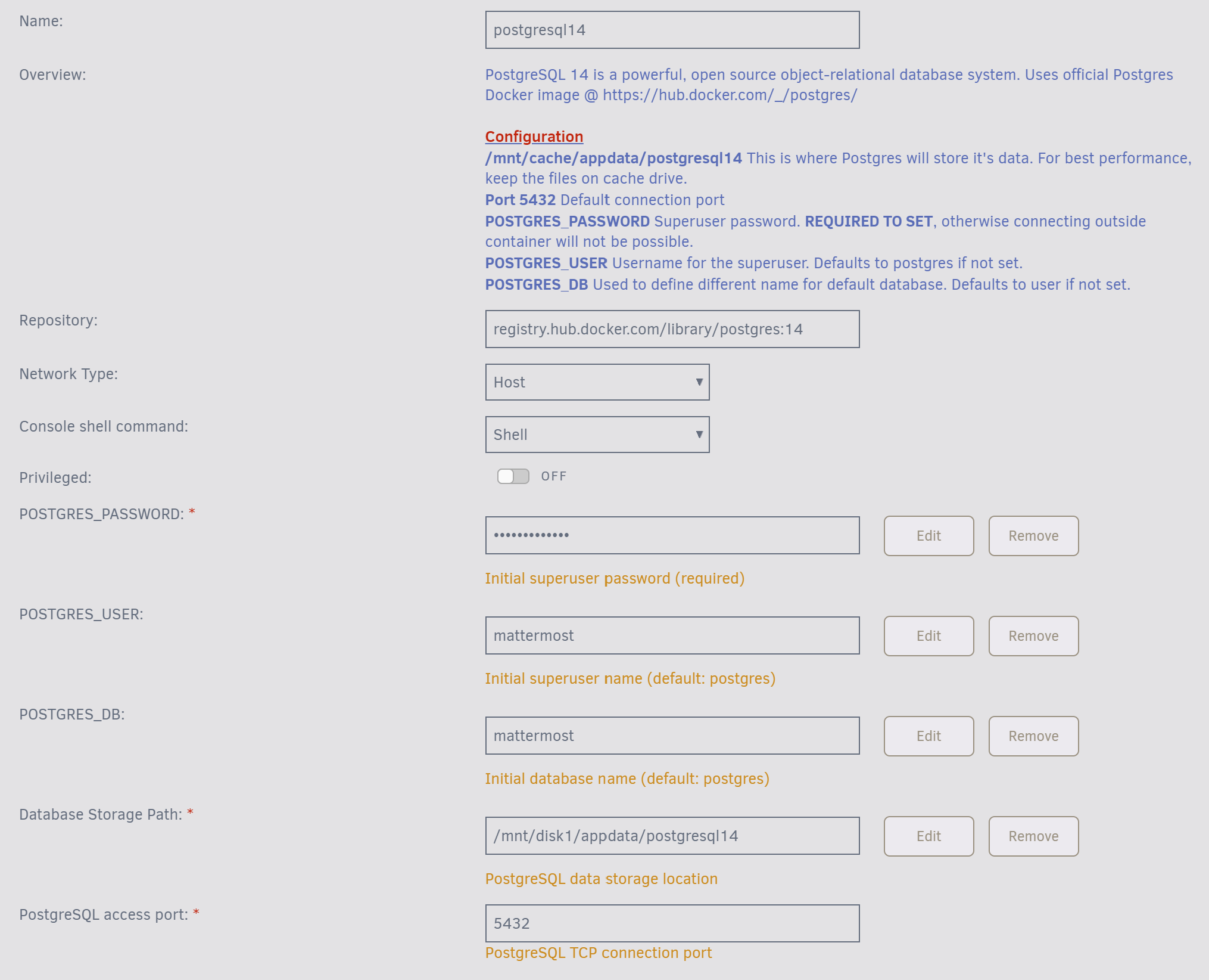

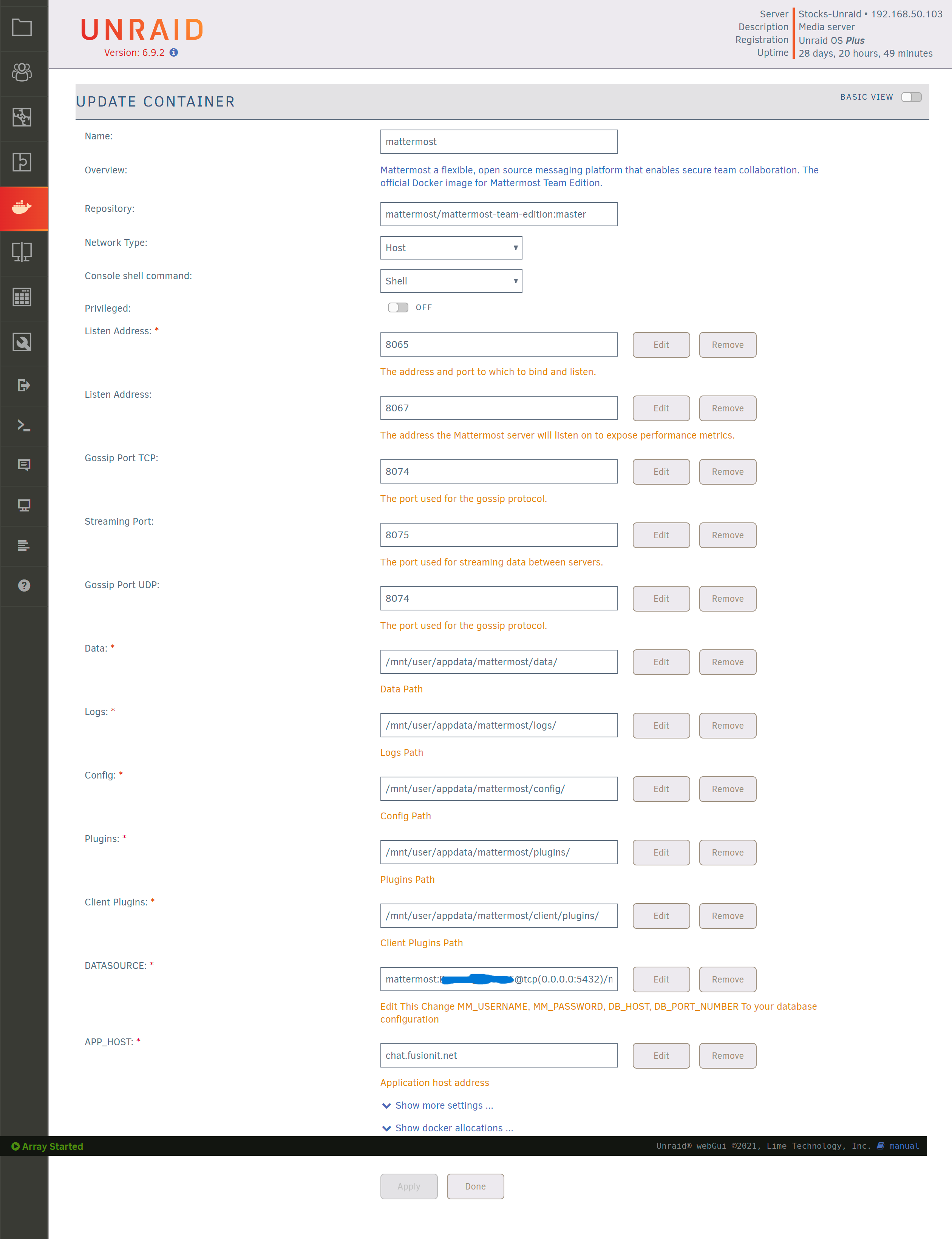

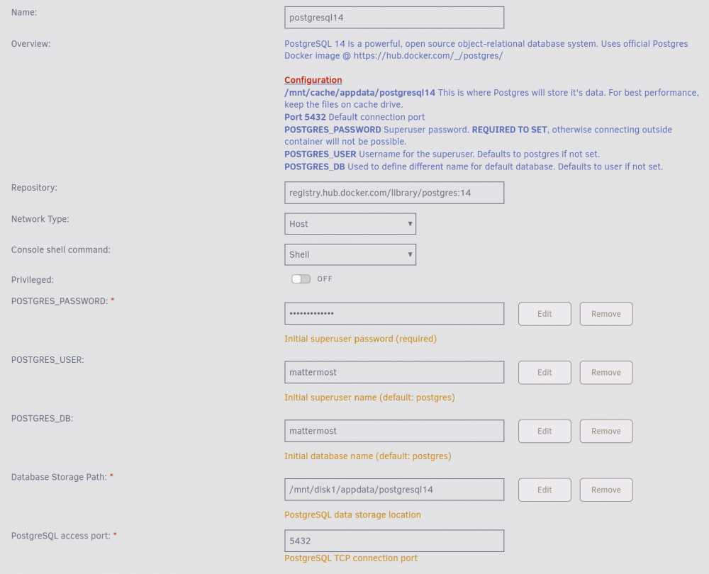

Has anyone successfully installed the Mattermost docker? If so I need some guidance. I can not get the database to connect. Im sure Im just missing something glaringly obvious. Here are my setups:
Postgresql Config:
Mattermost Config:
Mattermost DATASOURCE Line:
mattermost:myPassword@tcp(192.168.50.103:5432)/mattermost?charset=utf8mb4,utf8&readTimeout=30s&writeTimeout=30s
Mattermost log error:
{"timestamp":"2022-03-26 13:15:00.358 -04:00","level":"error","msg":"Failed to ping DB","caller":"sqlstore/store.go:228","error":"context deadline exceeded","retrying in seconds":10}
Any help would be greatly appreciated!
Postgresql Config:
Mattermost Config:
Run with postgresql14
postgres://USERNAME:USERPASSWORD@[DBIP]:DBPORT/DBNAME?sslmode=disable&connect_timeout=10
it avalible for me in  http://10.10.10.2:8065/
Check log as i remember after connection i get error win config and change owner and group
in postgres db
psql -U postgres
CREATE USER 'user' WITH PASSWORD 'Password';
CREATE DATABASE 'DBNAME' TEMPLATE template0 ENCODING 'UNICODE';
ALTER DATABASE 'DBNAME 'OWNER TO 'user';
GRANT ALL PRIVILEGES ON DATABASE 'DBNAME' TO 'user';
Edited by Cemion

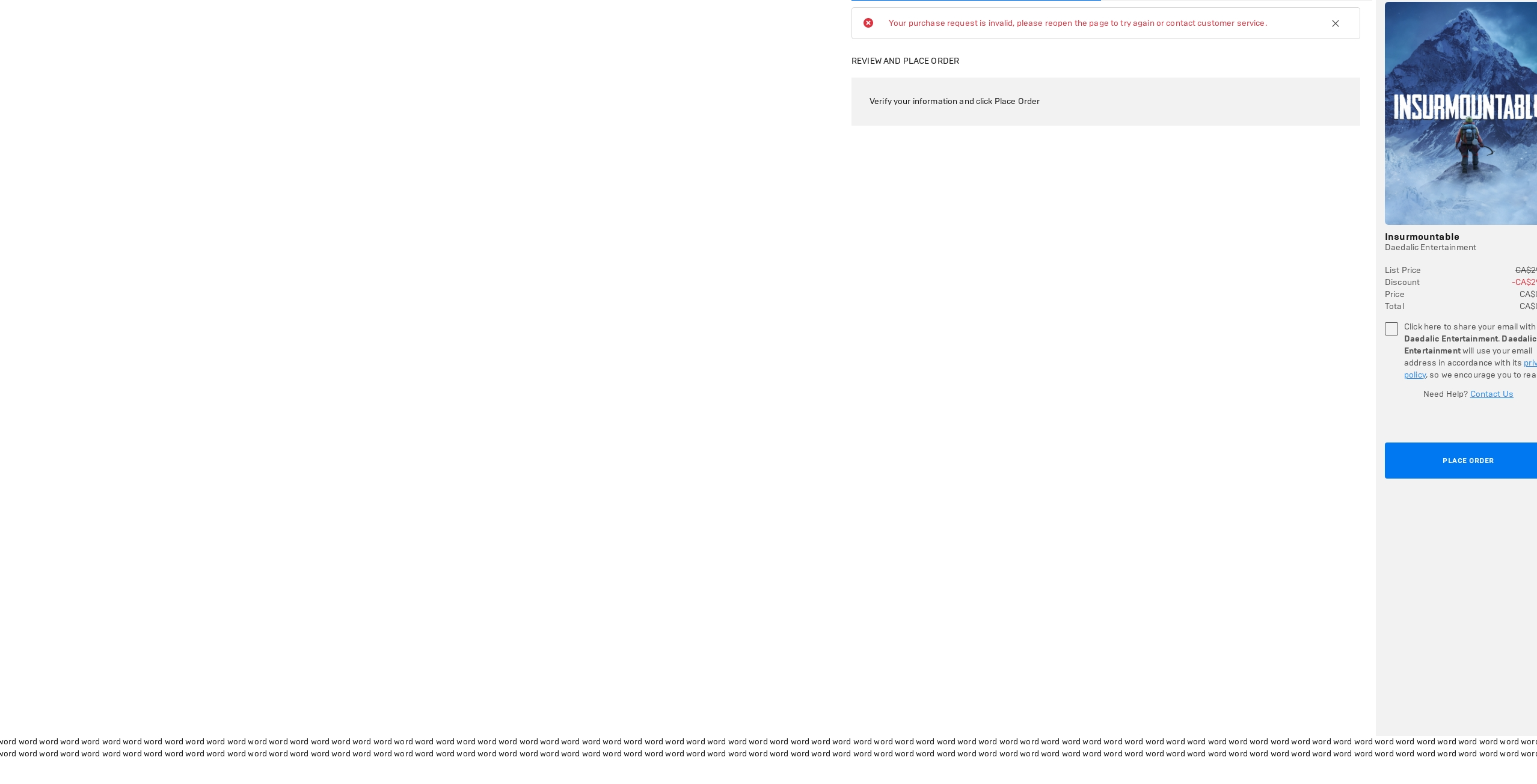

Good Day,
I have been using this for a epicgames-freegames for a while but run into the error bellow and tried reinstalling and yet this error keep coming up.
HAs any one else seen this, if so were you able to resolve it?
Thanks for any help.
Will
