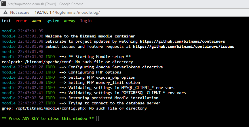

Hi all,
I have recently added this docker and it doesn't start.
I keep getting this error:
grep: /opt/bitnami/moodle/config.php: No such file or directory

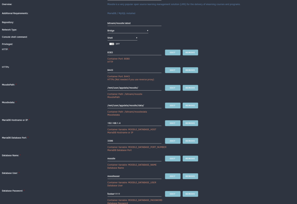

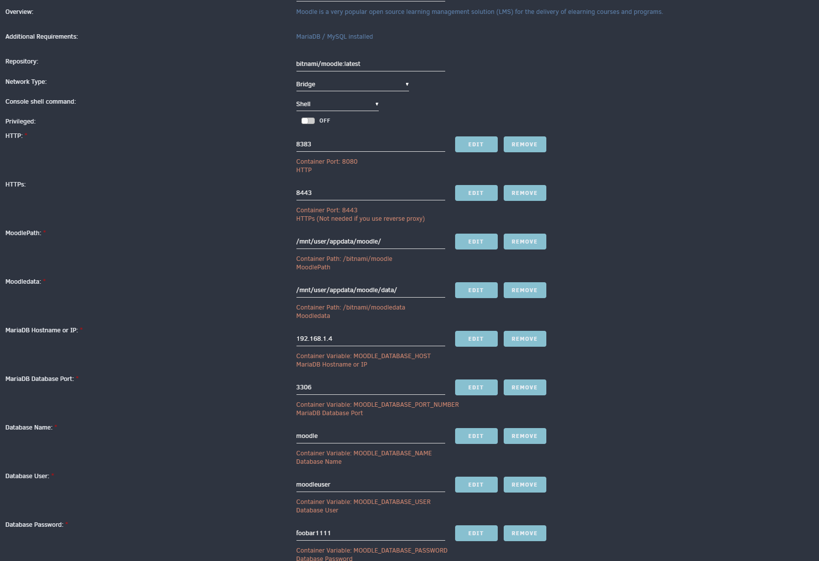

This is my setup:
The MariaDB address and port is definitely correct.
I changed the HTTP port (as it is being used by another docker)

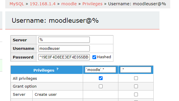

Via Adminer:
I created a database called "moodle" (utfmb4_unicode_ci)
A user called "moodleuser" with a foobar1111 (which I will change after this is resolved!)
But I keep getting the error:
I dropped the database and user and tried it again (hence the non-default names) and it won't work.
What I have done wrong? I can't work it out.

I managed to get the docker working. Not really sure why (because I'm a newb).
I changed the containers from:
/bitnami/moodle to /moodle
/bitnami/moodledata to /moodledata
Is it because there was no Data Dir setting (or similar) that set the base container for /bitnami? So the sub containers /bitnami/moodle and /bitnami/moodledata didn't have a valid path?
Actually, it's gone back to not working.
I was able to enter the moodle docker and muck around a bit but after a while it just stops working.
I checked the database via adminer and moodle has created a whole bunch of tables, etc.
