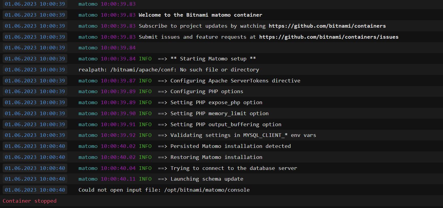

Have error in Matomo .
After updated to latest version i cant start conainer , maybe also after Mariadb update , not sure ....
Maybe someone had this issue ?
