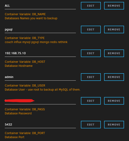

I need some help with the db-backup container...
Backups of MySQL server in separate container work fine. Instance for Postgres fails. Postgres logs say:
2023-11-21 03:00:00.852 EST [535] FATAL: password authentication failed for user "dbbackup"
2023-11-21 03:00:00.852 EST [535] DETAIL: Role "dbbackup" does not exist. Connection matched pg_hba.conf line 100: "host all all all scram-sha-256"
2023-11-21 03:00:00.872 EST [536] FATAL: database "admin" does not exist
But DB_NAME and DB_USER are not set to be admin or dbbackup. So where is it getting that from?
The login credentials the container has are correct and work fine to log in via Adminer.
If I run backup-now in the container terminal, I get this:
psql: error: connection to server at "192.168.75.10", port 5432 failed: FATAL: database "admin" does not exist
Are the keys in the template wrong for postgreSQL?
Manual run with debug mode on shows this as the command sent:
psql -h 192.168.75.10 -U admin -p 5432 -d admin -c 'COPY (SELECT datname FROM pg_database WHERE datistemplate = false) TO STDOUT;'
Looks like it's set the port number as the password (unless -p is for port?) and the username (admin) as the database name?
Here are my settings. It looks correct, but it doesn't seem the variables are being parsed correctly for postgresql.
284702833-dd82b459-a4f7-439a-81f1-87b762a52473.png.9b6e3325266a28d314511ecbaf8d897d.png
Tried it all on a different unRAID server. Same error. It comes back saying database "-DB_USER-" does not exist.
There is something broken in how the query is parsed from the container variables. They don't work the same from mysql to pgsql.
Other than the above issues...I am also seeing a lot of deprecation warnings and the keys for the template don't match the keys spec'ed on the github page for db-backup.

Follow-up to my previous post.
I tried changing the key names in the template to better match what's shown on the db-backup github page. That got rid of some of the deprecation warnings, but it still mishandles and shuffles the values when the script runs as in my first attempts.
From what I see on the github page, it also seems like you can back up more than one type of database (or multiple instances of the same type) from one container instance by prefixing the key names with DB01, DB02, etc. It'd be great if this functionality could carry through with the unRAID template.
I wonder if this template was initially only meant to work with MySQL/MariaDB and therefore never tested with PostgreSQL.

Finally got this sorted. Changed all the keys in the template to match the repo and then added DB01_AUTHDB key for the postgresql backup to work. The postgresql dump wants there to be a db with the same name as the user, so the extra key is needed.

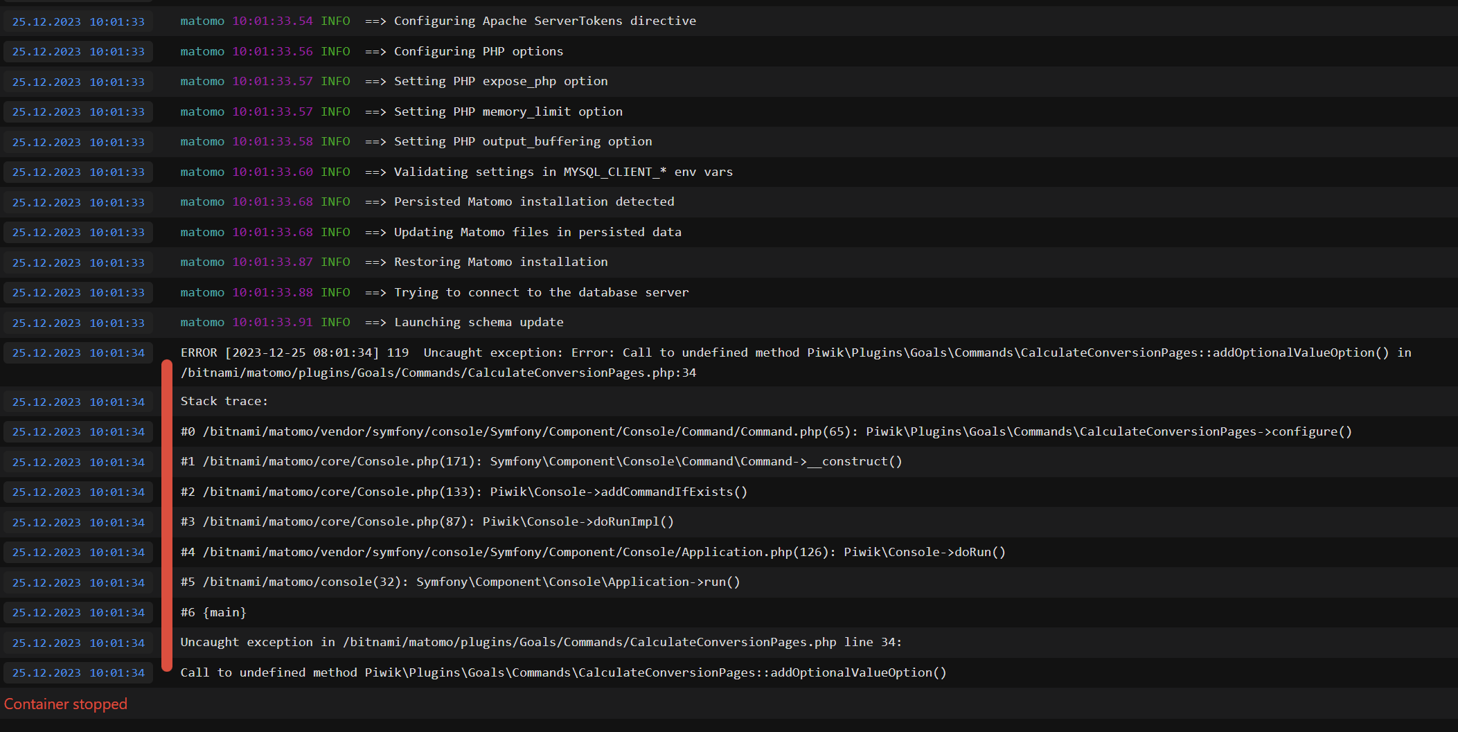

After last update Matomo can't start container :
Fixed by restored from Backup, the problem becose updated from App to v5.0

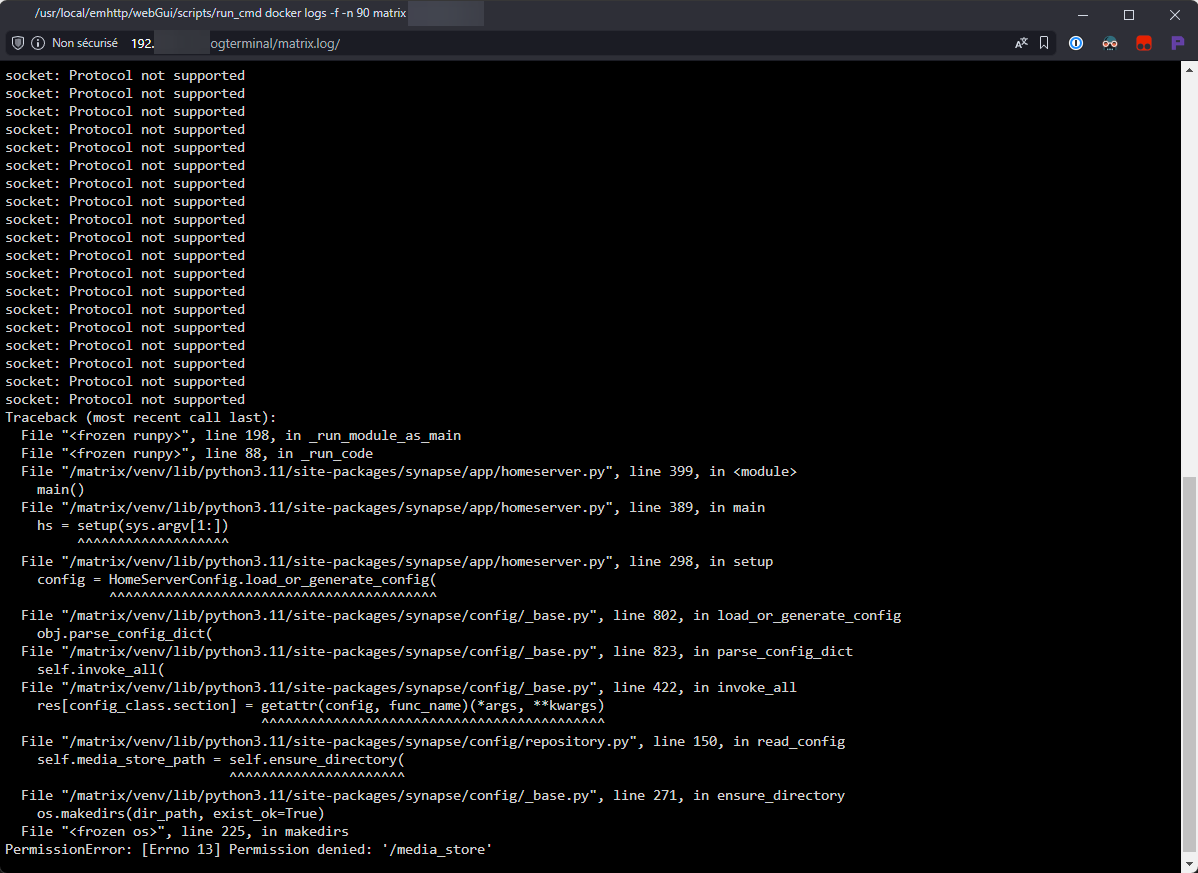

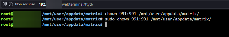

Hello, I don't understand why I have this because I leave everything by default and I correctly placed the command:
chown 991:991
