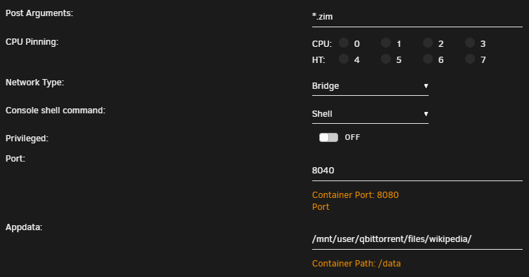

Quick Kiwix-serve question (please pardon the ignorance of a docker beginner):
By default, the config dumps the zim downloads into appdata -- in many cases an SSD cache drive of limited capacity. Are there environment variables that can be set to separate appdata (to go on the SSD cache) and the rather large zim riles (I'd love to create a separate share to store them).
Thanks!
-J
Just change the appdata path, there's nothing but the zim's stored there anyway.
I don't use the built-in download function, I download them using BT and have post arguments set to take any zim in there.
