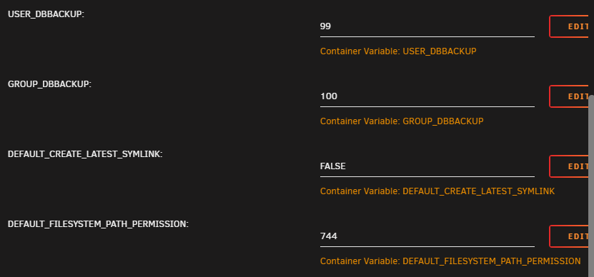

db-backup. The files it creates are
-rw------- 1 10000 10000  19203997 Jan 15 20:24 pgsql_nextclouddb_192.168.11.54_20240115-202405.sql.gz
owner: rw, group: nothing, everyone: nothing
how would I change this so a different docker can read the files and copy them to an external backup drive? chmod 777 those files?

Look at the doc of the container and add the user/group/permission variables.
Perfect, thanks! Found that over at the tiredofit github docs
Added this VARIABLE: DEFAULT_FILESYSTEM_PATH_PERMISSION, as 0755, that should do the trick! thanks again
