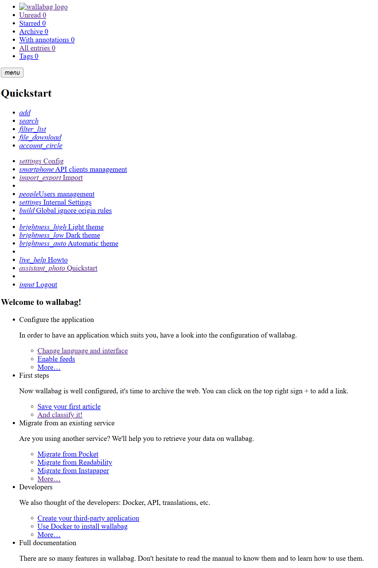

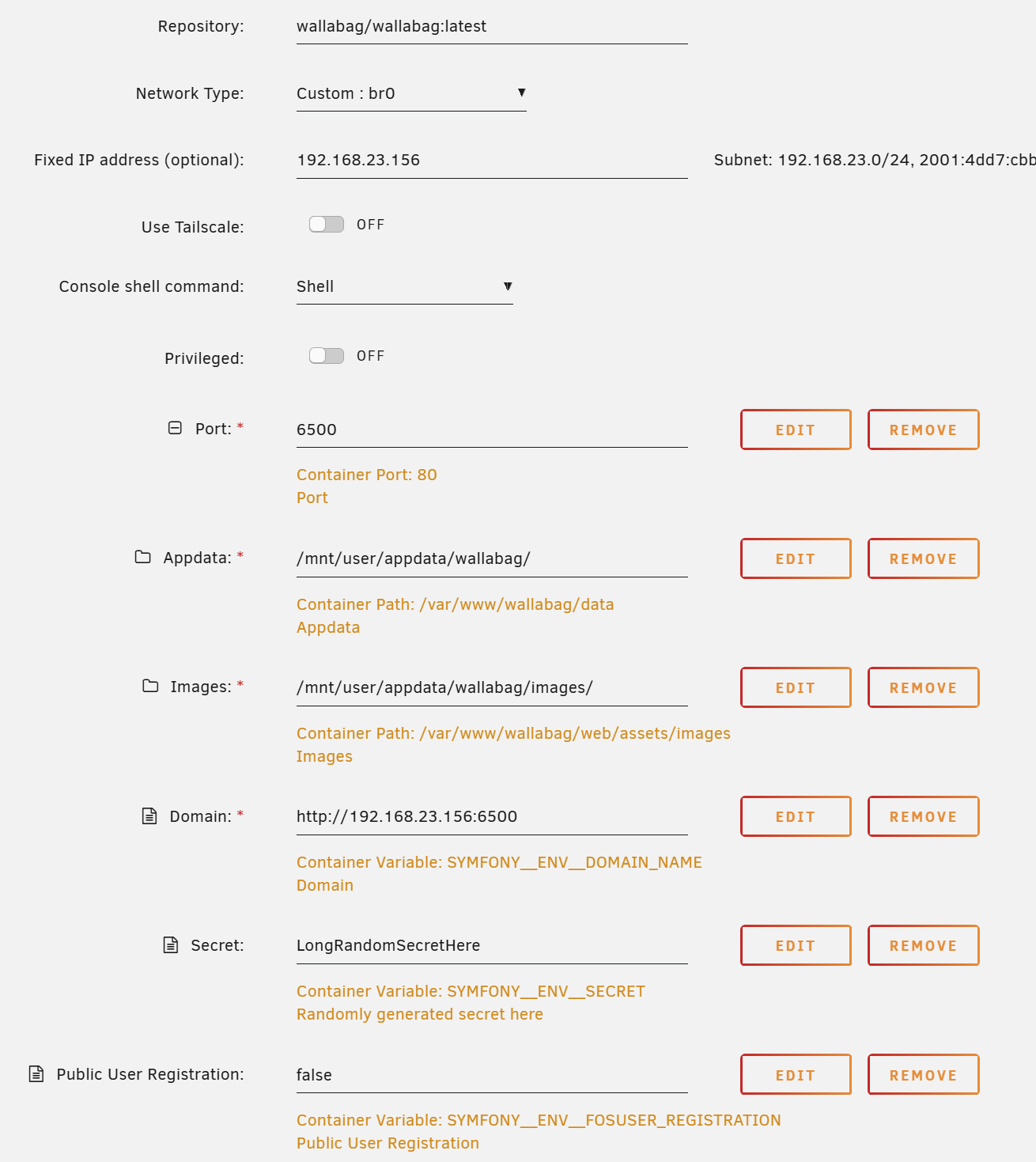

I have installed wallabag on unraid server. When I start wallabag I have the WebUI as shown:
Installed with the following parameters:
I have already removed docker app, deleted all files and re-installed: same error.
Any hints?

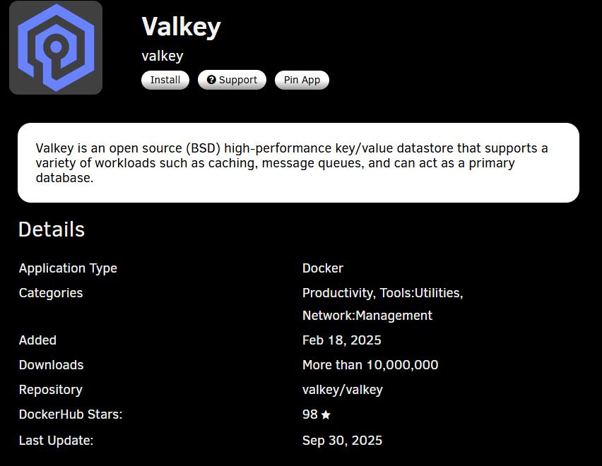

As I've been monitoring this.
https://www.reddit.com/r/immich/comments/1k6mo49/regarding_valkeys_redisimage/
I recommend moving off bitnami reddis and into valkey open-source reds
https://valkey.io/topics/migration/
Edited by bmartino1

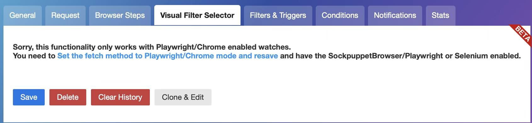

Hello,
I would like to use the visual selection from "Changedetection.io".
Do you have a tutorial how to setup?
