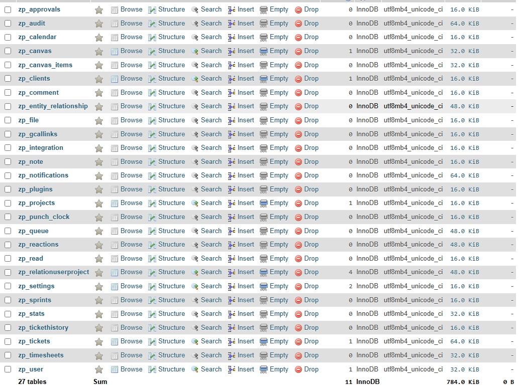

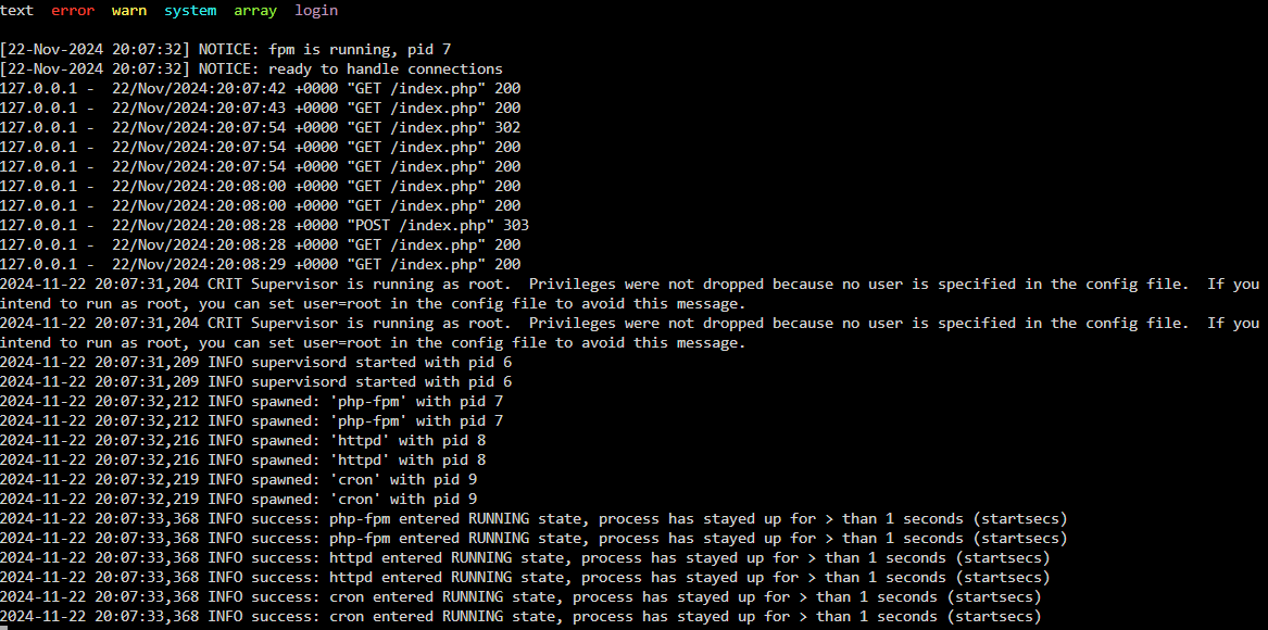

I'm on the install page I enter the information to create the admin account and it just loops back to the same install credential page over and over.  It does connect to the DB (MariaDB-Official) but even on the login page, it will just loop back to the login page with no error being shown other than in the root and index bug in the logs.
anyway to get this working?
Edited by Raykai
