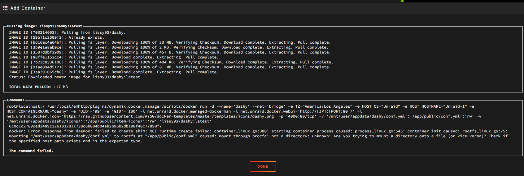

Hello, have some issues with your Dashy Docker package.
I recently had Dashy installed as a Docker container and all was well. I messed with it for a couple of days until it was all dorked up. I then decided to start over and remove it and the re-install it. Now, every time I try to install it, I get this error:
docker: Error response from daemon: failed to create shim: OCI runtime create failed: container_linux.go:380: starting container process caused: process_linux.go:545: container init caused: rootfs_linux.go:75: mounting "/mnt/user/appdata/dashy/conf.yml" to rootfs at "/app/public/conf.yml" caused: mount through procfd: not a directory: unknown: Are you trying to mount a directory onto a file (or vice-versa)? Check if the specified host path exists and is the expected type.
I have tried uninstalling Dashy from APPS, open the GUI file manager and deleted user/apppdata/dashy, and I even installed Appdate Cleanup and ran it (it found some leftover Dashy data and deleted it). However, I still get the error when I try to re-install Dashy, I still get the error.
I have tried every Google hit I got on this topic to no avail. Can some one please point me in the right direction to fix this?

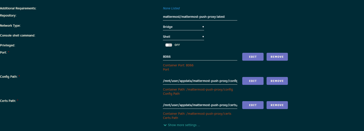

On 7/26/2022 at 2:44 AM, Kilrah said:
The mattermost-push-proxy container won't start:
/usr/local/bin/entrypoint: exec: line 3: /mattermost-push-proxy/bin/mattermost-push-proxy: not found
Template is setup wrong.  You will need to edit the paths like the screenshot below.  Delete the first one that is pointing to /mattermost-push-proxy and change the 2 others.

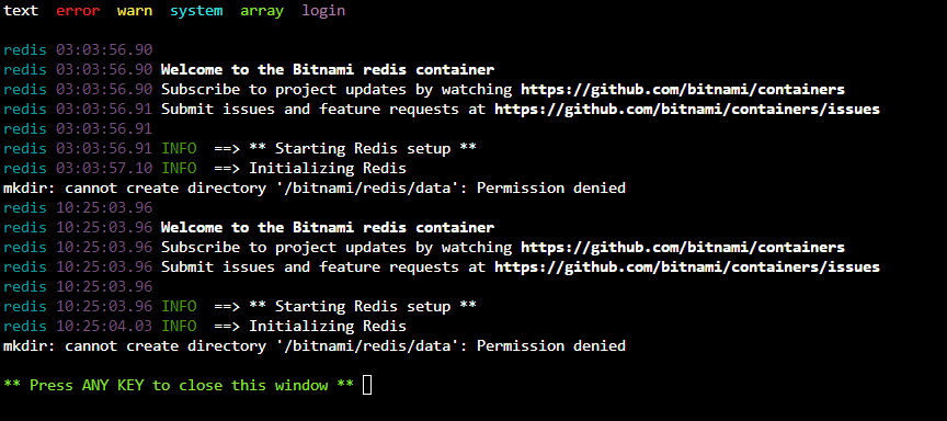

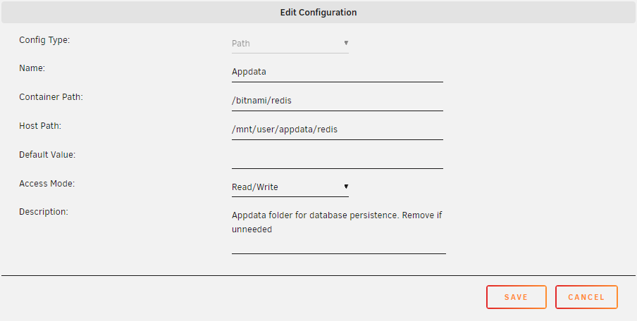

Got an error today with redis.
The permission is read/write.
Have the same problem. Could you solve it?
Same exact issue with me. Cannot get it going again.
