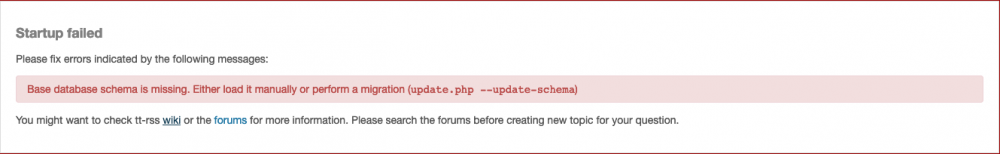

Hi, I am getting an error with TT-RSS on Unraid. (All Latest Version)
Exception while creating PDO object:SQLSTATE[08006] [7] could not connect to server: No such file or directory
	Is the server running locally and accepting
	connections on Unix domain socket "/tmp/.s.PGSQL.5432"?
Please help me.
Thanks.

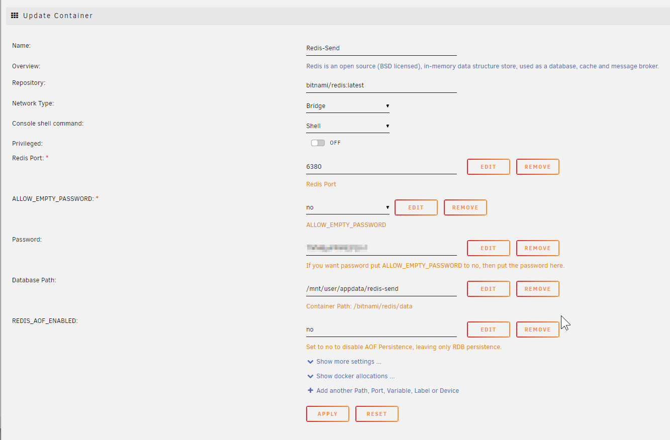

Is there an easy way to map an appdata volume for the Redis container so it has some persistent storage?
EDIT: Nevermind, it's all here :)
I should read the docs first.
https://hub.docker.com/r/bitnami/redis/

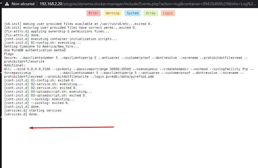

Since last update docker Pure-FTPD
The logs consol work but i can not see user connections or information
We have Unraid : Version: 6.9.1
Last docker update for pure-ftpd
We miss something ?
Please help me.
Thanks.
We miss something ?
Thx for your help
No idea if im being honest

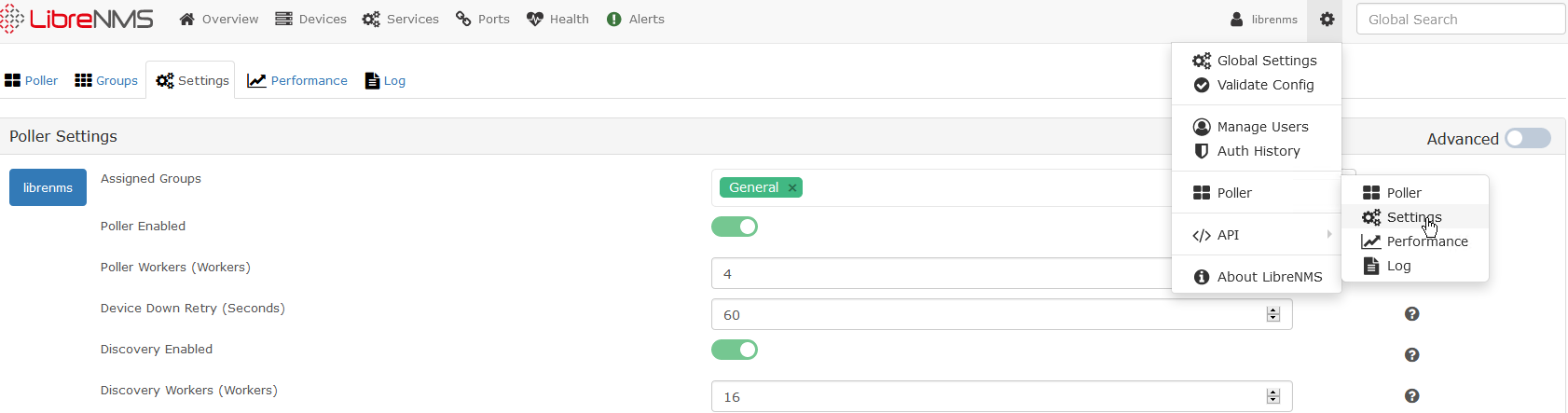

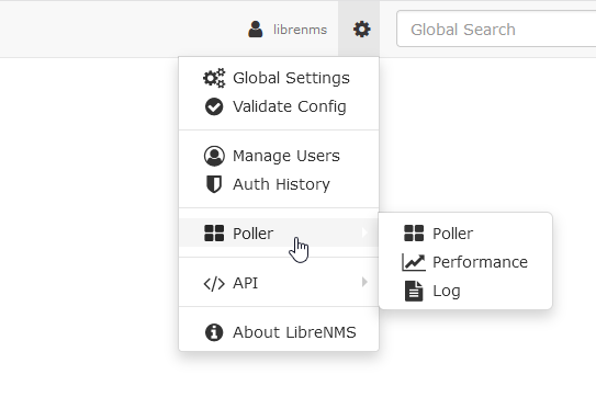

I have libreNMS docker installed, and have a mysql container installed, and libreNMS comes up like it should, talks to the DB just fine. I can add a device, but it doesn't ever poll the device. I can manually poll the device via command line in the container, but there doesn't seem to be any cron or anything that runs the poller. I have been reading up that there has been some changes in the docker, and looks like it may need a side car container called dispatcher for polling.
I'm just curious does anyone have libreNMS running with the latest container and polling working?
Thank you
Thank you
So in the docker under setting poller, you get poller, performance, log.
librenms, has vm appliances, so I got one of those stood up and everything is working, but look at the menu difference, and you have setting to enable the poller. I'm not sure what is up with the docker version.
Please help me.
Thanks.
Had the same issue. The creator of the docker container modified the Docker variables. Edit your tt-rss container, take a look on the Variables and fill them correctly. According to the error message you are using Postgres as Database.
eg. in the Variable TTRSS_DB_TYPE you have to type "pgsql" instead of "mysql".
In my case I had to fill out everything again (DB Type, Host, User, Pw, Name etc.). No clue how and why this happened, because I setup the container month ago and didn't update it since then.

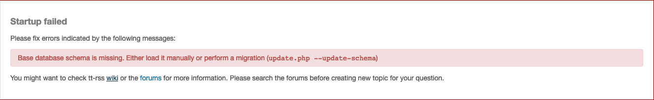

tt-rss Startup failed
I'm trying to run tt-rss, but when I access the WebUI I get an error message that the "base database schema is missing." Can anyone help?
Thanks.

New send container is working, however I cannot seem to get passwords to work, I enter something easy like "test" or "test123" as a password and it then tells me later the password is incorrect.
EDIT - Disregard, once I actually set it all up via reverse proxy, it seems to be accepting passwords now.
PS you do need some Redis persistence.
I have mine setup like this, databse saved to appdata, and AOF disabled, to keep the Redis database extremly small (given it's expiring nature)
Edited by CorneliousJD
Hello,
My log is complaining about:
vm.overcommit_memory = 1
 How to make it persistant ? can't remember ... !!
okay, i found out.
created a sysctll.conf files under /boot/config/
# redis
 then execute :
/sbin/sysctl -p /boot/config/sysctl.conf
should do the trick...
posted for other newbee like me...
Edited by tech_rkn
solved
Thank you very much for this information ill be sure to add this on description.
