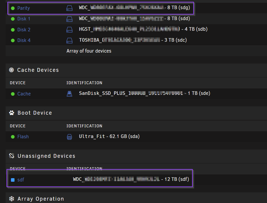

Sorry for asking almost the same question as the OP, but I just wanted to clarify something... I'm trying to do the same thing (replace parity with a larger drive, and once it's done rebuilding, add the original parity drive to the array). I'm not using the same port, and both drives will always be connected at the same time. So, when I get to Step 5, and change Parity1 drive to the larger one, I get a warning that it's the wrong drive (see attached pic). It looks like it'll let me the array anyway, but that warning got me worried that I might trash my array by doing it this way.
Can you guys please let me know if that's exactly what I'm supposed to be doing?

  • I find the guides pretty confusing. I want to replace my parity drive with a larger one on the same SATA port. Then add the old parity drive as a data drive on a different SATA port. This is because I
  • Not going to comment on the Parity Swap Procedure, as I've never done it and it's just a "shortcut" for the standard way   Stop the array  Assign the 12TB as parity drive Start the
  • Squid is correct but you can also stop the array, unassign the 8TB parity disk, assign the 12TB disk to parity, and assign the 8TB disk to the next data disk slot all in one step.  This is a supported
The warning is normal, start the array and it will re-sync the new parity, once that's done you can add old parity as a new data disk.

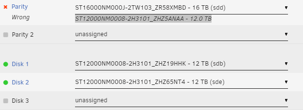

I have tried to upgrade my parity to a larger drive (12TB) and then add the old parity (8TB) to the array, but it is not working for me following the suggestions in this post.
After preclearing the new drive and stopping the array, I added the new drive as Parity 2, brought the array back up and let the parity sync. I was able to disable VMs and Docker while I did this and the sync process took approximately 24 hours. I then stopped the array and tried to change the old parity drive (P1) to "no device" so that it would become unassigned, and I could preclear it,  ready to add to the array, but it would not accept this after the restart and the old parity resumed as P1. I tried to remove P1 to "no device" and then adding it to the array, but after reboot, the old parity resumes as P1 again.
I'm not sure if this is relevant, but when I unassign the old parity drive, it is listed in the Unassigned Devices as Dev 1, but there is already another Dev 1 device in that set of disks.
I'm not sure what I'm missing here and I've attached my diagnostics.
Thanks
Thanks
Are you saying the following sequence of commands do not work to remove parity1?
  • Stop array
  • unassign parity1
  • start array without parity1 assigned to commit its removal?
Note you cannot assign the old parity1 to the array.until you have successfully started the array without parity1 (I.e. it has to be done in 2 stages).

Using the process you mention above, I am unable to start the array after unassigning parity 1; the button option is greyed out and the disk is labelled as missing. My only option is to reboot the server and when I do, parity 1 is back again.
Are you sure there is not a checkbox to confirm you want to start the array without that drive (and that checking it enables the Start button).   I would expect a reboot to bring the drive back as the change is not committed until you start the array without the parity1 drive.
I completely missed this. I found the box and checked it and now it is all working, thanks. I will preclear the old parity 1 before adding it to the array.
Thanks again for your assistance.
