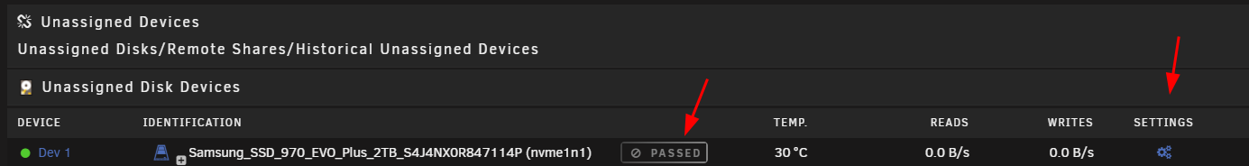

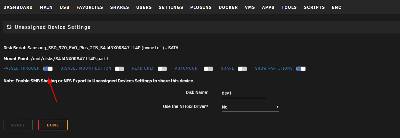

No, scripts. I don't see a way to specifically mark the USB drive as pass-through. In the pcie devices list , they are all grouped together.
you mark this in the UAD setting of the device

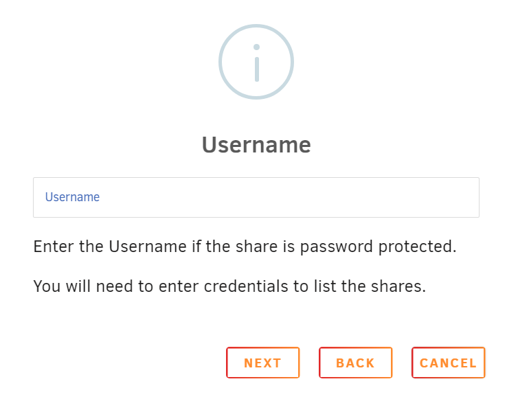

 I'm looking for help accessing to access an SMB share on Windows. My windows machines can see the share OK but when I try and add as a remote smb share in Unraid so I can copy files to Unraid from the share unraid wont mount it and says remote server is offline.
I'm new to Unraid and only just setting up the server so maybe I'm doing something wrong here. I have the Unassigned Devices app installed and have successfully mounted my Synology Nas as an SMB share but can't get any windows shares to work.
The best way to do it is to click add a share, select the Windows icon, then click on "Search for Servers", choose the Windows computer, then enter your credentials.  Once you get on the Choose Share dialog, click on "Load Shares".  If shares don't show, you have a credentials problem.
If the "Search for Servers" does not show the Windows computer, go to the Settings->Unassigned Devices, click on the "Remote Servers" and enter the Windows computer name and see what UD finds about the Windows computer and SMB sharing.
Thanks for your help but that's exactly what I've been doing and the shares wont show up. When you say credentials problem I assume you mean windows is denying access . On the windows desktop I have given full control to "Everyone" and even tried turning off requirement for authorisation for share access. Other windows PC on the network can see and read/write to the shares but not Unraid even though its the same credentials. Is there something in Unraid I'm missing that would enable access ?
You need to enter Windows credentials (login credentials) to show the shares and mount the remote share, even if you have it turned off.
