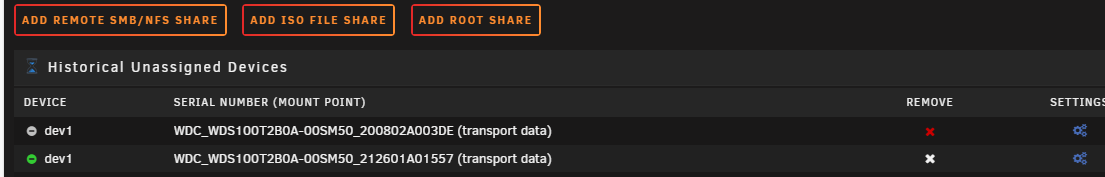

hi i constantly have issues with SSDs and the hot swapping i always get
sd 12:0:1:0: [sdl] Synchronize Cache(10) failed: Result: hostbyte=0x01 driverbyte=DRIVER_OK
i cant seem to stop it  i even do spin down  for the sdd before i slide it out..  doesnt matter
and then it leaves it powered on  in the historical  section
how do i fix it so it properly  disconnects from unraid when you unplug it and it wasnt even mounted
and then when i re plug that SSD back in then i cant mount it as it will say REBOOT   so  this happens with both SSDS i got there  i swap with my sister

i used another ssd  and it also keeps it online doest shut it down  when i pull it out of my server
is there something i need to add to my GO file or something so i no longer get those errors and it disconnects properly

I suggest you check your BIOS and be sure it is set properly for hot swapping disks.
@dlandon
just recently updated the bios yesterday  and yes i set them all sata drives to Enabled and Hot Swapable
the SSD  is connected to a LSI HBA card though
11 minutes ago, comet424 said:
@dlandon
Maybe @JorgeB has some suggestions.
