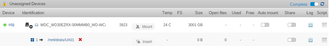

Today is the first time to use Unassigned Devices. I took an old drive and did insert it into my unRAID box. I do see the drive in UA and UA reports about an existing partition.
Whenever I try to remove that partition, it reports success but the partition is still there. I would like to format that partition in XFS and share it's content.
What should I do?
Thanks in advance.
***Edit*** Destructive mode was and is enabled.

Short log snippets are not useful.  Please post your diagnostics.

How is this disk partitioned?  It looks like UD cannot handle removing the partition.  What is the file system?  Can you show a screen shot of UD so I can see what it thinks is the file format?
You will probably have to take this to another computer and use a partitioning tool to remove the partition.

Or use wipefs command (being careful to wipe the correct device) :D
This drive was part of an unRAID machine. I did replace it with a 6TB. Don't know what filesyste it had (ReiserFS, XFS, BTRFS or parity).
Do I issue wipefs for the partition sdg1 or the drive sdg?

There is no file system on the disk that UD recognizes.

That would explain it.
