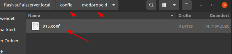

@Dimtar is iGPU hw transcoding still working for you ? if yes then may @ich777 rather can help why his plugin shouldnt work.
if not, this plugin should also enable the hardware acc due the changes from 6.9 beta35 up, see here
may take a look at your flash drive if the following exist for intel igpu like described in the changelog
Thank you very much for this link, I am not sure it has solved my problem though.
I followed the instructions on the post to enable the i915 driver I believe but its not working I don't think..
root@DIMRAID:/boot/config/modprobe.d# ls -lah
total 8.0K
drwx------  2 root root 4.0K Jan 21 16:49 ./
drwx------ 11 root root 4.0K Jan 21 16:52 ../
-rw-------  1 root root    0 Jan 21 16:49 i915.conf
root@DIMRAID:/boot/config/modprobe.d# intel_gpu_top
Failed to detect engines! (No such file or directory)
(Kernel 4.16 or newer is required for i915 PMU support.)
This shouldn't be necessary when you've already installed the Plugin since it loads the driver each time the server is booted or the plugin is installed.
The driver itself and also transcoding should work.
