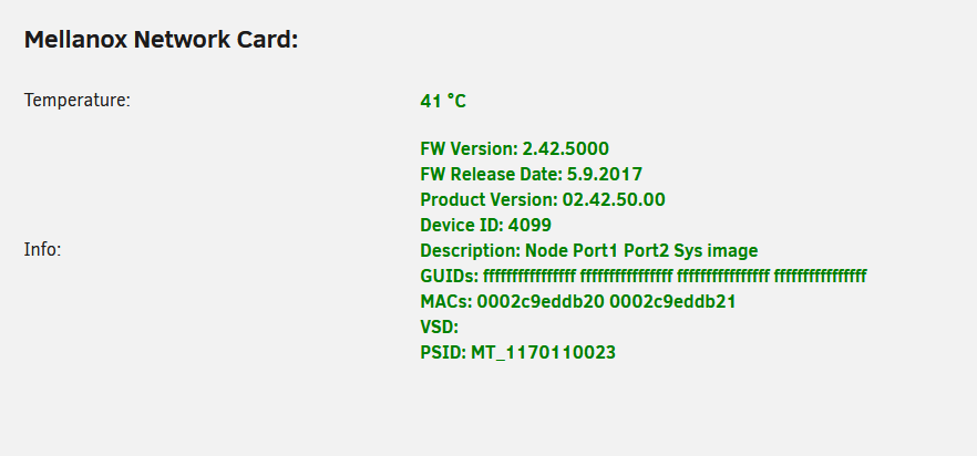

hi, im late to the party, but i got my self a couple of Mellanox 10G cards and a 10G spf+ switch.
I installed the mellonox plugin but that only shows info on the card:
Info:FW Version: 2.42.5000
FW Release Date: 5.9.2017
Product Version: 02.42.50.00
Rom Info: type=PXE version=3.4.752
Device ID: 4099
Description: Node Port1 Port2 Sys image
GUIDs: 0000000000000000 0000000000000000 0000000000000000 0000000000000000
MACs: 0002c9382cd0 0002c9382cd1
VSD:
PSID: MT_1170110023
and a link here to this thread... am i missing something on the firmware tool side?
Edited by orlando500
Exactly this plugin installs only the Mellanox Firmware Tools (to flash the card or switch between modes) and is not a driver but the Mellanox ConnectX-3 should work just fine OOB in Unraid, even a ConnectX-2 is working fine OOB (had both of them).
Eventually try to delete the 'network.cfg' from your '/boot/config' directory and start over with a new netwrok configuration)
Here is a screenshot from my card that is working just fine:
Hi, thanks for the fast reply. Maybe in a bit slow here to night but where do i flash the card from...? guess you add some menu items somewhere but cant seem to find them.
No menue there, the tool was manly made to display the temperature of the card and flash the card via CLI or better speaking to delete the Boot rom from the card.
Please look up how to flash you card on the Mellanox site since this differs from card to card....
