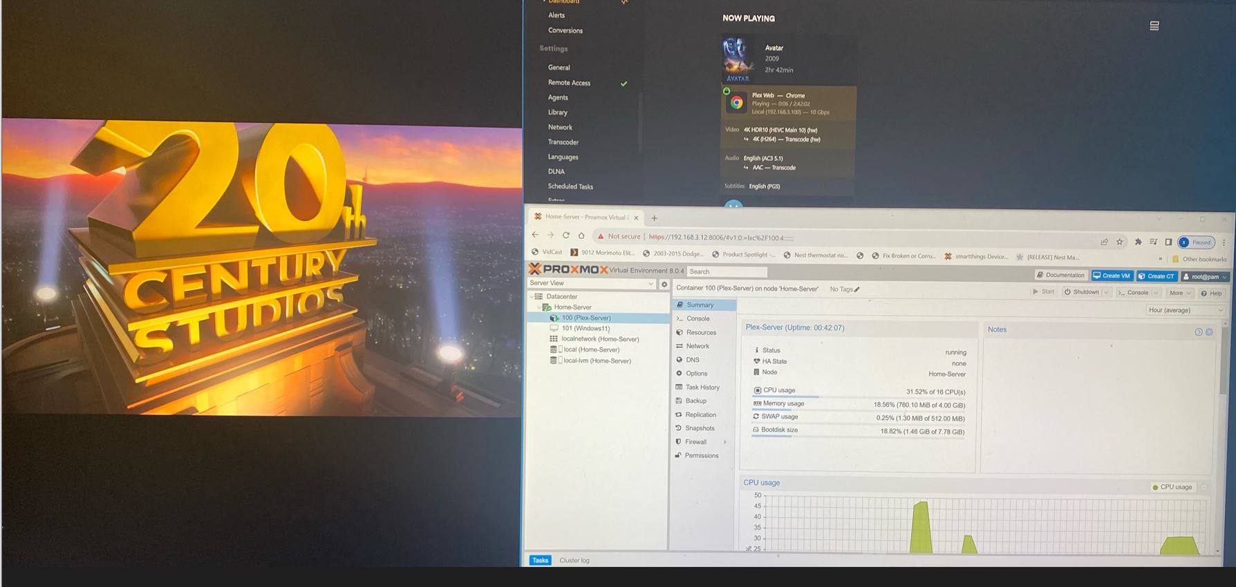

On 9/15/2023 at 12:26 AM, ich777 said:
This is a well known issue, you should report that on the Plex forums, this only affects the Plex web client on all platforms, it‘s also not related if you are using Intel, Nvidia, AMD for transcodig.
This is a Plex issue.

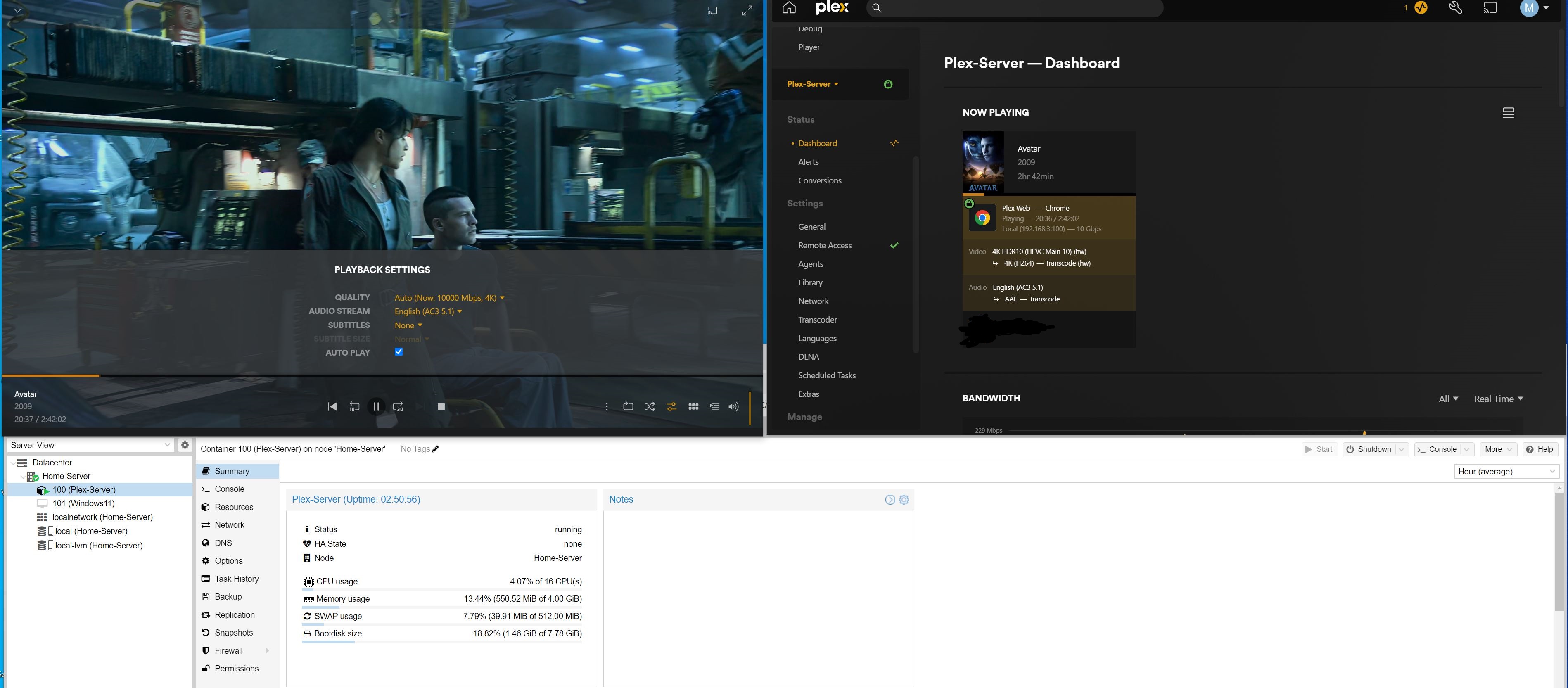

Just wanted to reaffirm this statement if any folks have doubts. I started up the linux machine (same box I am running unraid) with PMS 7349 and I see the same thing. Via web browser even though it says HW transcode it uses 32% of my CPU.  Even if I use my iphone I see significant CPU effort involved in transcoding. Something I never noticed before. If I use Nvidia shield device as player CPU effort is near 0 to transcode.
Maybe because you didn‘t look into it like you do now.
Transcoding always depends if you need to transcode audio too, in this case for your phone it looks like it is necessary (audio transcoding is of course done on the CPU).
For a Nvidia Shield you don‘t have to transcode in most situations because it can play almost all formats regardless of video or audio.
Also keep in mind that Plex can‘t handle subtitles well at times IIRC and that can also be a big hit on your CPU.

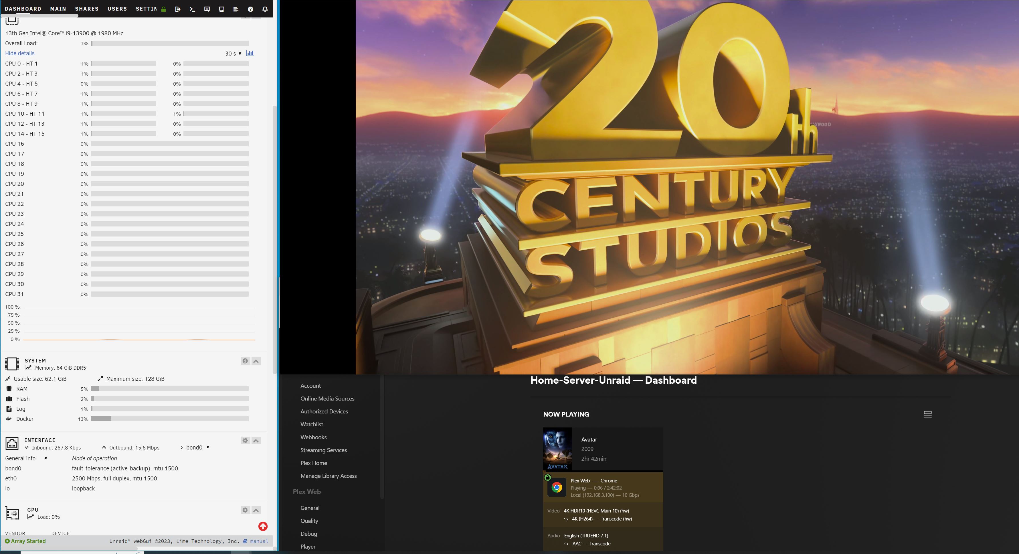

You are correct looks like subtitles makes the biggest hit I will try this on unraid next. Also correct in I wasn't paying as close attention. I am evaluating unraid to switch to from proxmox. So trying to put it through it's paces.
Edited by xokia
Unraid offered similar performance. Sorry if I took things off topic of this thread. Thanks for the information. Looks like for me subtitles was the performance killer.
