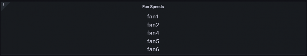

Hello everyone,
I hope I will make myself understood correctly I use a translator
First of all, a big thank you to falconexe for the work done to create the various visualization tables
I am stalling on the establishment of information concerning the temperature, the voltage and the speed of the fan
Not having the IPMI function I followed the instructions to use the sensors
Is it necessary to modify a parameter or only indicated sensor in the following line on Grafana?
SELECT last("value") FROM "ipmi_sensor" WHERE ("unit" = 'degrees_c' AND "host" =~ /^$Host$/) AND $timeFilter GROUP BY time($__interval), "name"
Thank you in advance for your help
Welcome and thanks. You will need to adjust each panel by editing it and selecting the appropriate sensor for each panel. Assuming you have everything setup correctly in the config file, and have loaded the sensors package, everything you need to adjust is in Grafana within the UUD dashboard panels.
Please search this forum topic for "Sensors" or "AMD" for many previous examples of how to accomplish this. Good luck!

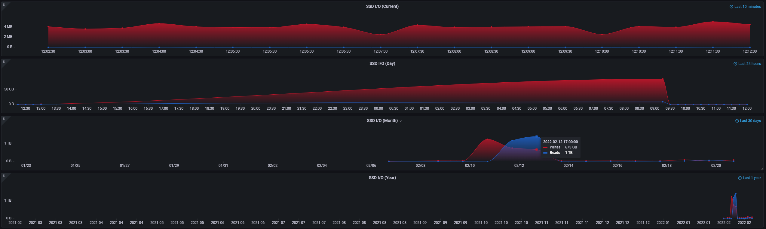

Interesting tidbit...

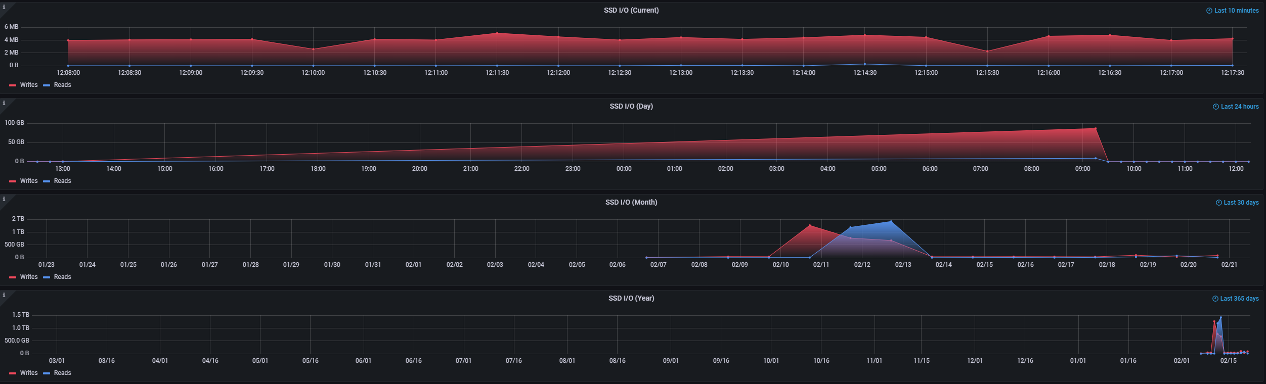

Without writing to Cache in any way (array operations) for 24 hours, I seem to be hitting 300-400 MB of writes per hour, and roughly 40GB per day, with just my running dockers. I suspect most, if not all of this, is Telegraph/InfluxDB/Grafana.
For anyone else using the UUD, are you seeing similar metrics?
For my SSD, I have a manufacturer's suggested lifespan of 1200 TBW. If I did nothing but run appdata stuff (and never used the Cache for array activities), my drive would last roughly 82 years at this rate. Even if I wrote 1TB a day with array activity, it would still last 3.28 years.
So I guess this puts to rest the fear of wearing out an expensive SSD Cache drive because of something cool like the UUD.
Edited by falconexe
I don't have an hourly chart, I do however have a daily chart. I'm using 170 MB per day but divide that by 24 hours I am only writing 7.1 MB per hour. I only have the telegraf docker running on the server InfluxDB and Grafana are running on a Proxmox server with docker running in a LXC container. I also have my appdata stored on a separate SSD not part of my cache. The only docker component on my cache drive is the system directory that contains the docker.img. I would guess that is the writing to the cache pool.
Nice! Thanks for sharing.
I have a beast of a server, so I am not surprised I am higher than you. My UUD is also stacked with panels and I have made some personal modifications to mine that suck even more data in. I hope you are enjoying the UUD man.

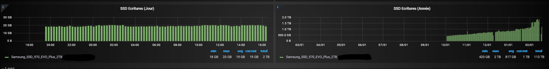

Hi, I have a lot of write on my SSD cache. I've changed it a few months ago (also a 2GB / 1200 TBW Samsung disk), so it's not an emergency yet. The write's stats was similar with the older SSD cache.
This is my current SSD write's stats (day / year) :
I also think that it seems related to the "Telegraph/InfluxDB/Grafana" stack.
There's a lot of things that Grafana is monotoring on my system (got a custom UUD dashboard, a Plex dashboard and a Nginx dashboard).
I'm far of being an expert on unRAID or Linux system, so I'm not sure how I could confirm where the culprit is.
I think I will try for a few day to set a new InfluxDB docker container with only a SSD write stats monitoring.
I was going crazy with it so it's "nice" to see someone else having some thoughs about this :)

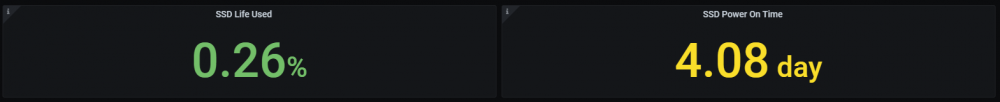

So I had a thought about a new Stat Panel that would be REALLY COOL. Unfortunately, it seems that it may not be possible with InfluxDB 1.X using InfluxQL, but it MAY be possible using FLUX on InfluxDB 2.X. I will lay it out for you here, as I think it is a VERY USELFUL STAT that people would want to know.
Basically it involves math concepts that are NOT SUPPORTED (from what I have researched) by the technology the UUD runs on currently, but I'll show you how to calculate this manually. I'm hoping eventually I can add this specific stat to the UUD.
Starting Metrics:
Math Calculation:
100% / 0.26% = 384.62 Slices of 100%
384.62 Slices * 4.08 Power On Days = 1,569 Days
1,569 Days / 365.25 (1 Year) =
FINAL METRIC = SSD Life Left (Time)
4.295 Years of SSD Life Left!
So at any given time, you can dynamically calculate WHEN your drive will EXCEED the Manufacturer's TBW limit from the 2 above stats (the total current TBW is already calculated in the "SSD Life Used Panel"). Of course this date will change greatly, and in real time, depending on how your drive is utilized. Dump 100TB in a week and the estimated replacement date will be much sooner. Only use it for Cache appdata, then it will likely trend upward and you'll get longer life with a date far in the future. Theoretically, this future date is when you should start looking to replace the drive. I suspect once it gets within days, it will be VERY ACCURATE.
Even though this calculation is pretty straight forward, such things are not permitted in InfluxQL. If I ever figure this out natively in a Stat Panel, I will definitely add this to the UUD! Let me know your thoughts!
@SpencerJ @GilbN
Edited by falconexe

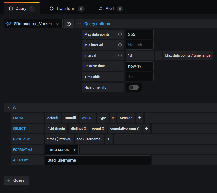

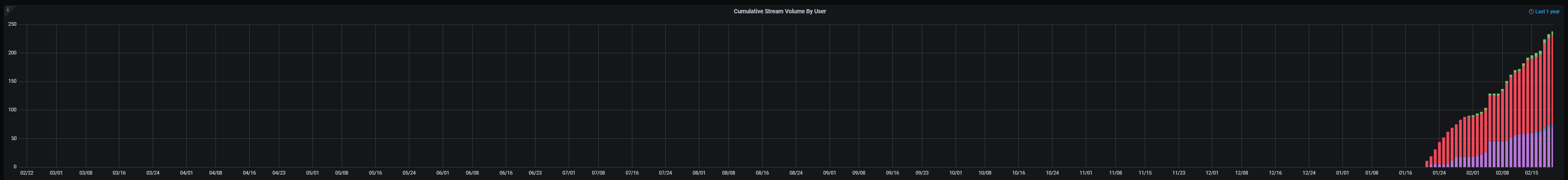

New Plex Panel:
Stacked Bar Graph - Cumulative Stream Volume By User (Last Year):

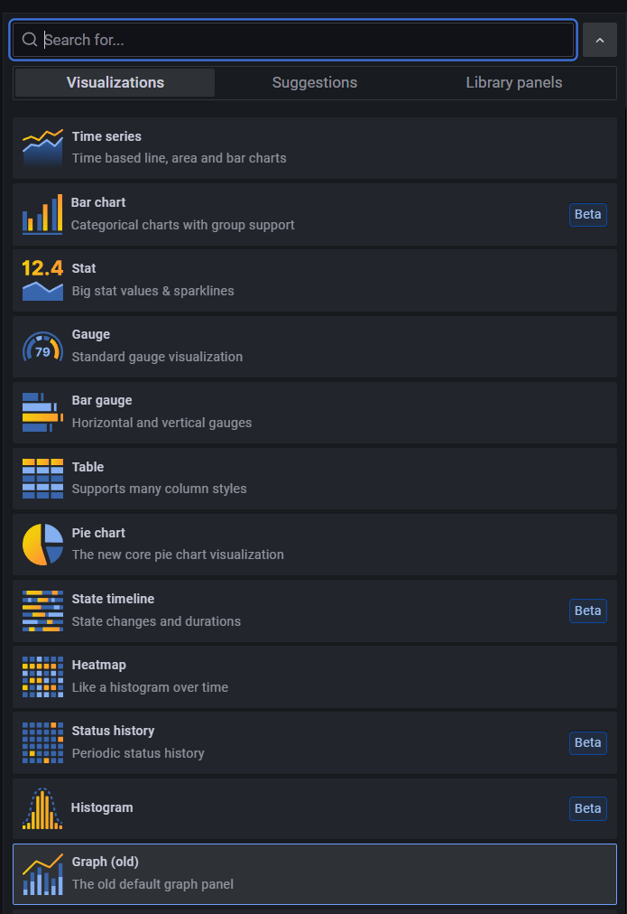

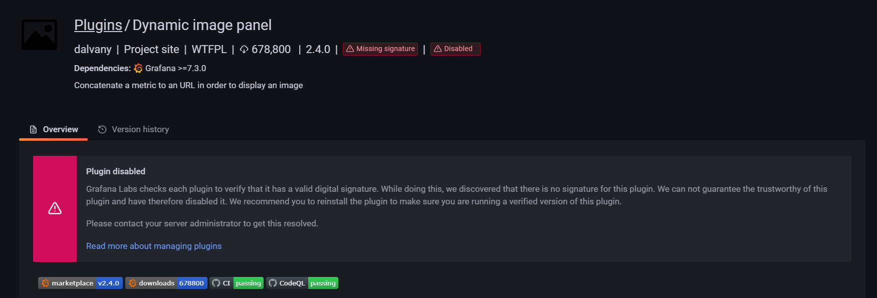

DEVELOPER UPDATE:
The recent Grafana Docker update is causing a number of issues with the UUD.
Some Panels are entirely broken, and Plugins that the UUD utilizes have been disabled due to security concerns.

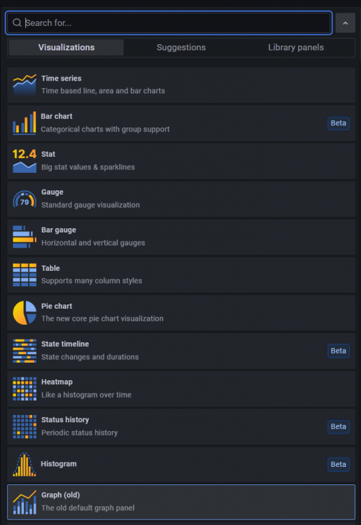

Furthermore, Grafana has deprecated entire panel types in favor of new versions of the same panel types.
Example: "Graph" (OLD) is Now "Time Series"
The Grafana 8.4 press release can be found here:
https://grafana.com/blog/2022/02/17/grafana-8.4-release-new-panels-better-query-caching-increased-security-accessibility-features-and-more/?utm_source=grafana_news&utm_medium=rss
If you choose to update to Grafana 8.4, be prepared to make some adjustments.
 Sadly, it looks like this will be the end of the UNRAID API/Dynamic Image Panel functionality (unless the plugin developer gets it signed by Grafana and they update it.)

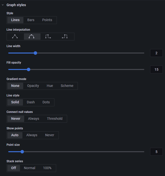

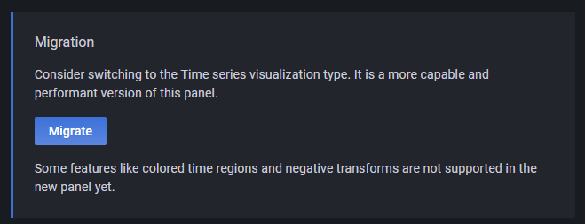

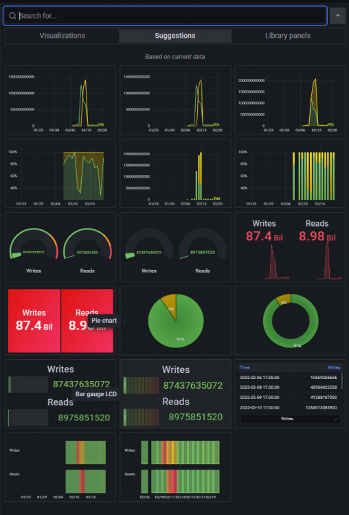

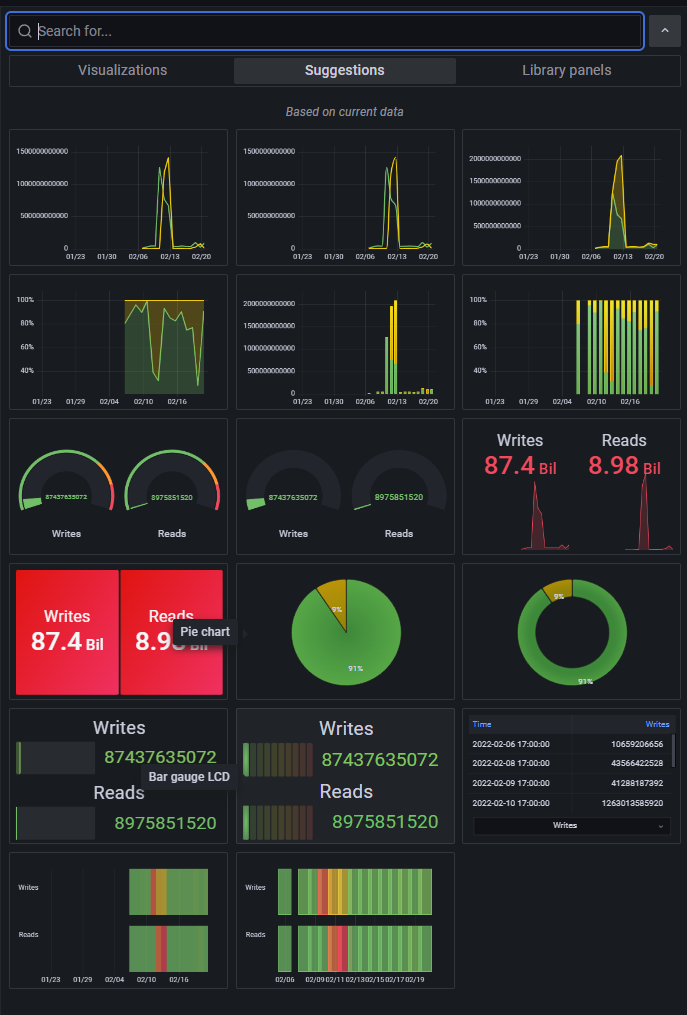

I will say this about Grafana 8.4. There are some really slick features in it with A LOT more variety. They will even suggest new styles of panels based on the current data. Pretty cool so far. I am making good progress on fixing what broke. Not too bad so far... some panels even have a migration assistant.
Panel Migration:
New Curved Line Graph (Among Other Line Interpolation Options):
New Gradient Line Graph:
New Panel Suggestions Based on Current Data:
Edited by falconexe

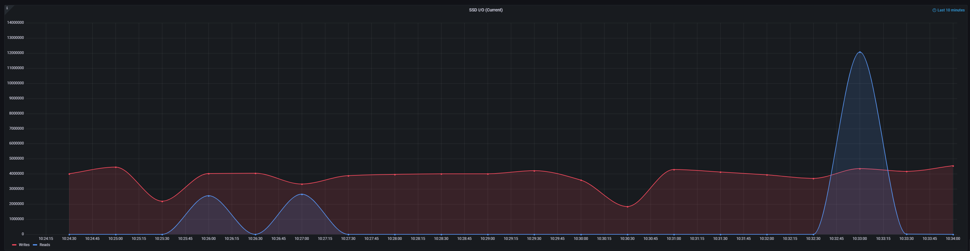

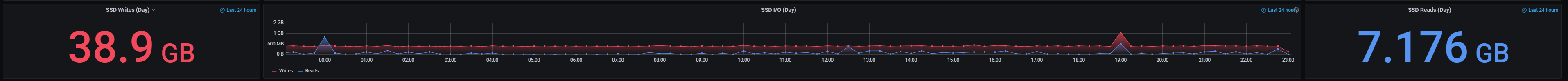

Here are the "Migrated" curved Cache graphs without Gridlines or Legends (now mouse-over tooltips). This look is a pretty clean design. I like it...
New:
Old:
Edited by falconexe

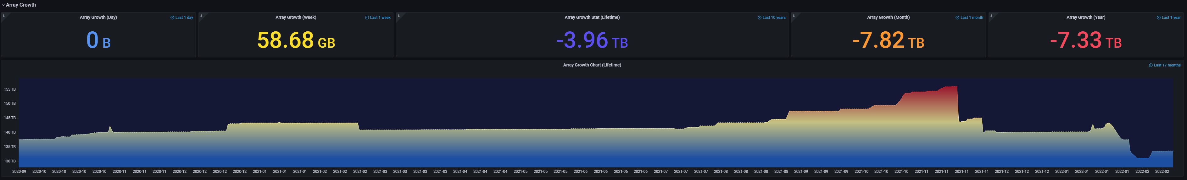

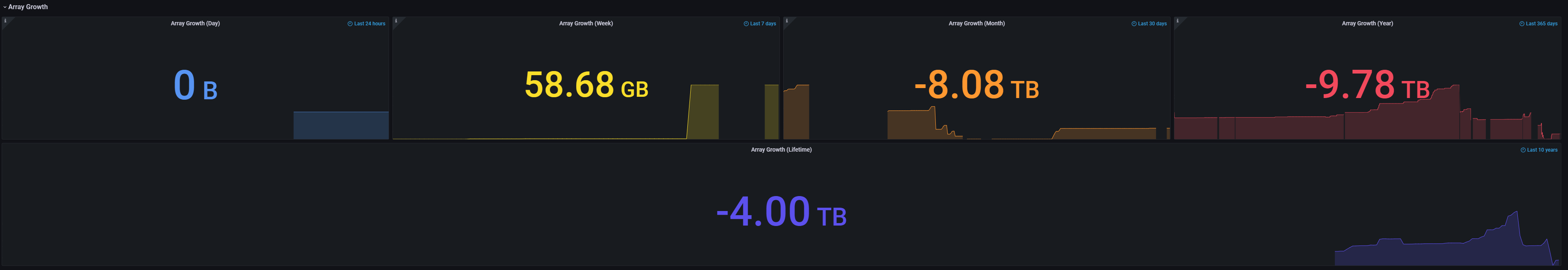

Lots of changes in Grafana 8.4, but so far here are the comparisons and new features I'm delivering. You'll notice some new heatmap/gradient graphs for lifetime array growth 🔥
Header Now:
Header Before:
Array Growth Now:
Array Growth Before:

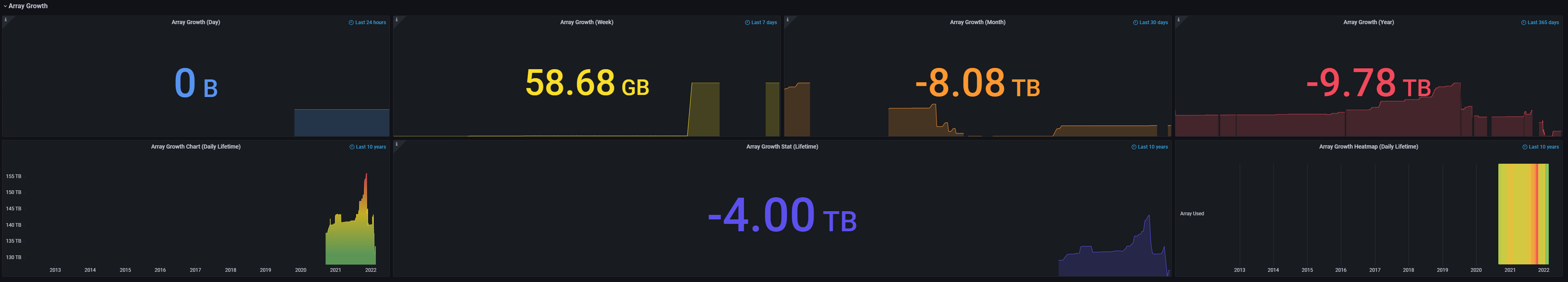

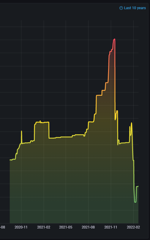

I ended up settling on this for array growth. I was tired of the data gaps in the Stat Panel Spark Lines. This is super clean and Grafana 8.4 brings A LOT more customization options.
Edited by falconexe

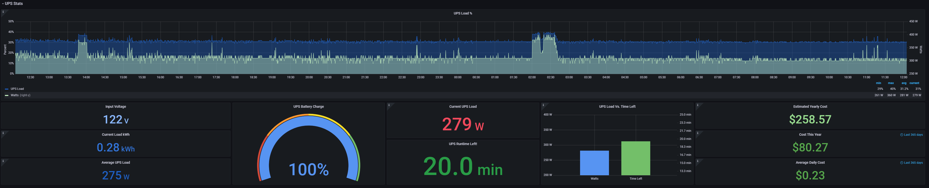

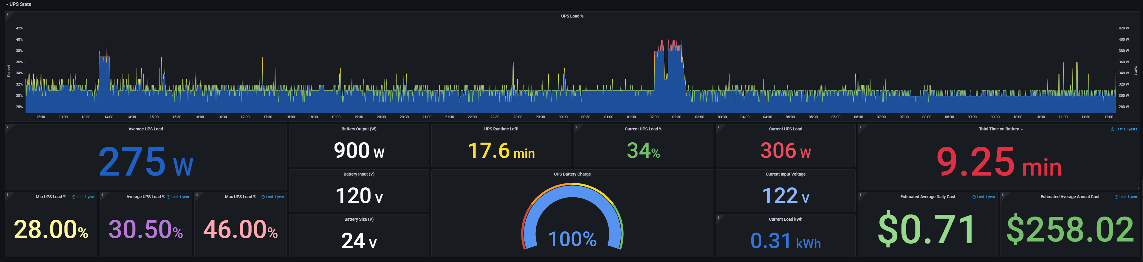

Giving the UPS Stats some Grafana 8.4 love. Did did some house cleaning, added new panels, updated/fixed existing panels, and added a new fresh style.
New:
Edited by falconexe
