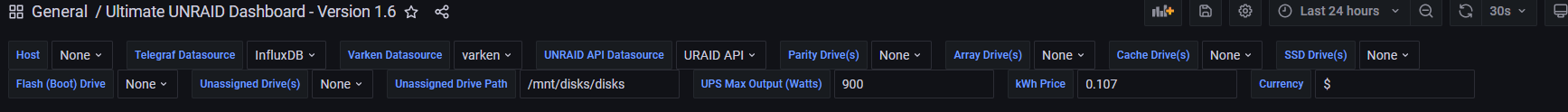

I have another question, In the 1.6 dashboard, I'm not able to select a host (itself).  It only has/shows none.  As such I can't pick drives, etc.  I've reviewed the install at the beginning of this post and searched this topic but I'm coming up empty.
Can you tell me what I'm missing to get the host itself in the host dropdown?

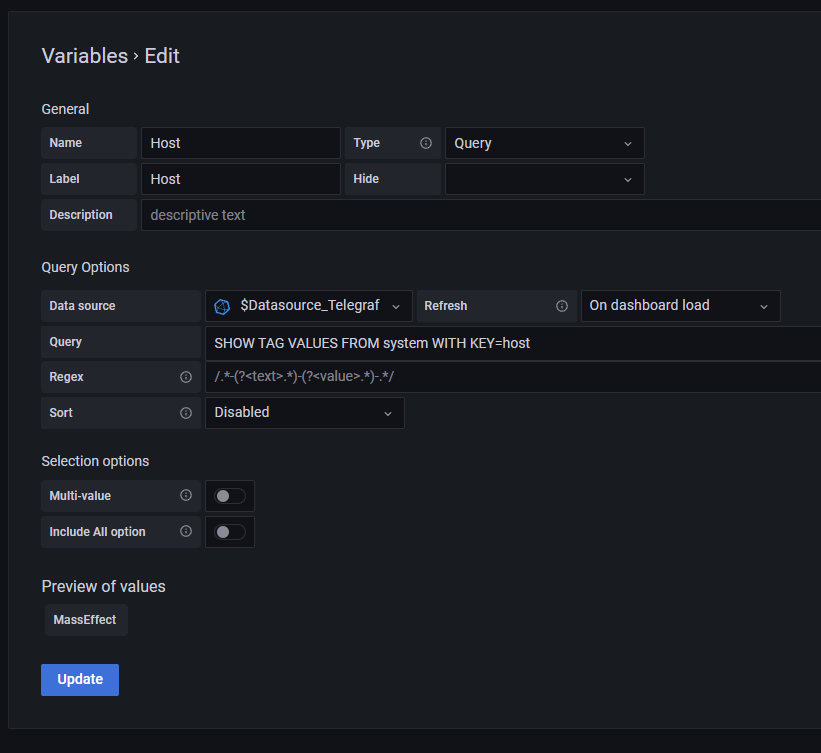

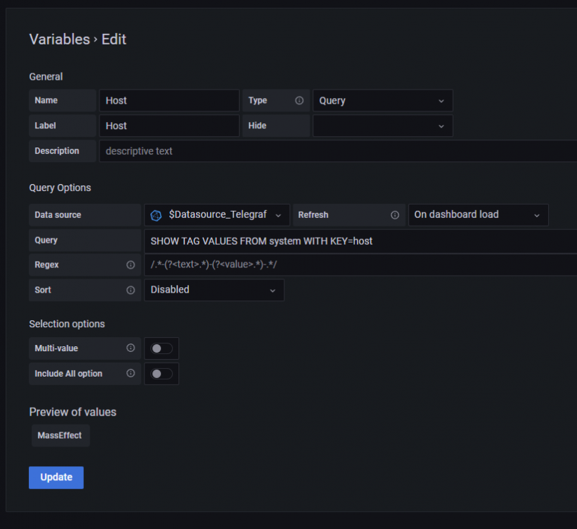

Check your "Host" variable in the dashboard by clicking the gear icon in the upper right. You should see the following and your host name at the bottom in the Preview area.
I found it but the preview says 'none'.  Otherwise it looks like yours.

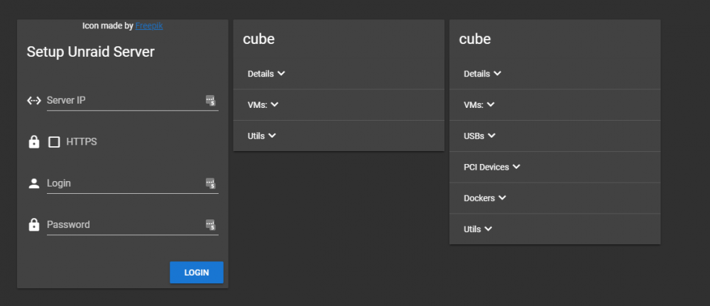

Not sure if this has anything to do with it but I had an issue with the unraid api when I first started it and tried adding this server.  I searched through the tread and found where someone had to change their root password to the same thing it was and it worked.  I did that and added the server again and it added the second one you see below (which is fully populated in the dropdowns).  Could this first one be screwing me up with the host variable?  How does one go about removing the bad one?

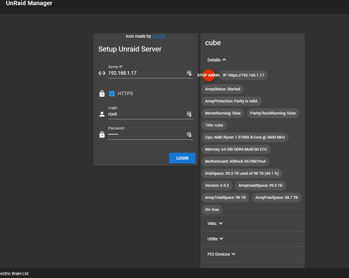

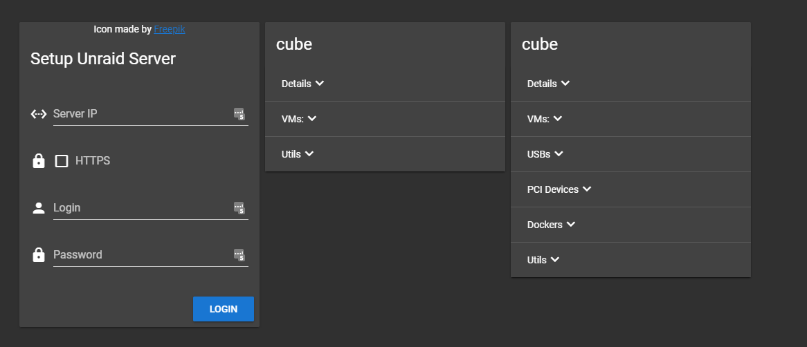

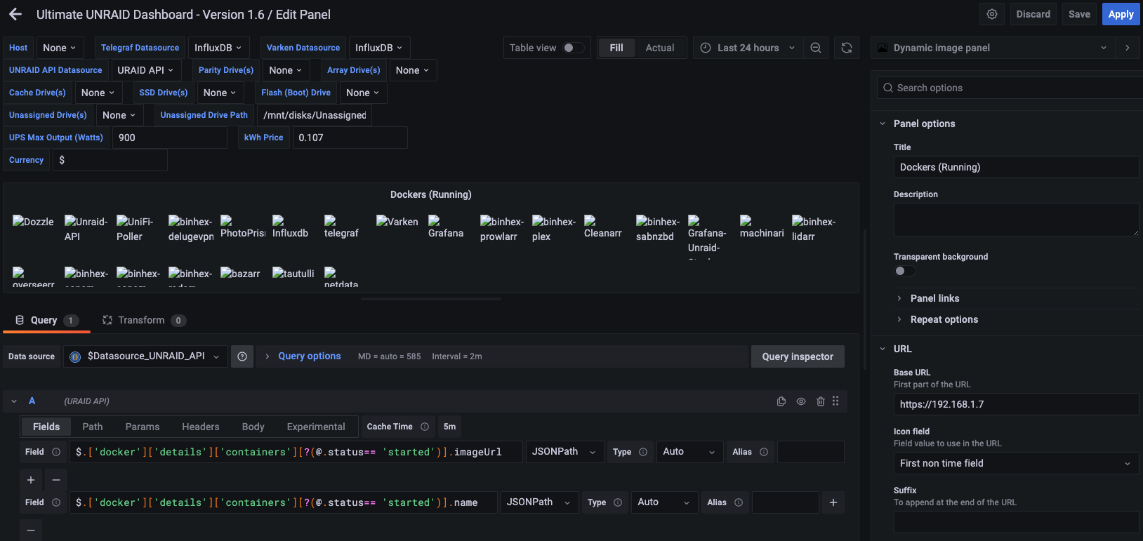

Good Morning,  I found something else that might be causing my host (none) issue.  In some to the panels, it has the wrong IP.  I'm thinking I must have fat fingered it somewhere but I can't find where.  I've even grep'd my appdata for the IP and it's not showing up.  Below in the lower right you can see it has the IP: 192.168.1.7, where as my unraid server is 192.168.1.17.  Wherever this is pulling this from, could that be causing my Host-none issue in the above post?  Does anyone know where I can look to find where the 192.168.1.7 is coming from so I can correct it?
You can change it right there in the base url field. That is for the docker icons. Looking at your variables you have none for almost all of them. I'm going to have to say there is an issue with the telegraf config file. It's easy to do and hard to find.

I removed unraid-api and reinstalled it and now I have only one server in the unraid-api UI.  I guess this wasn't what's causing my host to be none.
I edited some of the panels and put the 192.168.1.17 instead of the 192.168.1.7 it had in there but that didn't affect the icons.  I saw there went icons and I saw several other folks have this issue.  I hadn't look into those yet.  I think the majority of my issues are from the host only showing non.  If the lack of icons were my only issue, I'd be sitting pretty.  ;-)

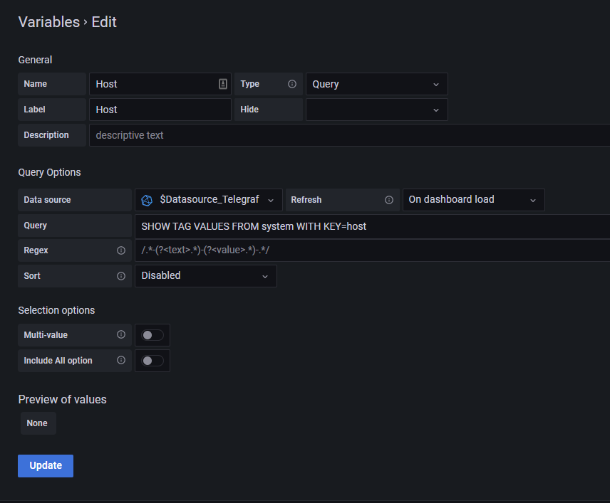

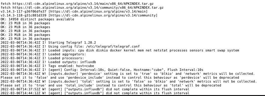

I replaced my telegraf.conf with yours and changed the outputs.influxdb section and the interface.  No errors in the telegraf longs (shown below).  I'm going to try to remove telegraf altogether and reinstall it.  You can see in the telegraf log that telegraf is picking up my hostname though, so that's odd.
Yeah... I don't understand that. The only thing I can figure is the grafana data source isn't set right or it has an issue pulling data from the database.

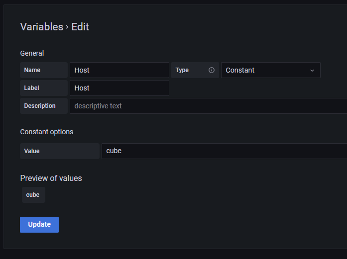

Try setting your host variable manually to a constant and see if that changes anything. If you are only running 1 UNRAID server, then you can safely do this. Not sure what is going on, but the below work around should fix it.
Over the weekend I deleted all of the related dockers and started from scratch. I still needed to make the host variable a constant with "cube" for some reason but that fixed most of my issues.  I'm still working on why it's not picking up my started and stopped VMs then I'll move on to my docker icon issue.

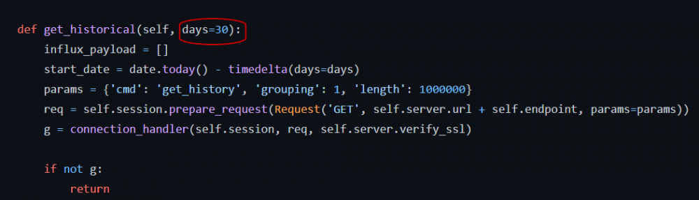

Anyone know if the creator of Varken "Boerderij" is on the forums here? I just need an option to pull in ALL historical Tautulli data upon installing Varken, or pass some kind of parameter to the docker to choose the earliest load/retention date for an existing install. Or better yet, run a command in InfluxDB to ingest everything from Tautulli via Varken going back to day one (brute force the database). I assume all of this is possible. Maybe I can fork the entire thing and just modify this single "tautulli.py" file as @skaterpunk0187 suggested...
https://github.com/Boerderij/Varken/blob/master/varken/tautulli.py
having the same issue as you, even after changing the base URL. One thing you can do is right click on one of the icons (you may have to try several areas) and get the image url, it might redirect you to the unraid page so you can login
I get redirected to login, it just never pulls/shows them.  I've done every icon one at time. It's something with chrome, Firefox and safari work as expected after the redirect and login.
