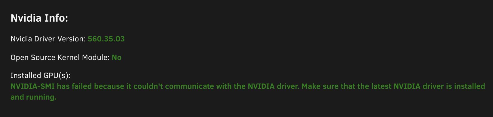

Crash after installing Nvidia Driver?!
I had a server up and running since the beginning of 2024 and all was well until a few weeks ago when I came home to find it crashed and repeatedly rebooting when I attempted to start it back up.
Since then I have had nothing but further issues and crashes, so today I decided to try starting fresh. At this point I've narrowed it down to something going on with my Nvidia 3060Ti. On my most recent attempt, I booted into a fresh unraid OS from a brand new thumb drive. Started up a 30 day trial, and went directly to Apps. Installed CA and then installed Nvidia driver plugin. Went to settings and when pressing the Nvidia icon to check on the driver, the server instantly reboots. This is reproducable.
My 3060Ti is only a few months old and was working very well in Plex, Tdarr, Stable Diffusion, and others before the crash a few weeks ago.
Does anyone have any idea where I should start with trying to solve this? I've done okay up until this point but I am far from being an Unraid expert.
Edit to add: I have this issue on 6.10.13 and 7.0 beta 2, makes no difference. The server was originally running 6.10.13 before the initial crash.
Edit 2: I just tried swapping in my old 980Ti and am now able to see the Nvidia Plugin options after clicking on it. Did my 3060Ti crap out?? This keeps getting stranger. 😵
TLDR;
Unraid server in new config crashes immediately after installing Nvidia driver and trying to access Settings/Nvidia
Edited by MissEmma
when you say your server reboots ...
then its most likely a hardware issue, to aggressive power saving features, xmp, ... well, hardware related in the end, hard reboots ...
a software crash ends in a "freeze" where you have to hard reboot yourself as the server doesnt react anymore ...
sadly ... hardware issues like this are hard to narrow down, as you usually wont find anything in the logs, like pull the plug.
to startup debugging its more or less a clean BIOS (defaults, no power savings, no xmp), clean Unraid, no power savings ...
memtest to check RAM
then step by step either replace hardware or check if you can narrow it down to specific hardware by usage.
looks in your case somehow when NV GPU is accessed
power supply
GPU ... (tried on another mashine for testing ?)
PCIe slot (tried another for testing ?)
like said, hard reboots usually hardware == hard to nail down ...
Seems like a hardware issue with your 3060Ti when another card is working.
Do you have another PC where you can put the card in, install the driver and let a benchmark run for some time?
Maybe try to enable mirror syslig to flash and see if you got something in the mirrored syslog.
Link to comment

I'm having an issue where the Nvidia Driver isn't detecting/reporting GPUs. I had a 1050ti in my first PCiE slot and everything was working no problems. I recently moved the 1050ti to the 3rd slot and added a 3060 to the 1st slot. This is a configuration I had in the server a few months ago. But now the driver isn't finding the GPUs even though Unraid is and can use them in VMs. I tried deleting the plugin and driver and reinstalling but no luck, any help would be greatly appreciated.Screenshot2024-09-03at1_14_10PM.thumb.png.51c6e0f0bd7c83fc94427e6f381825ac.png
Link to comment
