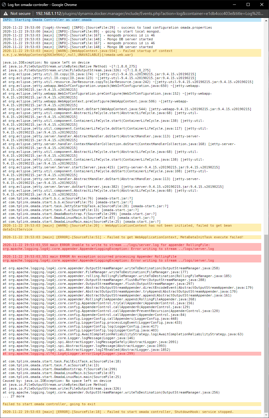

jbquintal Posted November 22, 2020 Share Posted November 22, 2020 (edited) First up, thanks for the docker! I've been waiting for a docker app that supports Omada Controller v4. Right now, I'm running a windows vm just to get the controller. Anyway, I tired installing your docker but I must be doing something wrong. Any thoughts? Edited November 22, 2020 by jbquintal Quote Link to comment
hedrinbc Posted November 23, 2020 Author Share Posted November 23, 2020 (edited) Hi there couple questions. Â Were you able to create paths on your system for the three paths required? Were those paths on your array or in a cache or unassigned drive? Â My 3 paths are on an unassigned drive versus in the array and I have heard there could be permission issues if on the array. Reading those logs it appears to me it can't write into the paths. Â Happy to continue to help, I do have it running over here so we can get there! -Ben Edited November 23, 2020 by hedrinbc Quote Link to comment

jbquintal Posted December 3, 2020 Share Posted December 3, 2020 On 11/24/2020 at 1:34 AM, hedrinbc said: Hi there couple questions.  Were you able to create paths on your system for the three paths required? Were those paths on your array or in a cache or unassigned drive?  My 3 paths are on an unassigned drive versus in the array and I have heard there could be permission issues if on the array. Reading those logs it appears to me it can't write into the paths.  Happy to continue to help, I do have it running over here so we can get there! -Ben Hey Ben,  Thanks... I resolved mine by fixing permissions. Works great now. Quote Link to comment
hedrinbc Posted December 5, 2020 Author Share Posted December 5, 2020 @jbquintal Great, you mean you folders are on your array and you simply changed permissions?  If so can you share what you did in case others run into this?  Great o hear it is working well! Quote Link to comment

Wicked_Chicken Posted May 8, 2021 Share Posted May 8, 2021 Having an issue with the docker. Log as as such:Â Â at com.tplink.omada.start.task.MetaDataInitTask.a(SourceFile:51) at com.tplink.omada.start.task.f.a(SourceFile:13) at com.tplink.omada.start.OmadaBootstrap.f(SourceFile:321) at com.tplink.omada.start.OmadaLinuxMain.b(SourceFile:87) at com.tplink.omada.start.OmadaLinuxMain.main(SourceFile:25) Caused by: java.io.IOException: No space left on device at java.io.FileOutputStream.writeBytes(Native Method) at java.io.FileOutputStream.write(FileOutputStream.java:326) at org.apache.logging.log4j.core.appender.OutputStreamManager.writeToDestination(OutputStreamManager.java:256) ... 27 more 2021-05-08 11:07:18,740 main ERROR Unable to write to stream ../logs/server.log for appender RollingFile: org.apache.logging.log4j.core.appender.AppenderLoggingException: Error writing to stream ../logs/server.log 2021-05-08 11:07:18,740 main ERROR An exception occurred processing Appender RollingFile org.apache.logging.log4j.core.appender.AppenderLoggingException: Error writing to stream ../logs/server.log at org.apache.logging.log4j.core.appender.OutputStreamManager.writeToDestination(OutputStreamManager.java:258) at org.apache.logging.log4j.core.appender.FileManager.writeToDestination(FileManager.java:177) at org.apache.logging.log4j.core.appender.rolling.RollingFileManager.writeToDestination(RollingFileManager.java:185) at org.apache.logging.log4j.core.appender.OutputStreamManager.flushBuffer(OutputStreamManager.java:288) at org.apache.logging.log4j.core.appender.OutputStreamManager.flush(OutputStreamManager.java:297) at org.apache.logging.log4j.core.appender.AbstractOutputStreamAppender.directEncodeEvent(AbstractOutputStreamAppender.java:179) at org.apache.logging.log4j.core.appender.AbstractOutputStreamAppender.tryAppend(AbstractOutputStreamAppender.java:170) at org.apache.logging.log4j.core.appender.AbstractOutputStreamAppender.append(AbstractOutputStreamAppender.java:161) at org.apache.logging.log4j.core.appender.RollingFileAppender.append(RollingFileAppender.java:268) at org.apache.logging.log4j.core.config.AppenderControl.tryCallAppender(AppenderControl.java:156) at org.apache.logging.log4j.core.config.AppenderControl.callAppender0(AppenderControl.java:129) at org.apache.logging.log4j.core.config.AppenderControl.callAppenderPreventRecursion(AppenderControl.java:120) at org.apache.logging.log4j.core.config.AppenderControl.callAppender(AppenderControl.java:84) at org.apache.logging.log4j.core.config.LoggerConfig.callAppenders(LoggerConfig.java:448) at org.apache.logging.log4j.core.config.LoggerConfig.processLogEvent(LoggerConfig.java:433) at org.apache.logging.log4j.core.config.LoggerConfig.log(LoggerConfig.java:417) at org.apache.logging.log4j.core.config.LoggerConfig.log(LoggerConfig.java:403) at org.apache.logging.log4j.core.config.AwaitCompletionReliabilityStrategy.log(AwaitCompletionReliabilityStrategy.java:63) at org.apache.logging.log4j.core.Logger.logMessage(Logger.java:146) at org.apache.logging.log4j.spi.AbstractLogger.logMessageSafely(AbstractLogger.java:2091) at org.apache.logging.log4j.spi.AbstractLogger.logMessage(AbstractLogger.java:1993) at org.apache.logging.log4j.spi.AbstractLogger.logIfEnabled(AbstractLogger.java:1852) at org.apache.logging.slf4j.Log4jLogger.error(Log4jLogger.java:299) at com.tplink.omada.start.task.FailExitTask.a(SourceFile:18) at com.tplink.omada.start.task.f.a(SourceFile:13) at com.tplink.omada.start.OmadaBootstrap.f(SourceFile:321) at com.tplink.omada.start.OmadaLinuxMain.b(SourceFile:87) at com.tplink.omada.start.OmadaLinuxMain.main(SourceFile:25) Caused by: java.io.IOException: No space left on device at java.io.FileOutputStream.writeBytes(Native Method) at java.io.FileOutputStream.write(FileOutputStream.java:326) at org.apache.logging.log4j.core.appender.OutputStreamManager.writeToDestination(OutputStreamManager.java:256) ... 27 more Failed to start omada controller, going to exit 2021-05-08 11:07:18 [main] [ERROR]-[SourceFile:51] - Failed to get WebApplicationContext, Met2021-05-08 11:07:19 [nioEventLoopGroup-5-1] [INFO]-[SourceFile:50] - Omada Controller isn't prepared to handle event 2021-05-08 11:07:27 [nioEventLoopGroup-5-1] [INFO]-[SourceFile:50] - Omada Controller isn't prepared to handle event ShutdownHook: service stopped. Quote Link to comment
hedrinbc Posted May 8, 2021 Author Share Posted May 8, 2021 Please check your file paths and make sure folders exist in your unraid and that there is write permission. Â I personally use an unassigned device but you can use any other folders that are appropriate for your system. Quote Link to comment
